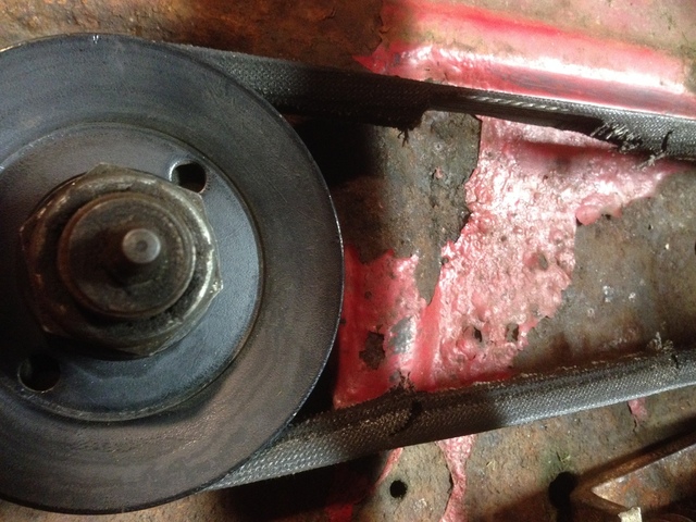

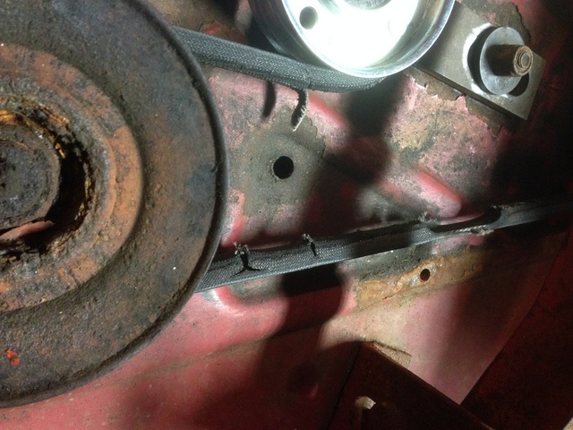

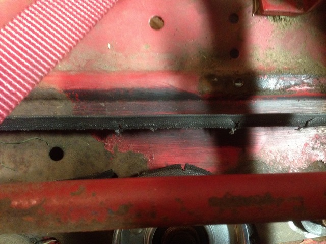

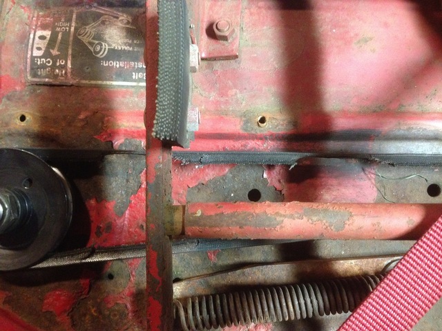

formariz 12,381 #1 Posted January 5, 2016 This is the third belt this last year on this deck. I have changed one pulley and the idler. The other two pulleys have nothing on them that would cause this. The same thing happen to first belt in beginning of season before I made any changes. After changes same thing is happening to belts. They all look exactly the same. Everything is aligned, and turn freely. Just driving me nuts. Any ideas as to what is causing it? Share this post Link to post Share on other sites

formariz 12,381 #7 Posted January 5, 2016 If one looks close to the areas where a section is missing, and there are about 8 or so in the whole belt, one notices that they are about all the same length and have polished round ends and a polished bottom. It almost looks as if belt stopped and blades kept turning ,therefor pulley burning the belt in that area. I just don't see how that could happen. As it is being used it cuts perfectly without any obvious noises or smells. 1 Share this post Link to post Share on other sites

WNYPCRepair 1,924 #11 Posted January 5, 2016 43 minutes ago, cheesegrader said: From the look of your belts, I wonder if your drive pulley is spinning on a belt that is not moving. Check you spindles/bearings. One (or more) of them may be shot, causing the belt to stop. I'm thinking one is randomly seizing, then starting to turn again, but you would think the belt would smoke. 38 minutes ago, formariz said: If one looks close to the areas where a section is missing, and there are about 8 or so in the whole belt, one notices that they are about all the same length and have polished round ends and a polished bottom. It almost looks as if belt stopped and blades kept turning ,therefor pulley burning the belt in that area. I just don't see how that could happen. As it is being used it cuts perfectly without any obvious noises or smells. My original thought was something was slicing them, due to the small cuts that seem to match the edges of the missing parts. Do the belts look melted, burned, etc? Share this post Link to post Share on other sites
WHX?? 58,307 #12 Posted January 5, 2016 Does the belt feel hot to the touch after cutting? Could a spindle bearing be getting tight after some run time. Could be tensioner not be releasing causing the PTO to be trying to engage the belt when it's not supposed to be? Just trying to cover all the bases here. I would find it unlikely that the blades would coast that much to wreck a belt in that short of time. I take it there are not blade brakes on your deck? Maybe you could walk beside it while someone is cutting to see if anything funky is going on Share this post Link to post Share on other sites
formariz 12,381 #13 Posted January 5, 2016 3 minutes ago, WNYPCRepair said: I'm thinking one is randomly seizing, then starting to turn again, but you would think the belt would smoke. My original thought was something was slicing them, due to the small cuts that seem to match the edges of the missing parts. Do the belts look melted, burned, etc? Only the missing areas look like the result of some kind of abrasion. Then you have all of these strange "cracks". 1 Share this post Link to post Share on other sites
