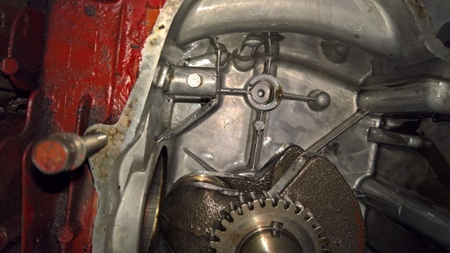

305 381 #12 Posted January 4, 2016 (edited) i'm surprised that the connecting rod did not crack the block when it broke......take a close look at the block , especially the area right under the starter the connecting rod is Tecumseh part # 31380C. it is available from Primeline as part # 7-03867 a set of standard rings is Primeline 7-03726 , a gasket set is 7-02823 you can get Primeline parts right from Napa or O'reilly auto parts Edited January 4, 2016 by 305 1 Share this post Link to post Share on other sites

dtallent 6 #14 Posted January 4, 2016 (edited) it does have a crack near the starter . I found an H60 shortblock off an ariens snow blower, I don't know the model # as its not posted, but should it work as a replacement? Or would I be better off going a different direction? Also this happened Edited January 4, 2016 by dtallent Share this post Link to post Share on other sites
305 381 #15 Posted January 4, 2016 you should be able to make it work , transfer everything that is different from the old motor to the new motor what size is the crankshaft PTO on the snowblower motor? 3/4" or 1"? your old motor was 1"..... adapter sleeves are available if needed is the snowblower motor set up for electric start? is the block drilled and tapped to mount the starter? i actually have a snowblower motor on mine Share this post Link to post Share on other sites

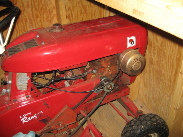

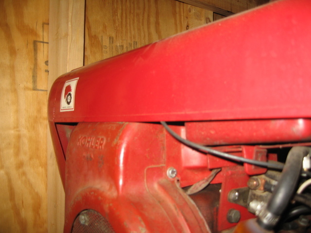

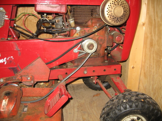

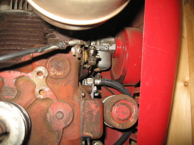

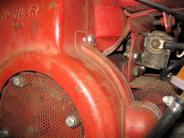

Shynon 7,728 #19 Posted January 5, 2016 5 hours ago, dtallent said: What about just sticking a completely different engine on it I just put an 8hp kohler electric start on mine, glad I made the switch. I had to use a smaller motorcycle battery and modify the gas tank support to fit. I don't think I have any pics and it is tucked away in the shed for a long winters nap. 1 Share this post Link to post Share on other sites

RedRanger 1,470 #21 Posted January 7, 2016 On 1/5/2016 at 6:55 PM, Shynon said: I just put an 8hp kohler electric start on mine, glad I made the switch. I had to use a smaller motorcycle battery and modify the gas tank support to fit. I don't think I have any pics and it is tucked away in the shed for a long winters nap. I'd like to see that! Pics! Share this post Link to post Share on other sites

Shynon 7,728 #23 Posted January 7, 2016 10 hours ago, RedRanger said: I'd like to see that! Pics! Best pictures I could get buried in the shed. 2 Share this post Link to post Share on other sites
RedRanger 1,470 #24 Posted January 8, 2016 1 hour ago, Shynon said: Best pictures I could get buried in the shed. Man I like that! Great photos too! Super detailed and clear. What a snug fit with the gas tank! How do you check the oil? Looks like it would be difficult to remove the oil stick? Share this post Link to post Share on other sites
Shynon 7,728 #25 Posted January 8, 2016 dipstick is flexible, I actually check it without removing the hood. 2 Share this post Link to post Share on other sites
