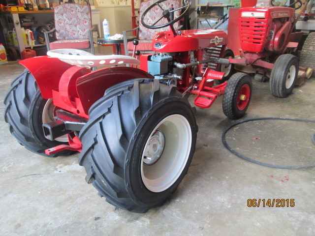

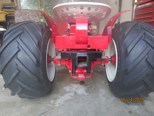

tallen4392 71 #13 Posted January 5, 2016 I have a 42 inch rd deck on it do you think 10.50 ag tires will rub or am i better off with 8.50 ?? Thanks again folks Does anyone have any pics with the larger tire on there machine ? Share this post Link to post Share on other sites
TDF5G 2,074 #14 Posted January 5, 2016 (edited) Here is a pic of my B-80 (long frame) with 23 X 8.50 AGs. It's a 36 RD deck. I would think it would clear the 42 RD deck also. I don't have any mowers on any of my tractors now or I'd get a better pic and measure the clearance. Edited January 5, 2016 by TDF5G 1 Share this post Link to post Share on other sites

tallen4392 71 #16 Posted January 5, 2016 thans for the pic what brand tire is that ?? That is what i was looking at deestone tires the price is right Share this post Link to post Share on other sites
TDF5G 2,074 #17 Posted January 5, 2016 Mine are Carlisle. Share this post Link to post Share on other sites

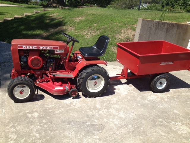

scotty 252 #18 Posted January 5, 2016 These are bkt not a great pic but gives an idea of 23-8.50-12 1 Share this post Link to post Share on other sites
