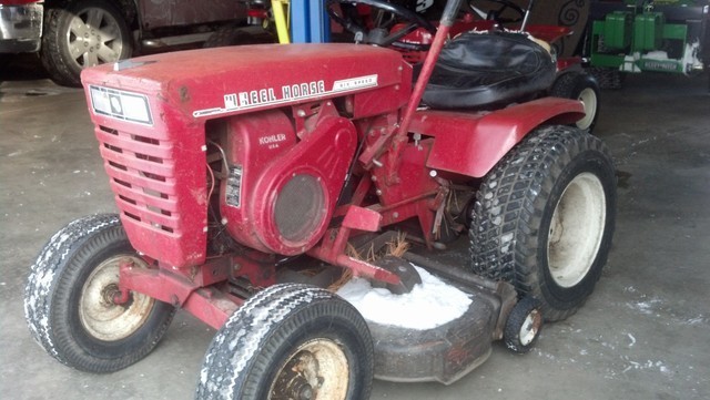

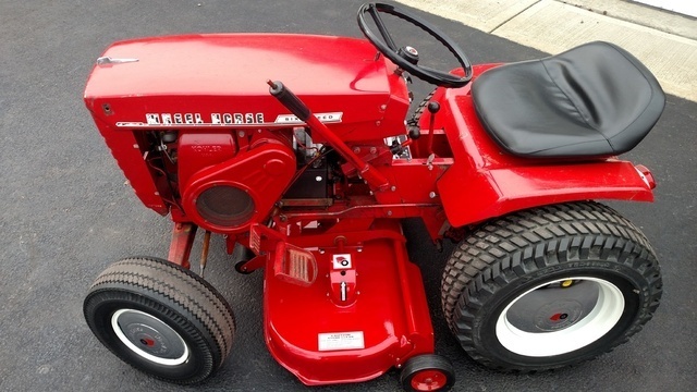

RedRanger 1,470 #7 Posted January 5, 2016 Any pictures of it now? Sometimes a good cleaning and polish will look better than repaint. Before After 12 Share this post Link to post Share on other sites
roadapples 6,987 #8 Posted January 5, 2016 RedRanger, can we ask what you used on the paint. That is quite a difference, looks great 4 Share this post Link to post Share on other sites
RedRanger 1,470 #9 Posted January 5, 2016 (edited) 1 hour ago, roadapples said: RedRanger, can we ask what you used on the paint. That is quite a difference, looks great I'll have to check later for the name of the buffing product, but basically I: 1. Degreased and powerwashed. (Be careful because the powerwasher took off some of the black print on the decals as well as blew off the decal for the seat lock) The black color on the decals is delicate. 2. The wheels were broke down and powder coated. 3. The deck obviously was rebuilt and painted. 4. The tractor itself was only cleaned, degreased, and buffed. (in addition to mechanical repairs) There is still good paint under those faded red tractors. That old paint was a lot more durable than what is used now. All you have to do is get the oxidation off. Edited January 5, 2016 by RedRanger 6 Share this post Link to post Share on other sites

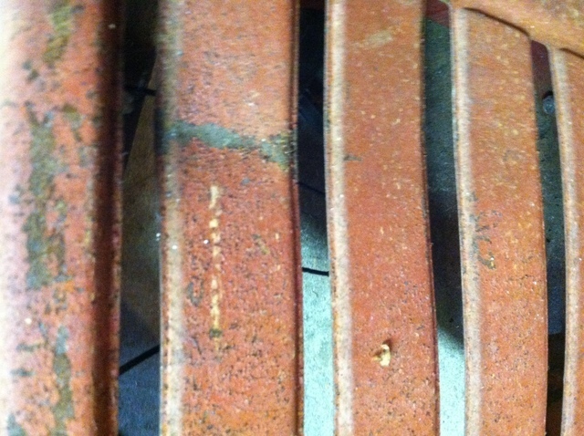

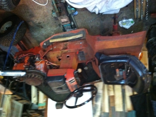

russellmc301 601 #15 Posted January 10, 2016 (edited) heres some pictures of her she is a rusty girl now but is to change. the one rim is drying now. and idk how to flip a pic so sorry for the upside down picture Edited January 10, 2016 by russellmc301 Share this post Link to post Share on other sites
953 nut 70,078 #16 Posted January 11, 2016 A little time and effort and it will look like new. Share this post Link to post Share on other sites
