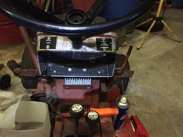

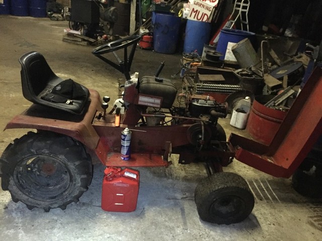

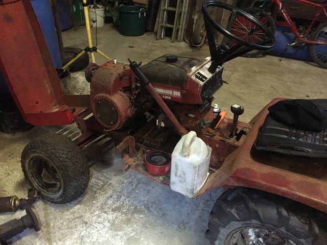

stevasaurus 23,456 #2 Posted January 3, 2016 Welcome to Red Square This is going to get interesting. What we really need is a vin sheet for the tractors that were made in the Belgium factory. We may have one on the site, but I can't seem to find it. What happened in the states is not always what happened in Belgium. For instance, your model # 1-0141 would be a B-80 made in 1975 here. Your engine is right for that, but you have an 8 speed transmission there, where here it would have a 4 speed #5084 transmission. In the states, the last Commando was 1972...model #1-0110...same engine you have with an 8 speed transmission #5085. That is what happens between the states and Belgium. We think it has something to do with parts availability for the most part. You have, for sure, a Commando 800 made in Belgium, if I had to venture a guess on the year...1975 Don't worry, someone here has a list of the model numbers produced in Belgium and I hope they will hop in here. That looks like a nice tractor, and you will love that K181S with the 8 speed trany. Pictures...get a Photobucket account, upload your pictures there...then click on the IMG code, click copy and then come into your thread and click paste. They will be right side up then. Have fun . I managed to turn your pictures right side up. WOW!! just caught a good look at that steering wheel...don't think I have ever seen one like that. 4 Share this post Link to post Share on other sites

stevasaurus 23,456 #7 Posted January 3, 2016 Funny, you should say that about the transmission. It was bothering me that something did not look right how the 2 shifters come through the sheet metal...I was going to ask you for some more pictures of that and the trans. Specifically, how those shifters come through the sheet metal and ...take a look at the left side of the transmission. Does the brake shaft come out the hole just in front the axle, or the next hole towards the front of the trans. Take a shot of the trans from behind the axle also...showing the fill plug on the left side. Do you think you could measure the axle diameter across one of the hubs. It is either 1" or 1 1/8". 1 Share this post Link to post Share on other sites
C-101plowerpower 1,606 #8 Posted January 3, 2016 now you say that steve, those shifters dont look right coming out there 1 Share this post Link to post Share on other sites
stevasaurus 23,456 #9 Posted January 3, 2016 What are you thinking Koen...he's got some sort of a gear reduction thingy going on?? Share this post Link to post Share on other sites
C-101plowerpower 1,606 #10 Posted January 3, 2016 (edited) 4 minutes ago, stevasaurus said: What are you thinking Koen...he's got some sort of a gear reduction thingy going on?? nah just an 8spd with a 4spd shifterplate, they might have bend the high low shifter also i do spot another wh trans on pic 2 and 3 Edited January 3, 2016 by C-101plowerpower 1 Share this post Link to post Share on other sites
