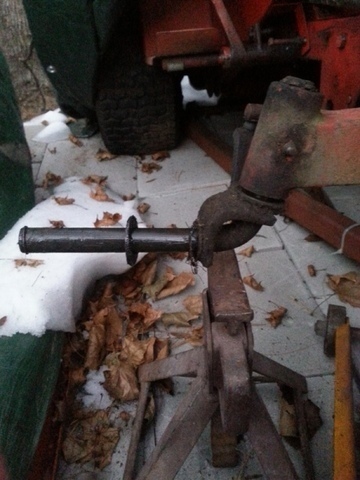

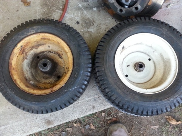

midpack 1,148 #1 Posted January 3, 2016 When I was putting the chains on my front tires I found a broken wheel bearing. Since I have 2 C-175 I figured I could scavenge a bearing until I could get a new one. except the other wheels had bigger bearings... both machines are the same year, one's a hydro and the other is an 8 speed. The 8 speed has the bigger bearings. Why would they have 2 different sizes? Share this post Link to post Share on other sites
