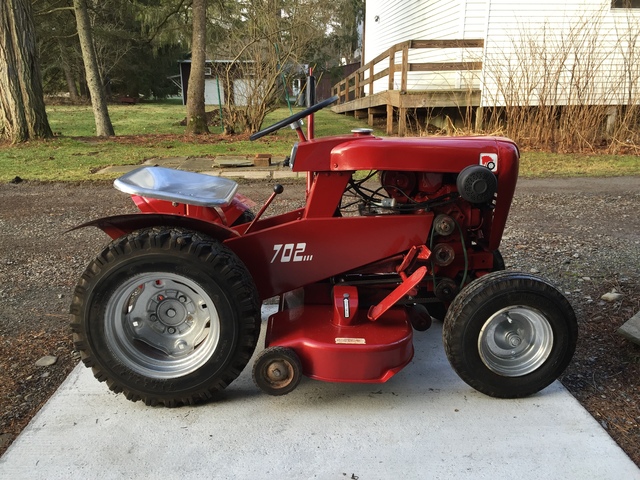

Regal_Red 103 #1 Posted January 2, 2016 Hi everyone! I have my grandfather's Wheel Horse from the early 1960s. We think it's a 702 (he put the 702 graphics on it as a best guess), but aren't really sure. It has a 7hp Kohler 161, 3-speed with reverse, and a round top. I am hoping to identify the true model and year. My husband, with the help of friends, got it running and refurbished as much as they knew as a gift to me for Christmas. I am hoping this knowledgeable group can help us the rest of the way. I can add more pictures. I just dont have them on me right now. Thank you in advance for any help you can give. Happy New Year! It has an electric start as well. 7 Share this post Link to post Share on other sites
stevasaurus 23,884 #2 Posted January 2, 2016 It sure looks like a 702 to me. One piece gas tank, square seat pan, correct engine, gas cap, muffler, shifter all look right. The foot rests are not correct though, those are from a couple year earlier horse. The correct ones have a "D" shape. That is a very nice 702. The serial number would be on the top of the tower under the dash plate. Should be like 62-XXXX. Knurled. thumb screws (3) would be what fastens the hood to the tractor, if you are really looking for that Round Hood look. BTW...WELCOME TO RED SQUARE. This is a 502, but it is the best picture I had of the "D" foot rests... 3 Share this post Link to post Share on other sites
KC9KAS 4,746 #3 Posted January 2, 2016 and thanks for the photo! 1 Share this post Link to post Share on other sites
Racinbob 13,286 #4 Posted January 2, 2016 I'm thinking like Steve. It is a 702. As he mentioned the footrests are 1961 but that was a common swap. The 701 didn't have slots in the hood. The 702 did as yours does but, of course the hoods are interchangable. The 63's still used the one piece tank but the front axle was different. We can't see that. That number would confirm things but if you have the correct front axle I'd say that's enough evidence. 3 Share this post Link to post Share on other sites
Sparky-(Admin) 26,688 #5 Posted January 2, 2016 I agree that the footrests are what a 701 came with...but also the flat faced drivebelt guard is what a 701 used. The indent for the model# decal wasn't introduced till 1962. How about a pic of the engine? Does it have one belt from the starter/gen or two belts? Mike.......... 3 Share this post Link to post Share on other sites

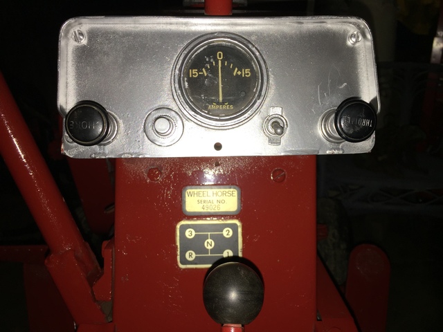

Regal_Red 103 #6 Posted January 3, 2016 You guys are so great!! Here are a couple pics of the dash and the engine that I have. I think it also shows the front axel. It does sound like we have elements of both models. Perhaps it was a 701 with some 702 additions? This is a very special tractor for me. It really doesn't matter, but it is so great to know more than just the meaning for me. 3 Share this post Link to post Share on other sites
stevasaurus 23,884 #7 Posted January 3, 2016 Good call Sparky, I saw the lack of indent on the guard...so we need some more pictures. One of the front axle, one of the engine and starter where the fan belts are. If you really want to go for it...to see if it is a 701 or a 702...check out the fill and drain plugs on the transmission. See if the are the same thread size or not. If one is a 1/4" pipe thread and the other is a 3/8", that is a 701 transmission (if original).......if they are both 3/8' pipe thread, that is a 702 transmission (if original). OH OH, look at that serial number...that is not from a 702. Check those trans plugs if you would, and pics of the front axle, and the fan belt thingy. That should do it. Hey sparky, did the 701 have the square seat pan?? 3 Share this post Link to post Share on other sites
Sparky-(Admin) 26,688 #8 Posted January 3, 2016 15 minutes ago, stevasaurus said: Hey sparky, did the 701 have the square seat pan?? Not sure about the seat...I've seen pics of both 701 and 702's with both types of seats. Mike.... 3 Share this post Link to post Share on other sites
stevasaurus 23,884 #9 Posted January 3, 2016 That serial number fits right in with Gerry's collection...it is a 701...check this out. Personally, I still want to know about those drain and fill plugs on the trans...please. The fill plug is on the left side of the trans by the axle, the drain plug is on the bottom toward the back. Looking at the manual, it shows a square seat and cushion for the 701, and the round seat with 13 holes on the 401. Thinking you may have had a choice. I don't know. http://www.wheelhorseforum.com/files/file/5170-tractor-1961-serial-numbers/ 3 Share this post Link to post Share on other sites

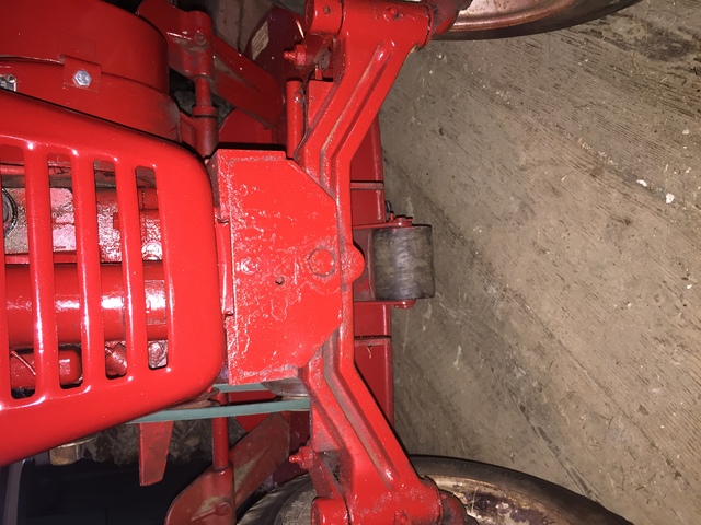

Regal_Red 103 #13 Posted January 3, 2016 Hello all! I hope you have had a good day. I had to go in to work for a while today so that tomorrow wouldn't be as stressful. . We took a photo of the front axel and I have included it here. My garage door was frozen shut so we couldn't roll it out to get underneath easily to check the drain sizes. There is only one belt on the side where the cover is. My husband wasn't so I to removing the hood to get to the other parts when it is in the upper 20s here. I can't blame him really. I will ask the guys who worked on getting the engine up and running for me tomorrow. I'll bet they will know. I wasn't able to locate the manual when I was looking on my phone last night. I will try to find it on my laptop. It looks like it is a 701 based on the serial number with a 702 hood. 1 Share this post Link to post Share on other sites

stevasaurus 23,884 #17 Posted January 4, 2016 I agree Mike...that is the wider belt cover for the belts. Gotta be a 701. Isn't there something about the shape of that front plate on the frame also?? 1 Share this post Link to post Share on other sites
Racinbob 13,286 #18 Posted January 4, 2016 There could be a difference Steve. The 701 and 702 frames have different part numbers. How does it compare to your 702? I sure wish I would have taken detailed pictures of the 701 I delivered to the big show last year. Share this post Link to post Share on other sites
Regal_Red 103 #19 Posted January 4, 2016 (edited) Confirmed!! There are two pulleys under the cover. What is the second pulley for? It works with just the one. What were your thoughts on the photo with the front axel? Do you think we are confirmed as a 701 with a 702 hood? Can't wait to hear what you think! Edited January 4, 2016 by Regal_Red Spelling 1 Share this post Link to post Share on other sites
Racinbob 13,286 #20 Posted January 4, 2016 (edited) They probably just figured two belts were better. It only happened one year. The front axle is correct. I think you're right. A 701 with a later hood. No harm really. I was a kid in the early 60's but the Wheel Horse bug already had me. So many items were changed out over the years that it's impossible to know what was truly factory. Also, Wheel Horse was well known for using up parts and muddying up things more. Parts on these machines are so interchangeable over many, many years that Johnny Cash specials are very common. You've got a great little tractor there and about as correct as you'll find. Edited January 4, 2016 by Racinbob 3 Share this post Link to post Share on other sites
