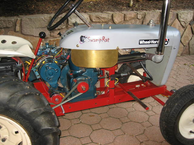

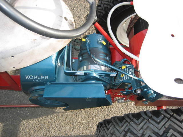

AMC RULES 37,261 #2 Posted January 2, 2016 (edited) I know on occasion, I've seen electric start K91's show up on ebay... so, if you're patient, they are out there...but not cheap. I remember two seperate members here, fireman, and formariz who have both completed these conversions in the past. You can check out Jeff's (fireman) tractor here... ...and Cas'(formariz)conversion here. Good luck with your endeavor. Edited January 2, 2016 by AMC RULES 1 Share this post Link to post Share on other sites

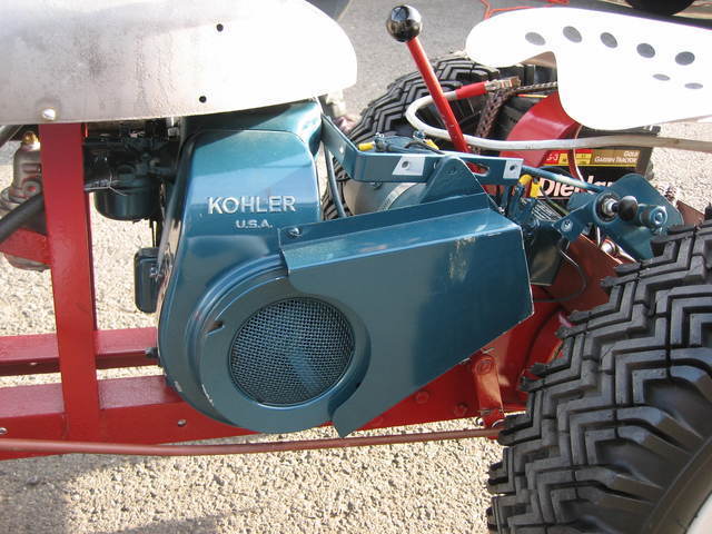

AMC RULES 37,261 #4 Posted January 2, 2016 I don't know...pretty sure it'll fit... here is KenB's roundhood he successfully stuffed an 8hp Kohler into. 1 Share this post Link to post Share on other sites

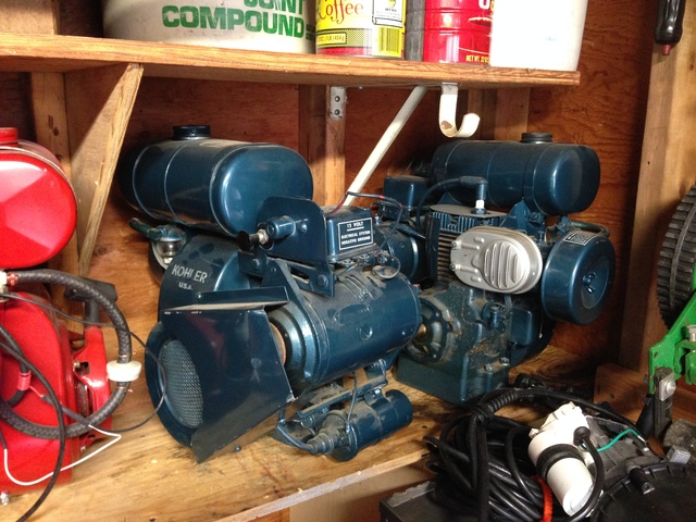

formariz 12,381 #9 Posted January 2, 2016 Some of my personal stash, never fired yet. 2 Share this post Link to post Share on other sites

formariz 12,381 #13 Posted January 3, 2016 On 1/1/2016 at 6:16 PM, 69chargerv8 said: My daughter and I have been doing some thinking on the 1960 suburban restoration. We have a really nice running k91 that is original to the tractor but she wants electric start. We are not to concerned about keeping original. Can the k91 be converted to an electric start or is there a small electric start engine available that would fit without hacking the hood? The easiest (not so easy)would be to find an H55 from a 551. it will fit in its designated spot without modifications. You would only have to make provisions for the battery if your does not have it and redo all of the wiring.Belt guard stays the same. Aside from that one , I think anything else is going to take a bit of work such as re drilling the frame , coming up with the right size belt, and perhaps a new belt guard. If you are lucky to find the K91S it will fit doing basically what I just described above. Very critical to achieve correct location so you do not have to modify gear shift lever. Jeff did some very nice and clever work on his with the shift lever and hiding all the electrical components. On mine I was able to leave all engine components on engine by merely moving things around a little.I wanted it only to be reliable and easy to do without too many modifications. You can definitely convert yours to a battery ignition using a starter generator. Not too much to it and a lot easier than finding the costly and elusive K91S. I am however very partial to a K91S. Sometimes it just seems all you need to do is to think "start". It always fires immediately, it barely turns over. 3 Share this post Link to post Share on other sites
