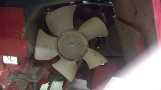

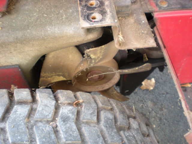

oe espo 32 #1 Posted December 31, 2015 (edited) I have a problem. tearing apart a 314H Eaton 1100 to clean up the trans fin. looked at my 520 also been apart see pictures for differences. anyone know which way is right? Silver attachment bolt is the 520, the red (factory bolt/washer) is the 314H Edited December 31, 2015 by oe espo typo Share this post Link to post Share on other sites
varosd 1,185 #2 Posted December 31, 2015 picture # 2 is correct 1 Share this post Link to post Share on other sites

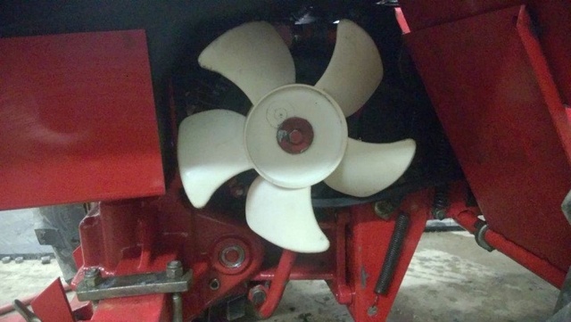

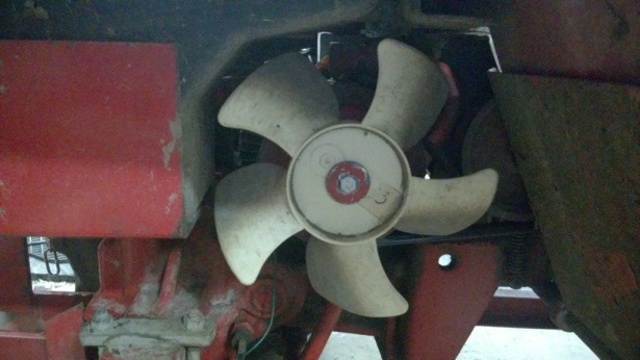

oe espo 32 #3 Posted December 31, 2015 (edited) OK, cleaned, and made adjustments. So the following two should be correct. 520H 314H Edited December 31, 2015 by oe espo added text Share this post Link to post Share on other sites
shallowwatersailor 3,222 #4 Posted December 31, 2015 Just like Don said, the fan draws the air across the transmission. The hint is the leading edge on the fan in #2. Share this post Link to post Share on other sites
gwest_ca-(File Mod) 12,478 #5 Posted January 1, 2016 2 hours ago, oe espo said: OK, cleaned, and made adjustments. So the following two should be correct. 520H 314H Think you need to turn the fans over. Either way they blow the same direction but you are pushing the blades the way they are now. Garry Share this post Link to post Share on other sites
oe espo 32 #6 Posted January 1, 2016 Ok which way is it. Don and Garry are different the way I read it. Share this post Link to post Share on other sites

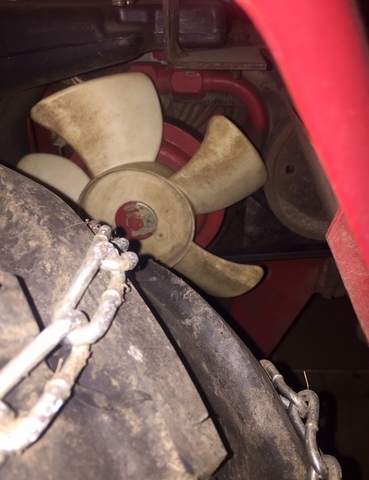

WNYPCRepair 1,924 #7 Posted January 1, 2016 3 hours ago, gwest_ca said: Think you need to turn the fans over. Either way they blow the same direction but you are pushing the blades the way they are now. Garry Mine is installed like this: 1 Share this post Link to post Share on other sites
shallowwatersailor 3,222 #8 Posted January 1, 2016 I believe that the fan turns clockwise as you look at it. The fan pulls the air across and exits against the tire. Share this post Link to post Share on other sites

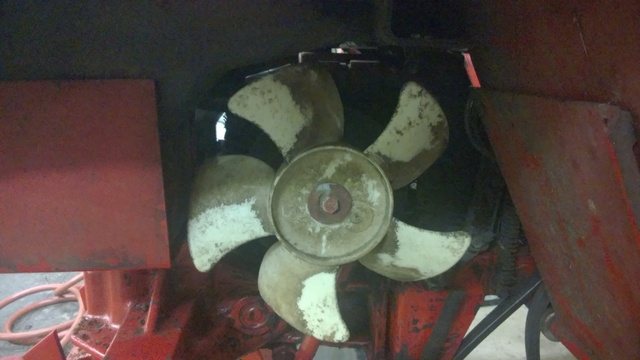

shallowwatersailor 3,222 #19 Posted January 3, 2016 Looking for another photo, I found this one. It is the 417A right after I picked it up this past summer. The tractor had been stored for 13 years and that is the original fan. 2 Share this post Link to post Share on other sites
rick 310 #20 Posted January 3, 2016 The fan on my 416H is mounted like the above. Share this post Link to post Share on other sites
