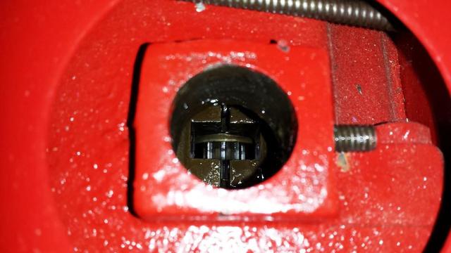

Racinbob 12,896 #2 Posted December 31, 2015 (edited) Easy peasy! First make sure the forks are in neutral. Stick it back in and adjust the dogpoint setscrew until you start to feel resistance as you shift through the gears then back off just a fuzz and tighten the locknut (not shown) while you hold the setscrew. Make sure the setscrew goes in the hole on the ring. Edited December 31, 2015 by Racinbob 2 Share this post Link to post Share on other sites

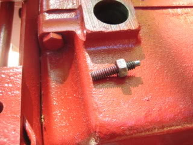

rmaynard 17,107 #7 Posted December 31, 2015 Here's a good picture of the hooby dooby 6 Share this post Link to post Share on other sites

stevasaurus 23,662 #9 Posted December 31, 2015 When Bob Maynard hops on the hooby dooby train, you know he is starting to feel better. That is good news. Seriously Paul...on the flip side, you need to see what you have there. Did the set screw point break off? Can you pull out what is there...by loosening the lock nut?? You can see what a dog point set screw looks like...let us know what you actually have there. 4 Share this post Link to post Share on other sites
