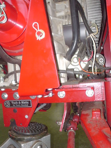

cleat 9,321 #6 Posted December 31, 2015 The first generation maroon 520's had the charge wire go right from the regulator down to the starter solenoid with a fuse close to the solenoid. That takes this load off of the 9 pin connector. I have all of mine wired this way including the 416 using a sealed fuse holder. May not solve all of the 520's electrical issues, but it does help. This picture shows the sealed fuse holder tied to the dipstick tube. It does get warm here but no issues so far (Wheel Horse did it this way in 88 and 89 with a less sealed fuse holder). Cleat 2 Share this post Link to post Share on other sites
