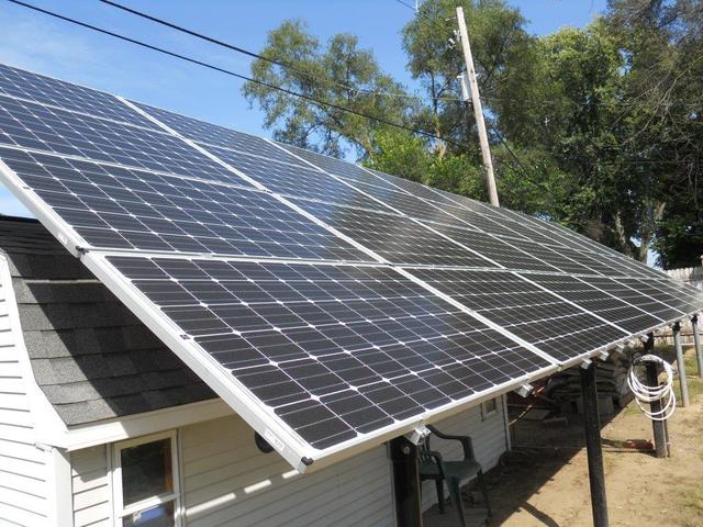

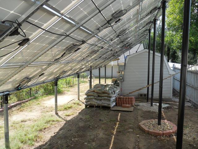

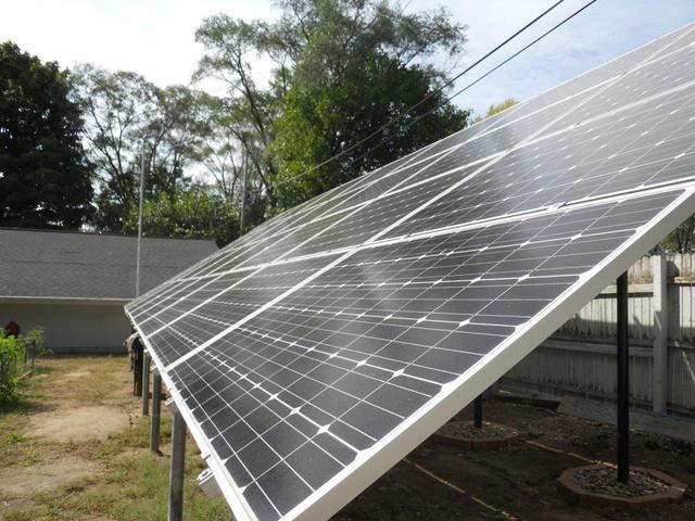

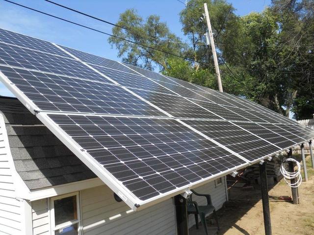

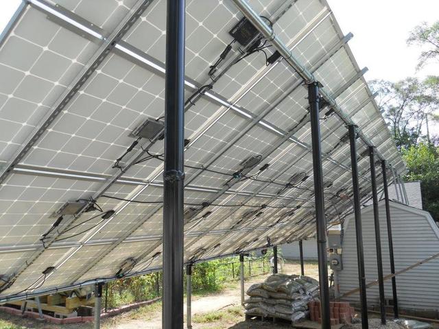

HorseFixer 2,014 #33 Posted September 17, 2016 Well here is the FINISHED product. I ordered 20 more now or a total of 32 and changed the Pitch on all of them to 32 Degrees which is the best all around for my location. The past 5 days I have purchased -0- zero electricity from the grid and have banked 40 KWh. life is good! 6 Share this post Link to post Share on other sites
roadapples 6,987 #34 Posted September 17, 2016 Nice job... At that rate, how long will it take to pay for itself? 3 Share this post Link to post Share on other sites

HorseFixer 2,014 #36 Posted September 17, 2016 1 hour ago, roadapples said: Nice job... At that rate, how long will it take to pay for itself? I use approx. $2500.00 in Electricity a year. Way more than the AVG Person but I have 18 Security Cameras rolling 24/7, My Wife's 3,000 gal Pond and waterfall that's running, Plus I weld and am in my Garage a Bunch So I use more than the Avg Guy. I have Spent a Total of $17,000.00 for this project. IRVING "R: SHYSTER is giving me a 30% Tax credit so I will get $5,100.00 Back so that leaves me a Bal of $11,900.00 So lets call it 12,000.00 / 2,500.00 <<< what I spend per year = 4.8 years Now if I have a surplus that will cut it even further because they will have to pay me for the Extra I make. I have done the Math and that's a 18-20% Return on my money. What Bank will give me that kinda return? on my $$$$ MONEY $$$$????? It's kinda a NO BRAINER. Besides what does an Ole Retired Guy have to do? 4 Share this post Link to post Share on other sites
