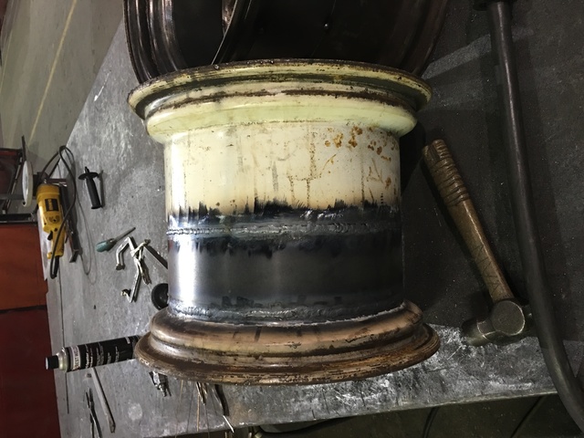

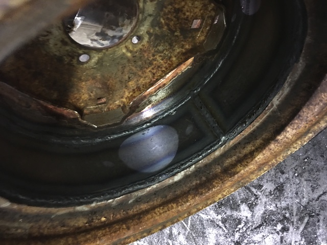

kingnothing71us 108 #44 Posted April 30, 2016 Well guys, I finally got the time to cut the rims and roll the strip of metal and get the rims back together. I have one rim completely welded, the other rim is just tacked together. I did TIG weld it back together, makes a stronger weld and less to grind. I plan on blending the welds, having the rims blasted and then paint them. I am aiming to make the rims look like they belong this wide with out any telltale signs of the addition of a strip of steel. The rims were 7 inches wide, they are now 10 inches wide. 6 Share this post Link to post Share on other sites
Digger 66 3,525 #45 Posted April 30, 2016 I'd just sandblast them & paint them . That leaves the "I-made-it" factor there . The quality workmanship speaks for itself . 2 Share this post Link to post Share on other sites
AMC RULES 37,254 #46 Posted April 30, 2016 Looks really good. Share this post Link to post Share on other sites

RedRanger 1,470 #49 Posted May 5, 2016 On 4/30/2016 at 4:20 AM, Digger 66 said: I'd just sandblast them & paint them . That leaves the "I-made-it" factor there . The quality workmanship speaks for itself . Leave them welds! Looking good! Share this post Link to post Share on other sites
