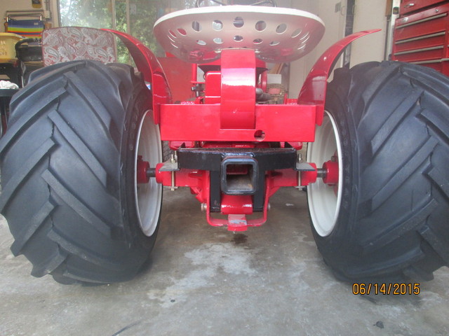

857 horse 2,588 #9 Posted December 21, 2015 Mr Mike.......For heath sake....I and We hope,,,your up to it and feeling better... your intrest in wider rims caught my ear...eye...both !!!! I have an old 401 with 10 inch wide rims...running a 23x10.50x12.....i will post a pic.... How ever,,,i have 2 857's running 24x12x12 tires in the rear....one set of rims are 12"wide,,,the other set is 13" wide..... nothing rubs....fits under the tractors...however when i am at the BIG SHOW,,,people crawl under the tractor to see what i have cut on the tractor to make the tires fit..... they just fit....and i found the rims,,from people that did pulling.....Merry Christmas... p.s. i know i didnt help a bit with your inqerie,,,,,i just like to talk.. llloolool 4 Share this post Link to post Share on other sites

kingnothing71us 108 #11 Posted December 21, 2015 Thanks apples & 857. 857, You did alot by posting that pic with the info because I was wondering about rubbing issues. Then again, I plan on cutting the rim in front of the center so the wider part will go towards the outside. 1 Share this post Link to post Share on other sites
