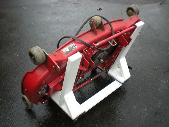

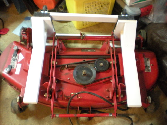

shallowwatersailor 3,216 #12 Posted December 20, 2015 I use Harbor Freight dollies that I add a frame of 1x6 and 2x4 lumber to hold the deck. This a 5xi 48" deck. I slip it on the dolly frame to the deck, and then lift up. 11 Share this post Link to post Share on other sites

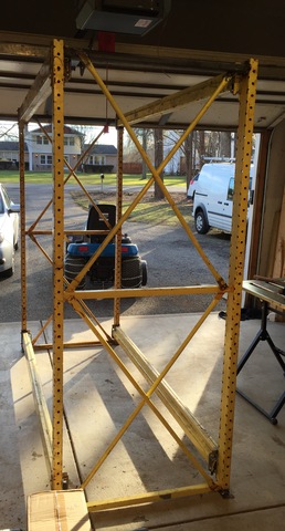

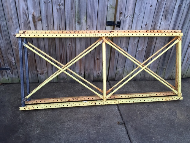

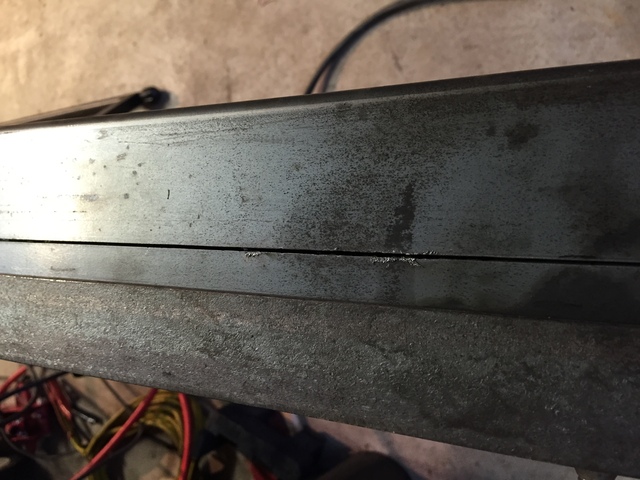

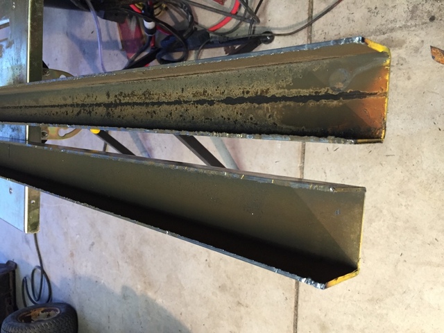

WNYPCRepair 1,923 #14 Posted December 23, 2015 (edited) Worked on the rack for deck storage today. Got the uprights cut out of the pallet racks and cross pieces welded back in and cross bracing re-welded, and the horizontal members cut down from 10' to 7' to fit in my garage. Picked up a huge load of steel for the lift mechanism. Hope to start assembling the rack tomorrow and welding the lift parts together. Needed a U channel for the 2" square lift members to slide in, but they don't make anything that works off the shelf. Finally found a square piece and split it down the middle with the plasma cutter. best $300 I ever spent. They have the plasma cutter on sale for $300 until 12/31, if anyone is interested. closeup of the plasma cut The resulting U channel The uprights with cross pieces welded back in Edited December 23, 2015 by WNYPCRepair 1 Share this post Link to post Share on other sites

WNYPCRepair 1,923 #18 Posted December 23, 2015 4 minutes ago, Tankman said: Sorry to hear 'bout the Ms., WNYPCRepair. Of course I was joking, deck storage is getting very difficult here too. If I build a rack, great ideas here, it'll be a two person lift fo' sure. Let all know any solution you might come up with. Need to hear. Oh, I knew you were joking. My skin is thick enough, anyway, LOL. If this works, it will be powered by some type of winch. I was looking at a hand cranked winch, sort of like a boat trailer winch, but I can't tell for sure if it has a braking system to lower the rack "shelves", so I may go with a 12v ATV winch. I am having trouble sleeping ever since I started buying these damn horses, I keep designing stuff in my head all night, LOL Share this post Link to post Share on other sites
doc724 925 #19 Posted December 23, 2015 John, I like your dolly idea. Pretty creative. Would have been useful for garage storage before I built the shed addition. With all the extra shed space, I store them all vertically against the wall and tie them off with rope. Share this post Link to post Share on other sites

WNYPCRepair 1,923 #21 Posted December 25, 2015 (edited) On December 23, 2015 at 8:24 AM, wrightorchid said: Have you designed the ultimate Barn yet? I have done a lot of thinking about it. I didn't get a lot accomplished today. Got some chores done, started to work, realized I was out of welding gas, so I ran out and grabbed a tank. Came back, welded the feet on the racks, and ran out of wire. Ran out again, grabbed some wire, and mounted the 2" x 2" bars ion top of the uprights. I had planned to weld the 2" x 2" tubes across the top , then another lengthwise to spread the weight of the hoist along the length of the rack. Then I realized if I did, I wouldn't be able to move it in the future, I would have to build it in place. I want to be able to move it in the future, so I am going to have to change the design. I assembled it today to see how sturdy it felt. I had planned to reinforce it with 1 1/2" angle iron, but it was as solid as a rock, it didn't sway even a fraction of an inch. I won't need nearly as much steel as I originally thought. I looked up the pallet racking specs last night, and I am good for a LOT of weight just as it stands. I saw a post where a guy made a gantry crane out of it and lifted a 2500 pound machine so they could back a trailer under it. I will still have five 7 foot tall sections to use as scaffolding, and it will probably be the sturdiest scaffolding I have ever used. When I saw how much steel they had on these racks at the steel store, I was a lot less worried about it being strong enough. Edited December 25, 2015 by WNYPCRepair Share this post Link to post Share on other sites
