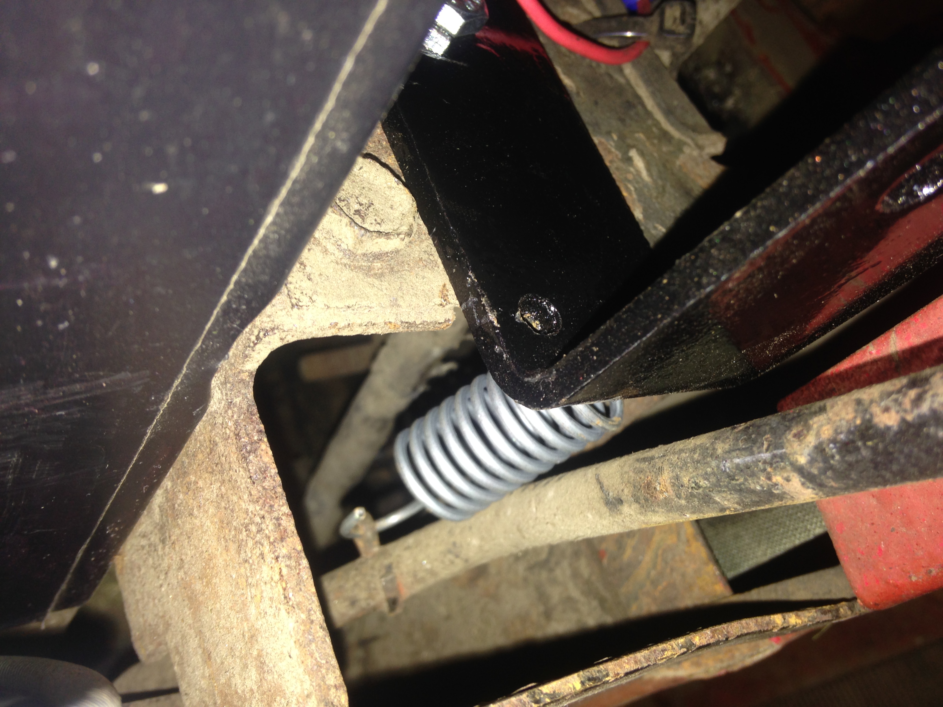

cooperlacy 3 #1 Posted December 19, 2015 Is this the correct position for the PTO return spring (PTO brake engagement)? When I got my '86 417-8 it didn't have any spring and I've been using it for years this way. The parts diagram isn't very clear and I haven't found any definitive pictures from my searching. I've attached it to the cotter pin that goes through the PTO rod and the other end to the bottom hole of the relay/belt guard bracket. I appear to be having trouble uploading the picture from my phone so will try to add that later. Thanks, Cooper Share this post Link to post Share on other sites
Racinbob 12,276 #2 Posted December 19, 2015 From what I can see in the picture you have it on correctly. Share this post Link to post Share on other sites

cleat 7,730 #4 Posted December 19, 2015 That is correct. Same spring as the parking brake return on hydro machines. Share this post Link to post Share on other sites
