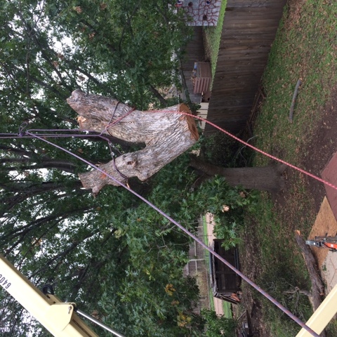

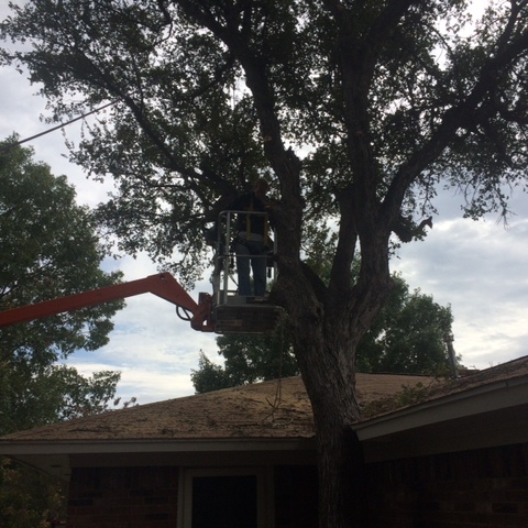

oliver2-44 10,940 #1 Posted December 17, 2015 My son purchased a house a back in July. Between work and helping him with some remodeling, etc it sure has take my up Horse time! There was a large Cedar Elm tree that had grown to the point that the trunk was actually rubbing the house. The tree trimming companies wanted +/- $2000 to remove it. So we rented a snorkel lift for $200 for the weekend (2 days). Since the tree was over the house we had to cut and lower it down piece by piece. It took us 2 full days and the lift sure was the worth every penny and was definitely the safe way to do it, (we only damaged 1 roof shingle! We saved the bottom trunk of the tree to dry and possible have sawn into a fireplace mantel . 5 Share this post Link to post Share on other sites

WNYPCRepair 1,923 #5 Posted December 18, 2015 Are you using the lift to lower those pieces down? Share this post Link to post Share on other sites
RedRanger 1,470 #6 Posted December 18, 2015 35 minutes ago, WNYPCRepair said: Are you using the lift to lower those pieces down? I was wondering the same thing. Share this post Link to post Share on other sites
oliver2-44 10,940 #7 Posted December 18, 2015 Yes we used the lift to lower pieces down. This was a 35 ft lift. When fully extended it had a 575 lb weight rating and a 1000 lb rating when not extended. We were able to park where al the outriggers were on the concrete patio to give us a solid base. Share this post Link to post Share on other sites
AMC RULES 37,225 #8 Posted December 18, 2015 So, this is where estimating the weight of the cut piece you're lowing down becomes critical. 1 Share this post Link to post Share on other sites
Ed Kennell 42,829 #9 Posted December 18, 2015 2 hours ago, AMC RULES said: So, this is where estimating the weight of the cut piece you're lowing down becomes critical. Glad you got the job done safely. I hope no one takes this as a negative comment on this post, But I feel obligated say this is not an operation I would recommend for anyone that does not have experience in rigging and the operation of a mobile crane. In my 40+ years of manufacturing hydro turbines where lifts in excess of 200 ton were made routinely, I have seen some very nasty accidents and the operators were all trained, experienced, certified operators. Just sayin....s@@@ happens especially when chain saws and suspended loads are involved. 3 Share this post Link to post Share on other sites
oliver2-44 10,940 #10 Posted December 18, 2015 You got that right AMC! Needless to say we started lifting smaller pieces and worked our way up learning what the lift could handle as we went along! Tying the pieces to the lift in a "balanced" fashion and having a tag line to minimize the swinging was also part of that lesson. When you made that last part of cut and the larger pieces separated from the tree you didn't want them swinging everywhere. On several of the larger pieces we made 3/4 of the cut from the lift with the chain saw, then took the lift above the piece the larger and tied it off and put a little "up" tension with the lift so we were "holding the piece up. Then we finished the last part of the cut with a long pole saw. What @ekennell says about the rigging is very true. Small world, I've spent 37 years maintaining and overhauling hydro turbines at our 6 dams. In the last 20 years we've done major rehab on all 13 turbines. Voith Hydro in York, Pa provided the new turbine runners and refurbished parts for us. I've been to York several times over the years. @ekennell do you happen to work for Voith, or American Hydro across town? 2 Share this post Link to post Share on other sites
