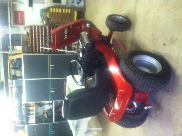

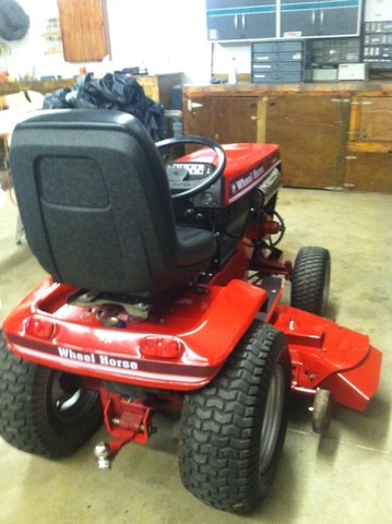

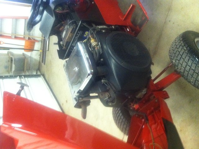

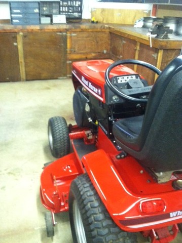

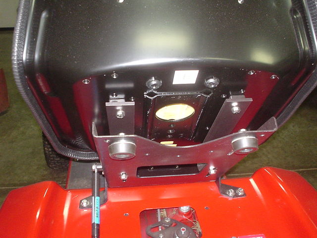

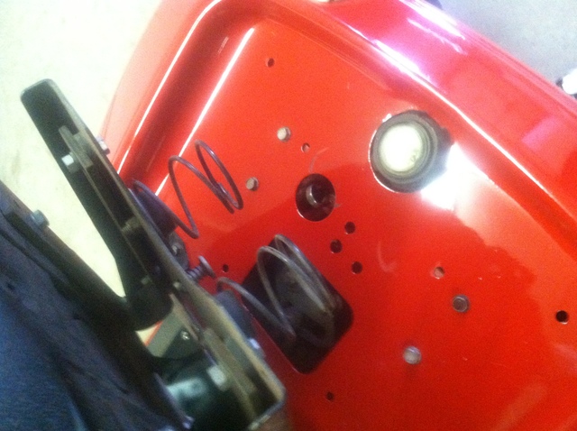

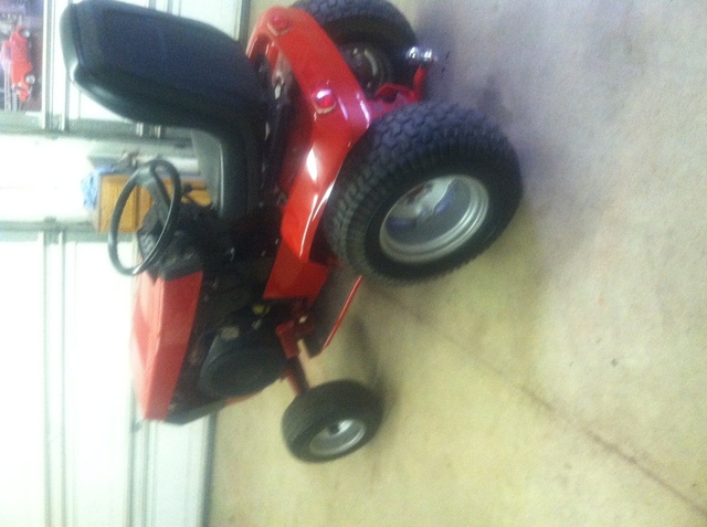

Smemsic 19 #1 Posted December 15, 2015 slowly starting to restore one of my 520's. found a great place on line for the decals ( redo your horse) but am not able to find the heavy clear sticker for under the seat springs. If any one out there knows of the part number or how to obtain would be great. Last year I went through the engine, had 800 hours on it so figured it was time. I attached a few shots after the initial paint work and new seat. Also yes.................a shot of my other toys..............I mean tools..............lol 10 Share this post Link to post Share on other sites
gwest_ca-(File Mod) 12,338 #2 Posted December 15, 2015 May be item 28 on this page https://www.partstree.com/parts/toro/mowers-lawn-garden-tractor/41-20oe02-520-h-toro-520-h-garden-tractor-sn-1000001-1999999-1991/decals/ There is an almost clear urethane tape used on the leading edge of aircraft wings that has been used on autos in areas subject to stone abrasion. Bet that product would work and often sold with auto body adhesive side moldings. Garry 1 Share this post Link to post Share on other sites
DougC 2,644 #3 Posted December 15, 2015 Great job! Beautiful 520H. I like that new seat, where'd ya get it??? Share this post Link to post Share on other sites
muz123 1,193 #4 Posted December 15, 2015 Very nice! Share this post Link to post Share on other sites
608KEB 829 #5 Posted December 16, 2015 Looks sweet! Gotta love the power!! Share this post Link to post Share on other sites
WNYPCRepair 1,924 #6 Posted December 16, 2015 Nice work! Share this post Link to post Share on other sites
Smemsic 19 #8 Posted December 16, 2015 Garry thanks for pointing out the sticker, lol should have seen it myself. The seat kept frustrating me cracking and holding water better than a spung, I got it at Tractor Supply Company, worked out great and helps my back so I put one on the 314-8 and other 520 Share this post Link to post Share on other sites
lynnmor 8,885 #9 Posted December 16, 2015 I threaded a piece of clear vinyl tubing on the first loop of the seat springs. That will help protect the paint or your new decal. The paint will still scuff, so I would do both. Share this post Link to post Share on other sites
cleat 9,003 #10 Posted December 16, 2015 I don't have the seat switches hooked up on mine so I removed the coil springs. I purchased new rubber bumpers though and installed rubber pads on the fender to protect the paint. This has been done to all of my 520's. Cleat 2 Share this post Link to post Share on other sites

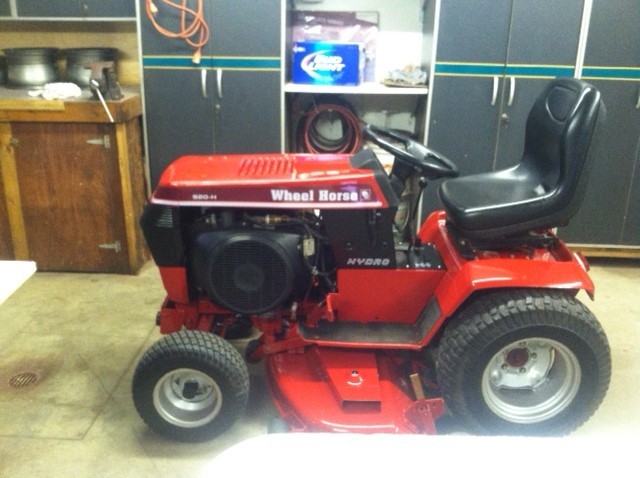

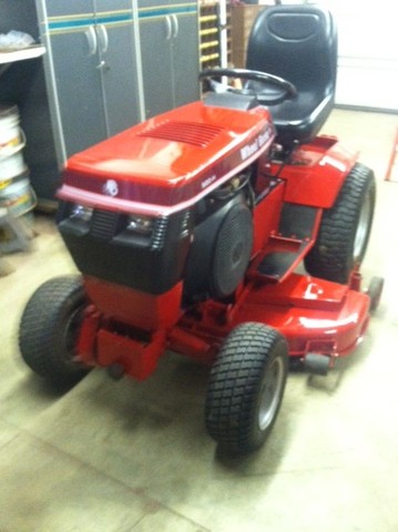

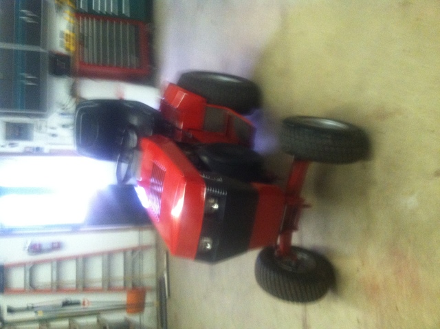

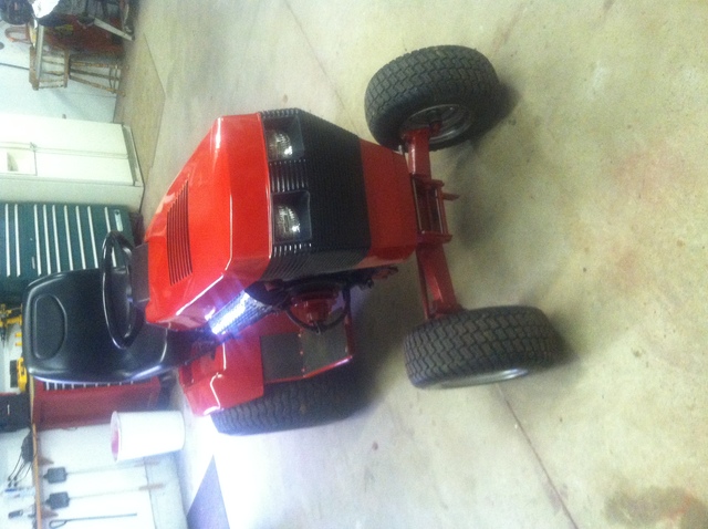

Smemsic 19 #15 Posted December 28, 2015 I have just about all of it done, still waiting on hand grip for mower deck but for most part it came out nice. LOL neighbor wants to know if its for sale 2 Share this post Link to post Share on other sites
HokieAg07 129 #16 Posted December 28, 2015 Looks great! Share this post Link to post Share on other sites

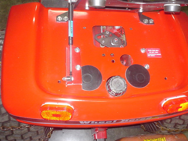

WHX?? 57,354 #17 Posted December 28, 2015 Very nice....Get four of these for the dash lights - won't be sorry https://www.superbrightleds.com/moreinfo/led-vehicle-replacement-bulbs/ba9s-led-bulb-4-led-ba9s-retrofit-car-classic-car-bulbs/6/58/ Yes very neat trick on the bumpers cleat, will have to do that to mine. Any good sources for the gas spring on the seat? Mine is shot and a real pain when gassing up. Toro must be quite proud of their's Share this post Link to post Share on other sites
cleat 9,003 #18 Posted December 28, 2015 Seat lift gas spring 114343 (Strong arm F4673) Here is one source http://shop.advanceautoparts.com/p/strong-arm-lift-support-f4673/19940007-P Cleat 2 Share this post Link to post Share on other sites
WHX?? 57,354 #19 Posted December 28, 2015 Holy schmidt cleat you just saved me 40 bucks at least...buy ya a 1 Share this post Link to post Share on other sites
cleat 9,003 #20 Posted December 28, 2015 I now have 4 of these on my machines and they work great. I can't take the credit though, I found it on this site a couple of years ago. Cleat Share this post Link to post Share on other sites
