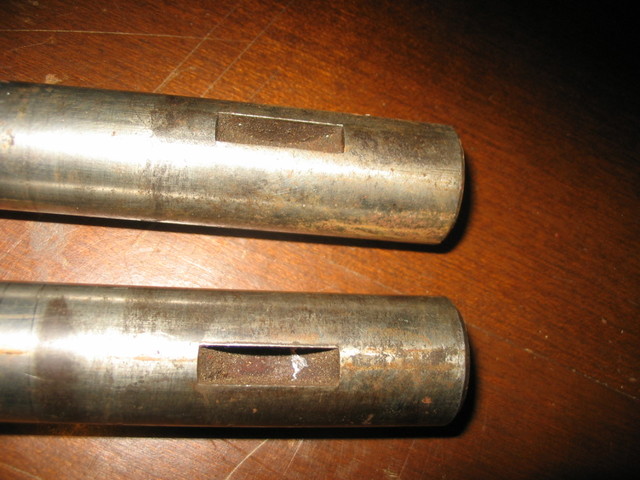

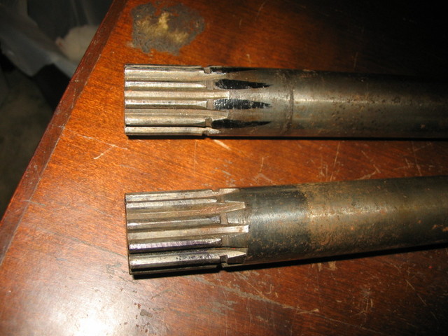

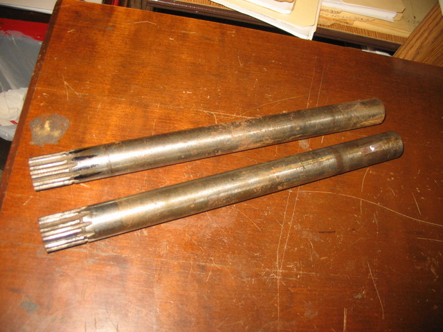

daveoman1966 3,884 #3 Posted December 12, 2015 I have a pair of 1" axles... 12" long that should suit your needs. The keyway slot is perfect and there are 11 splines on the gear end. Contact me at this email for further info: (Just clik the link) daveoman@windstream.net 1 Share this post Link to post Share on other sites

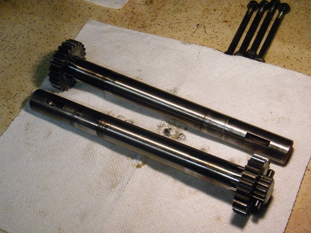

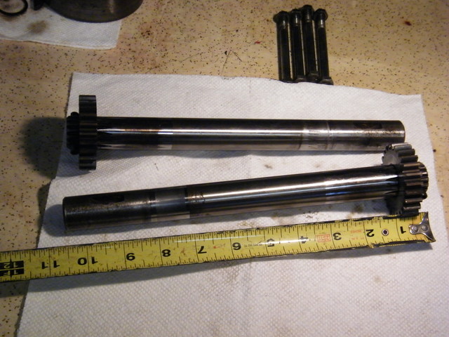

stevasaurus 23,816 #11 Posted December 13, 2015 pacrat...check out these pictures...these are the axles out of my 5025 uni-drive...10 5/8" long with 15 splines. I would think Mike would have these in his stock. The correct outer axle bearing for your 1" axles is WH 1528...crosses to Torrington or KOYO B-1616. The seal is TORO 100863...crosses to SKF 9815. If you look at Dave's picture...those are not the correct axles. The groove for the "C" clip is on the wrong end to the spline...should be about 1/4" from the end of the axle...and they are the wrong length. You do not need a new transmission...these parts are out there. Yes an 8 speed would bolt right on, although you may have a few issues to work out with the brake linkage. To clarify all this...your 312-8 came with both 1" and 1 1/8" axles. The TIPL shows both differentials reflecting this...Bob was seeing one part and lining up the other. Your transmission is 1" axles...that part # is 5961...the axles I have pictured are part # 3904...both are 10 5/8" long with 15 splines. Either one will work in your transmission...the difference is my #3904's use a 1/4" roll pin to hold on the axle gear. Your 5961 axles use a "C" clip to hold on the axle gear. That is why the different part number. The bearings and seal I listed above are correct for your 1" axle transmission. if you do not have this...here is the manual link for the 1987 312-8 with all the parts information. I'm going to edit my above statement...I was wrong about the #3904 and the #5961 axles being the same length. The #3904 is shorter by about 1". The #3904 is 10 5/8". The #5961 is either 11 1/2" or 11 5/8" 2 Share this post Link to post Share on other sites
Racinbob 13,117 #12 Posted December 13, 2015 Steve, the 3904's are shorter too. I'm sure they would work but it would basically butt the hubs to the transmission case. I would want to check gas tank clearance with chains on. 1 Share this post Link to post Share on other sites

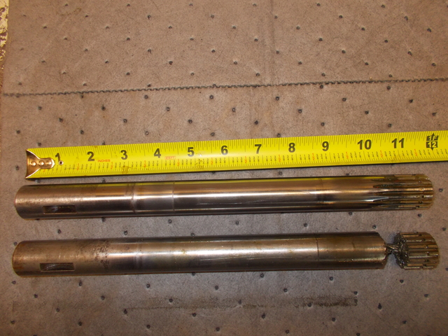

pacrat 2 #13 Posted December 14, 2015 Thanks. you both have been very helpful. the parts manual download was great. Here is a picture of my axles. Share this post Link to post Share on other sites
roadapples 6,987 #14 Posted December 14, 2015 Yea, that bottom one has definitely seen its better days. Do you know what caused this? Share this post Link to post Share on other sites
pacrat 2 #15 Posted December 14, 2015 i have used the tractor mainly for plowing snow. I purchased it used about 14 years ago. The past 2 winters have been brutal. It quit moving one day in the spring and I put it in the corner until i had time to repair it. It has been a good to me. 1 Share this post Link to post Share on other sites
953 nut 68,773 #16 Posted December 14, 2015 Is the differential case that the axle goes through OK? Must have been a broken bolt or something got lodged in there for a long time to do that kind of damage. Share this post Link to post Share on other sites
stevasaurus 23,816 #17 Posted December 14, 2015 Those look longer then 10 5/8"...forget what I said about my #5025 axles swapping in your tranny. They would fit, but your wheels and/or rims might hit fenders or gas tank. You need the #5961 axles. Sorry, don't know why I thought they were the same length. What is the length of those axles?? Share this post Link to post Share on other sites
