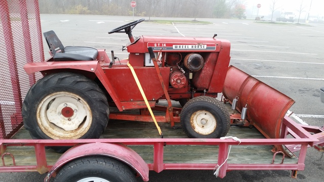

trowbri1 5 #1 Posted December 8, 2015 (edited) Update: I put the new starter in my gt14 and it started right up, however, the gear from the starter wouldn't release from the flywheel once it was started. I turned it off quick so I wouldnt burn up the starter. Any suggestions on how to fix this? Edited December 10, 2015 by trowbri1 Share this post Link to post Share on other sites

953 nut 66,628 #8 Posted December 10, 2015 On 12/8/2015 at 9:25 AM, trowbri1 said: Update: I put the new starter in my gt14 and it started right up, however, the gear from the starter wouldn't release from the flywheel once it was started. I turned it off quick so I wouldnt burn up the starter. Any suggestions on how to fix this? I am presuming the starter was tested off the engine and the starter drive worked satisfactorily. When you shut off the engine was the starter drive binding against the flywheel, if so you may have a bent mounting bracket and need to shim it to correct this. 1 Share this post Link to post Share on other sites
trowbri1 5 #9 Posted December 10, 2015 Yes to both of your questions. Any recommendations on thickness of the shim to start with? 1 Share this post Link to post Share on other sites
953 nut 66,628 #10 Posted December 10, 2015 It will be a bit of trial and error since we have no idea how far off it is, I would start by putting one washer on each bolt between the starter and the engine block and give it a try. Share this post Link to post Share on other sites
trowbri1 5 #11 Posted December 10, 2015 Thanks for your help. I'll let you know this weekend how it goes. Share this post Link to post Share on other sites
