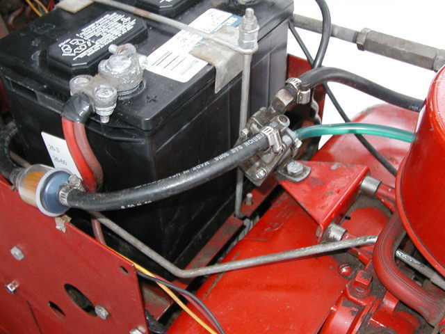

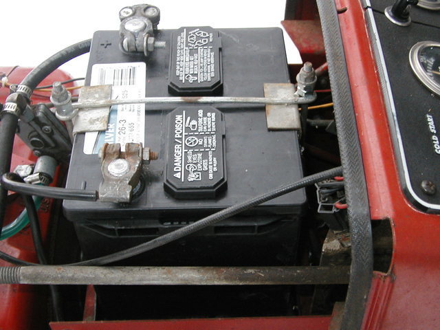

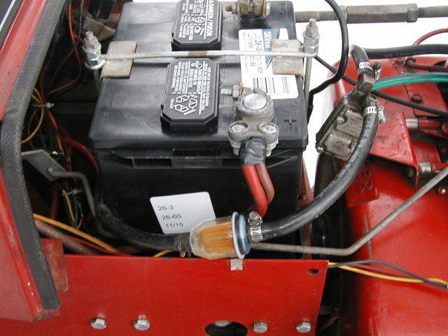

JackC 619 #2 Posted January 3, 2016 Group size 26 fits. A 1/2 to 3/4 inch taller battery would also work. I used 2 extra over sized nuts on each side as spacers. Front to back was a perfect fit with the battery hold down bracket and the battery could have been about 1/4 wider side to side. Bosch had a group size 26 with a 3 year free replacement warranty. Pep Boys carries Bosch but no longer carries that size. I went with the AutoCraft Silver from AdvanceAuto with a 2 year free replacement warranty. With their online 20% discount it came to $99.84 including tax. At 525 CCA it should be plenty of battery for the beast. The extra positive conductor goes to a a separate electrically operated hydraulic unit on the back of the tractor, Share this post Link to post Share on other sites
