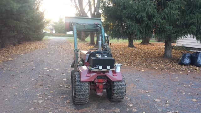

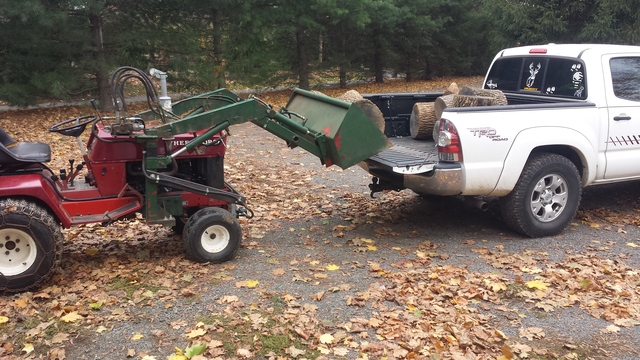

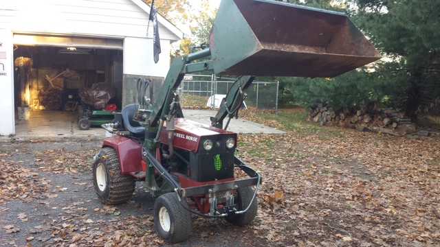

botzitaliano 37 #1 Posted December 3, 2015 Hey all few months back i picked up a FEL for my 76' D-250. I believe it was off a older bowlens tractor. Im running the loader off the pto with a northern tool 4-8 gpm pump, 5 gallon hydro tank, 3/8" hydraulic lines, 20gpm filter off return side of tank. I got it working, it lifts weight. But my issue with it, is that it lifts very slowly. When the pto is on and pumps running, the gauge on the inlet side of the valve body doesn't read anything until the pistons max out, then i belive it reads 2000psi. Friend of mine suggested upping the pump supply line from 3/8" to 3/4"?? My other concerns now are: does the pto spin fast enough to run the pump correctly? And is my 20gpm filter on the return slowing anything down?? If theres any advice yall could share with me to help improve my situation, ill really appreciate it. Thanks Tomorrow ill take a video of the loader running so you can gauge the speed 2 Share this post Link to post Share on other sites
