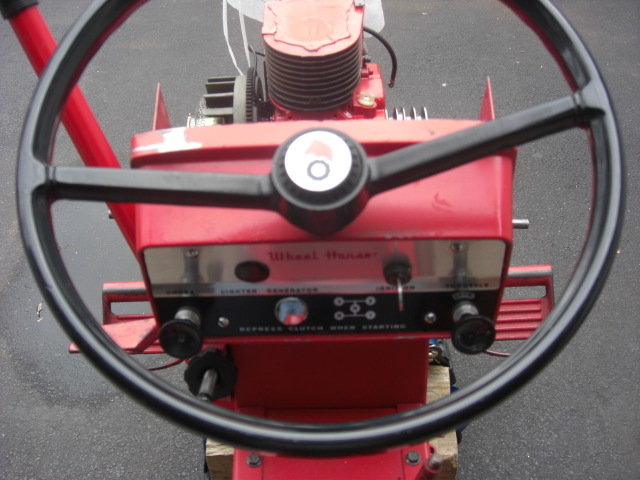

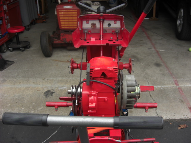

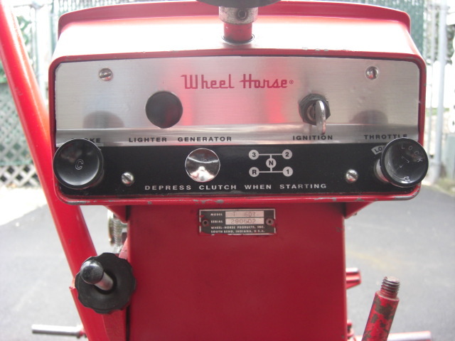

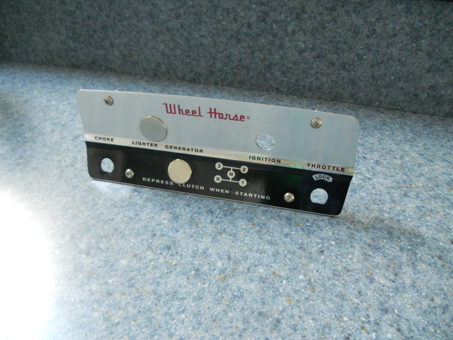

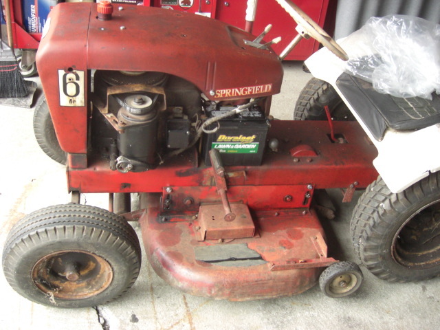

Retired Wrencher 6,362 #1 Posted November 30, 2015 Just thought I would pass on this info I am redoing the 607 that I have the dash needed a new decal from Terry. I noticed that one of the plug button was very rusty. I went to three hardware stores with no luck every one said ohh we don`t sell those anymore.. So you could not see it on brushed aluminum any way if new. So I painted it black. Good enough. I cut between the black and silver this is the best dash that I have done to date. Trying to do it in one shot is hard to line up and you get bubbles because of the one piece. I have done many of these. Also I have the deck on the old 1965 Springfield. Boy it makes you appreciate how well W/Horse is built compared to this tractor. Hope you enjoy the picks. Enjoy the ride. Gary B.... 8 Share this post Link to post Share on other sites

Retired Wrencher 6,362 #13 Posted December 1, 2015 (edited) 14 hours ago, Racinbob said: You did a great job on that Gary. I did mine a different way. I'll also be doing another one soon. Did you find that the decal is a bit oversize and needed trimming a bit after installed? Racinbob Yes it was over sized. I have an small exacto knife did a good job on the holes and the trimming. Just line it up. So how did you do yours? 14 hours ago, Mike_Eddleman said: I think the electrical plugs would work good. Home Depot, Lowes. By the way it looks great Mike I have been to H.D. already no go there. I guess I can try Lowes. Hard to get there = to much traffic. Edited December 1, 2015 by T1257 Share this post Link to post Share on other sites
