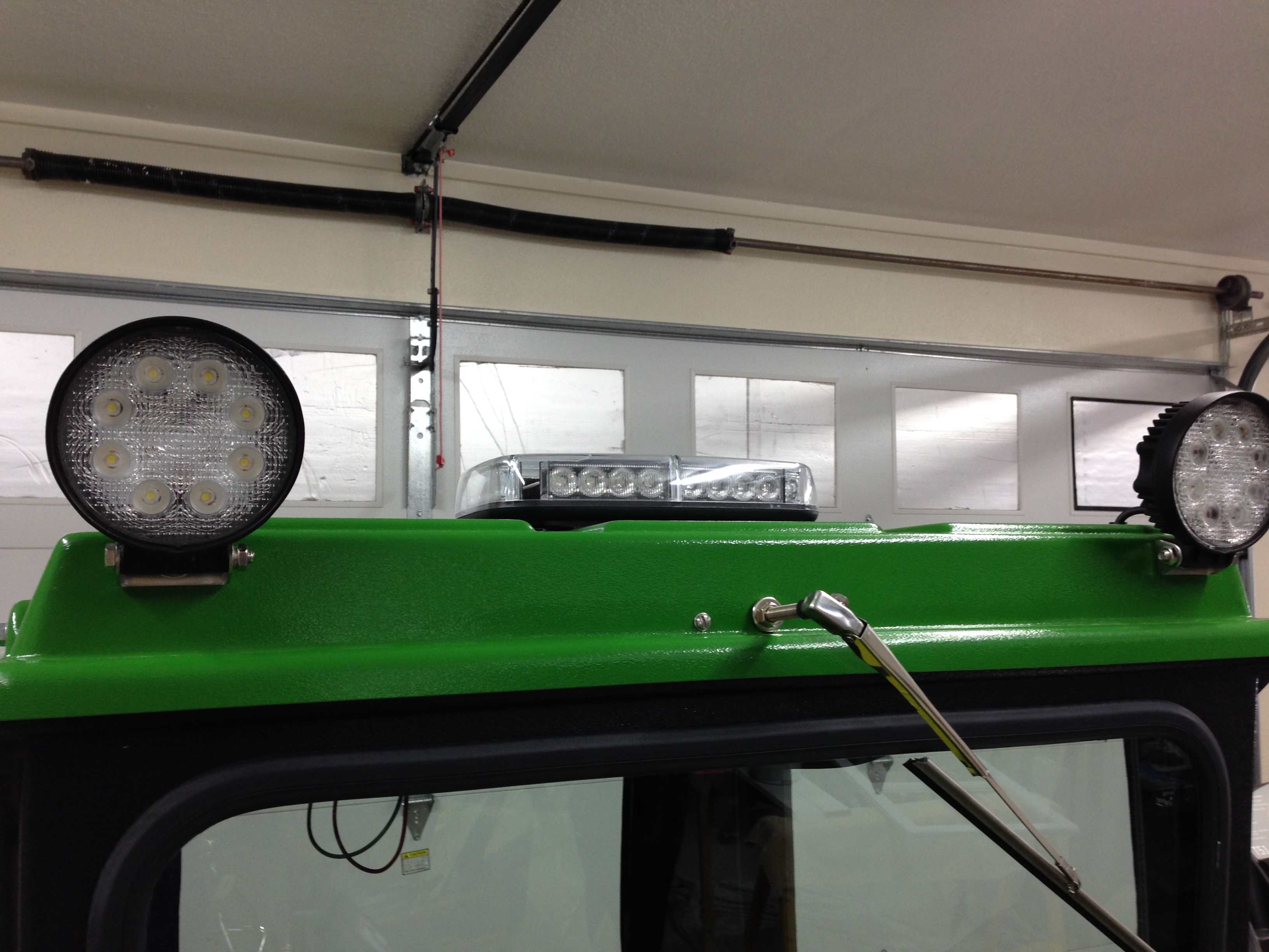

Fun Engineer 863 #4 Posted November 30, 2015 (edited) 1 hour ago, KC9KAS said: Quote This light is what I plan to purchase. It has (I think) 8 different flash patterns. http://www.ruralking.com/24-led-amber-light-bar-with-clear-cover.html 24 LED Amber Light Bar with Clear Cover SKU: 204190001 | In stock. Ships in 1-2 business days. 4.7 26 26 Review(s) | 3 Answered Question(s) Regular Price: $59.99 Special Price: $49.99 You Save $10 (16.67%) Shipping View Shipping Rates Economy Ground & Express Shipping available. (Exclusions may apply) Qty: Add to Cart Loading... Here's my setup. Edited November 30, 2015 by Fun Engineer 5 Share this post Link to post Share on other sites
cheesegrader 436 #5 Posted November 30, 2015 Fun, Man that is nice, except for the strange green paint. I like the front lights. Even if it is snowing or blowing hard enough to use the wiper, they still help. Make sure you clear the bottom of the garage door once mounted (don't ask) I have a cheap little flashing amber light on the back of my loader seat, and it has saved my butt several times. Amazing how hard it is to see an entire tractor at dusk in the winter. 2 Share this post Link to post Share on other sites

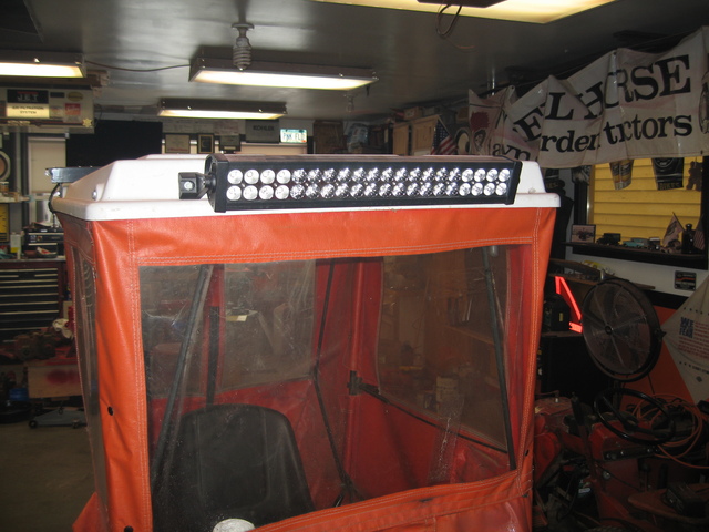

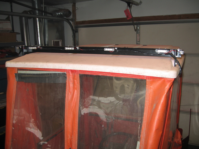

Shynon 7,656 #9 Posted December 1, 2015 This is what I am using, it is a 24" led light bar, has spot lights and flood lights. Also flashing leds with three programs. 9 Share this post Link to post Share on other sites

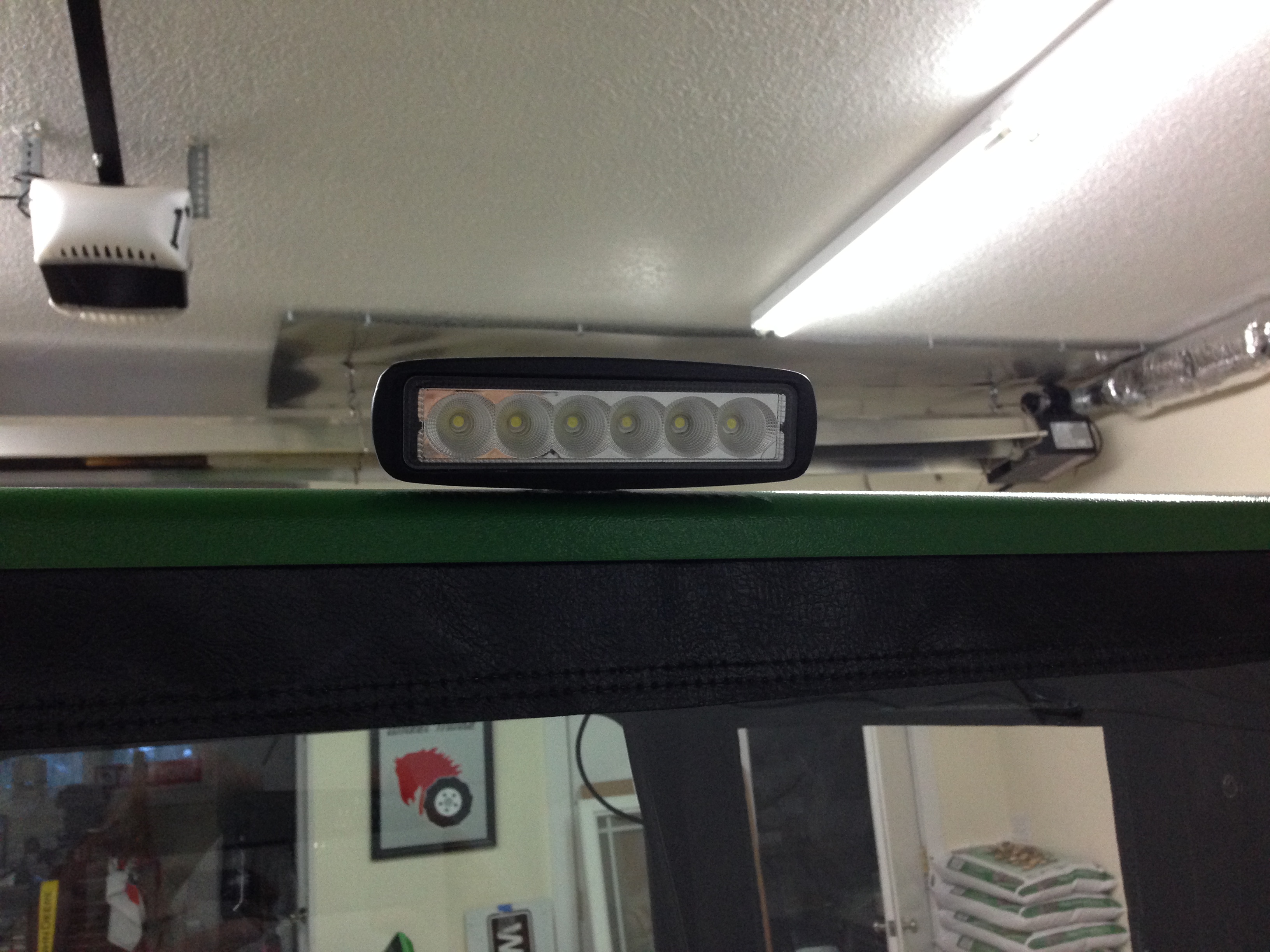

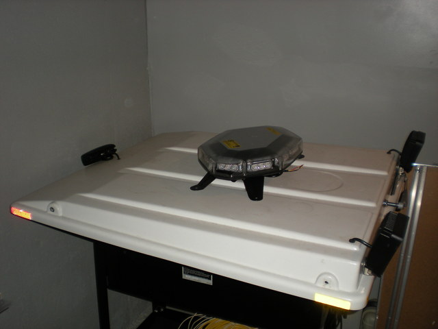

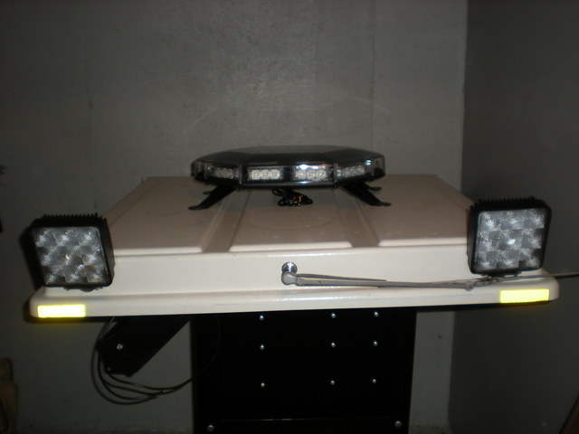

shallowwatersailor 3,222 #11 Posted December 1, 2015 Here is my new amber LED light bar that was on sale during this year's Black Friday. It is just resting on the roof as I have yet to re-install the cab for the season. My plan is to get it installed and, if the weather cooperates (mid 50s next week), paint the roof red for this year. That way I can strip everything off as it is much easier to work on not installed on the tractor. My front LED floods were bought before the influx of less expensive LED lights. I actually had purchased one of them a few years ago and used it with a magnetic mount on the rear of a tractor. After I got the cab, I decided to use it and bought the matching one for the front. The rear is the same as what Fun Engineer used. 5 Share this post Link to post Share on other sites

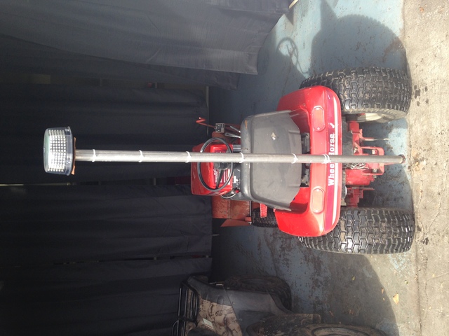

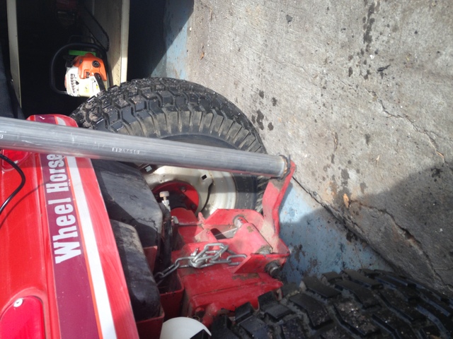

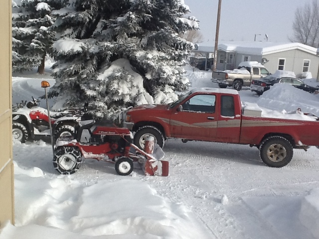

ce318 13 #14 Posted October 18, 2016 Just now, ce318 said: My solution to no cab but having to have emergency lighting 4 Share this post Link to post Share on other sites

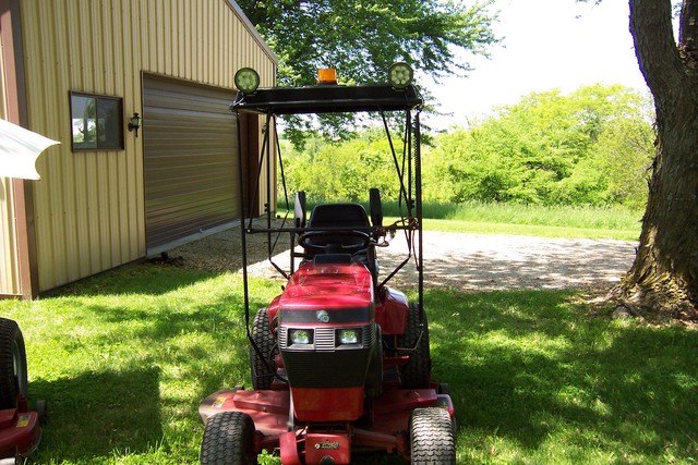

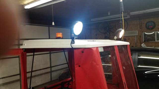

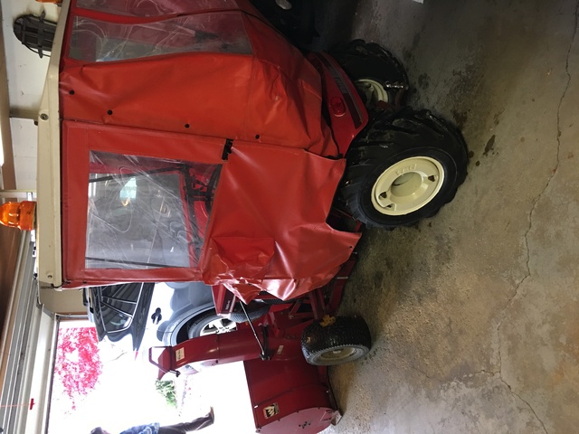

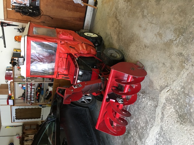

DougC 2,644 #16 Posted October 18, 2016 (edited) Here is what I put on mine . Less than 50 bucks total for lights and beacon from Amazon. Edited October 18, 2016 by DougC 1 Share this post Link to post Share on other sites

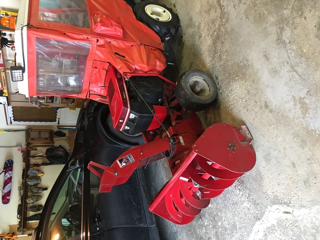

SylvanLakeWH 32,300 #19 Posted October 19, 2016 (edited) Here's what I use for night plowing. Magnet Mount. Plugs in to a cig. adaptor I mounted under the hood...has built in switch... Works like a charm... Oh...and a "cab"? What is that for? Edited October 19, 2016 by SylvanLakeWH 4 Share this post Link to post Share on other sites
ce318 13 #20 Posted October 22, 2016 I really want a cab. Just cant find one here on the west coast and nobody ships them. It will be another cold winter in snowsuit. At least I will be seen with the led. I am jealous of all the WH stuff that can be bought back east. 1 Share this post Link to post Share on other sites

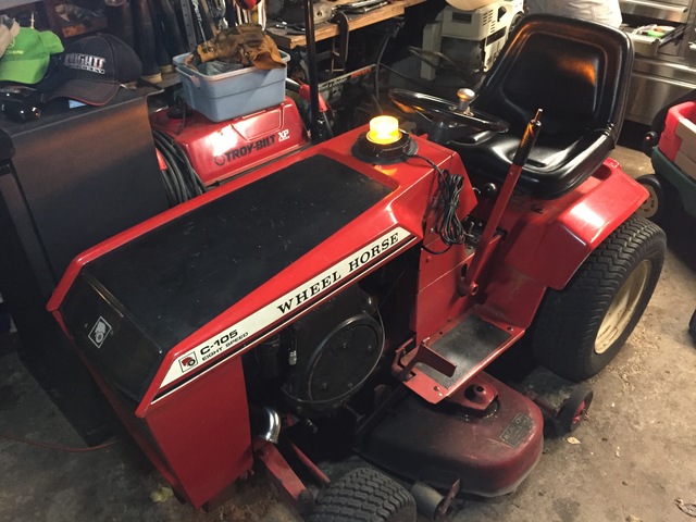

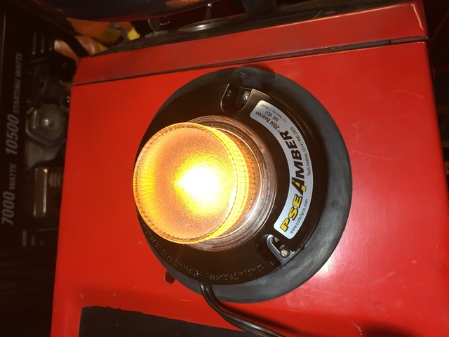

Chas520H 17 #23 Posted November 25, 2016 This is what I have, just bolted a price if plate to the top and bingo magnet works 1 Share this post Link to post Share on other sites

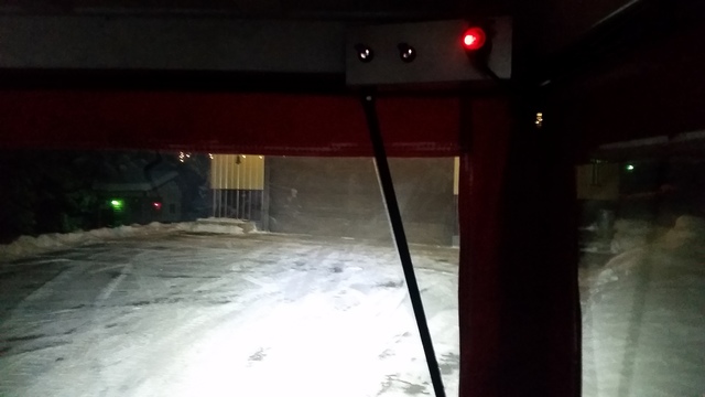

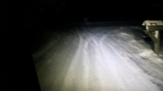

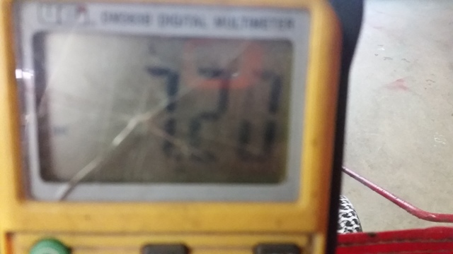

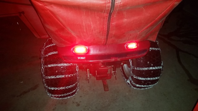

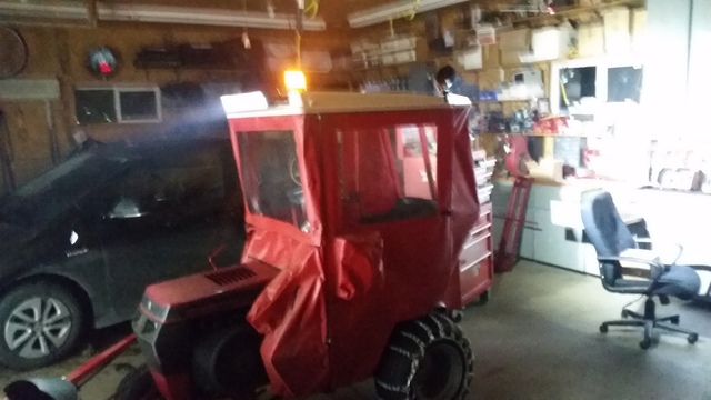

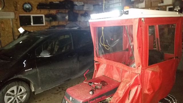

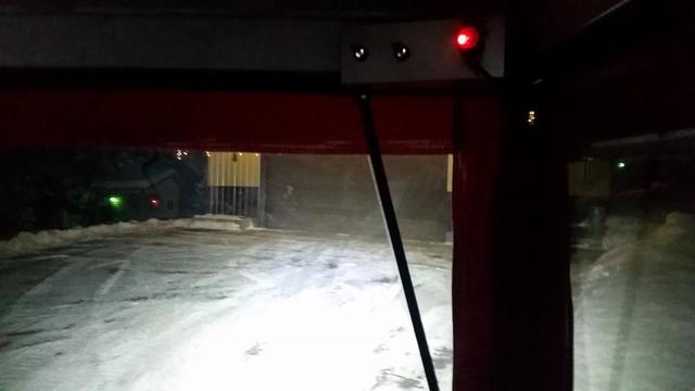

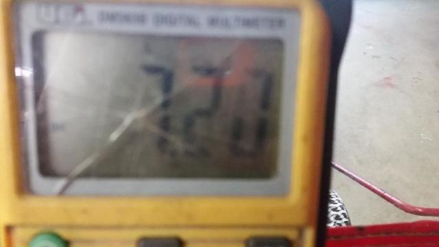

WHX?? 57,932 #24 Posted December 20, 2016 Got home last nite to some boxes on the porch...nothing like early X-mass presents to one's self! Pictures of how bright they are at night don't do it justice. Total price was less than 80 bucks http://www.ebay.com/itm/181933025289?_trksid=p2057872.m2749.l2648&ssPageName=STRK%3AMEBIDX%3AIT http://www.ebay.com/itm/152160080246?_trksid=p2057872.m2749.l2648&ssPageName=STRK%3AMEBIDX%3AIT and that was for four of the rear mounted ones Best part was the total amp draw less than 10 amps while I was at it the red rears had bulb holders that were giving grief so a pair of theses off Amazon...8 bucks a pair Its also amazing the rear ones are 27 watts each and appear to give off as much light as the 120 watt front bar. 2 Share this post Link to post Share on other sites
Sarge 3,473 #25 Posted December 20, 2016 I love the Amazon deal on these 18w flood cubes , brutally bright and they have an awesome track record in the off road world - https://www.amazon.com/Nilight-Driving-Lights-driving-Warranty/dp/B01KRV3PNA/ref=pd_nav_hcs_bia_t_1?_encoding=UTF8&refRID=G0V8JKK807291ZNA0BJ4&th=1 Just an fyi - Look for lights that are around 5,000K color temperature , or even better , down around 4200K . Those high temperature colors over or approaching 6000K are too blue for snow use and are actually a bit hard on your eyes . I almost prefer the 3000K fog colors of the old days for working in the snow since it takes away some of the harsh blues and glare from the snow - you can see it in your pictures . Sarge 1 Share this post Link to post Share on other sites
