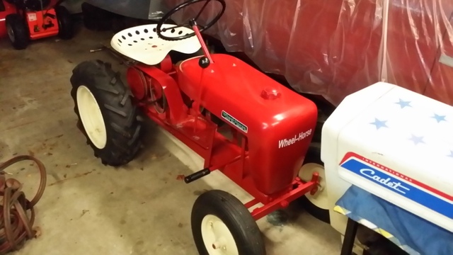

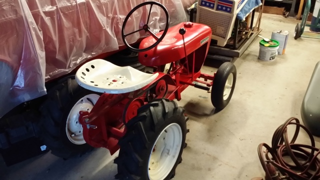

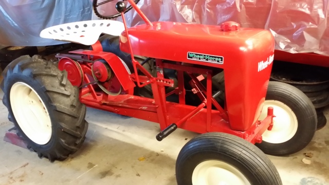

VinsRJ 724 #1 Posted November 28, 2015 Picked up this early 1955 RJ35, its missing a bunch of original parts but for the price it was a good deal IMO. Indicators of an early 55 RJ35: gas tank stand, no front axle stops, no support brace for the veri-dive arm and hood provision for the brass kill switch. The plan right now is to blow it apart and go through it. As the original hood is nice but not perfect... I have been toying with making another fiberglass RJ hood... As always the build will be on my Youtube Channel... https://www.youtube.com/user/VinsGN 16 Share this post Link to post Share on other sites

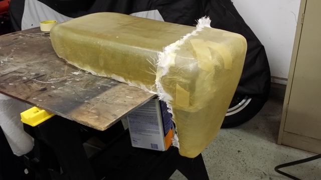

VinsRJ 724 #14 Posted December 14, 2015 (edited) Well I started a project which I said I would never do again... make another fiberglass repro RJ hood... In the pic attached I had not trimmed the edges down to size nor had I married the nose with the top portion. Overall I am just as pleased with the start of this hood as with the one I made for my Prototype tractor. The over all build process vid will be up on YouTube shortly if you are interested. -------------------------------------------------------------------------------------------------------------------------- On 12/8/2015 at 6:43 AM, Ken B said: Nice snag? What's with the Spirit of 76? Ken I just picked up the hood at the fall Zagray... why?... I have no idea, LOL! On 12/8/2015 at 6:52 AM, 953 nut said: great find, to my uneducated eye that would have been a 1957 due to the hood. How about doing a "Wiki" on the RJ 35 and 25 from '55 to '57 to share some of your knowledge. I just did a couple the other day and it didn't take too long. The "Wheel Hose" on the hood is just a sticker... its a 55 hood for sure... Edited December 14, 2015 by VinsRJ 3 Share this post Link to post Share on other sites

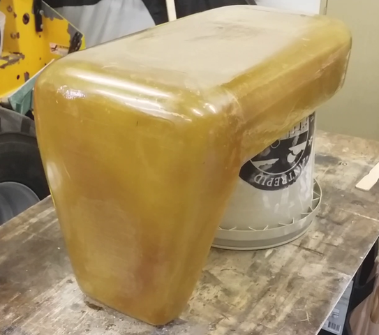

VinsRJ 724 #16 Posted January 26, 2016 (edited) Well the work on the hood has been slow... I'm just about to embark on the block sanding to straighten it all out. Big thanks goes out to a RS member with an original fiberglass hood, I was supplied with pics so I have been able to tailor this hood to the original specs... as always the actual build process will be released in stages on my YouTube Channel. Thank you for watching if you do so, much appreciated! Edited January 26, 2016 by VinsRJ 8 Share this post Link to post Share on other sites
AMC RULES 37,259 #17 Posted January 26, 2016 Nice fab work, and really looks great. What were you able to determine from the picts... is different about the fiberglass version Vin? Share this post Link to post Share on other sites
VinsRJ 724 #18 Posted January 27, 2016 On 1/26/2016 at 8:29 PM, AMC RULES said: Nice fab work, and really looks great. What were you able to determine from the picts... is different about the fiberglass version Vin? The back of the fiberglass hood is more of a pointed shape than gently rounded... and the sides have are more evenly rounded shape that runs the entire length... It's kind of hard to explain... I'll have pics in one of me up coming vids. 2 Share this post Link to post Share on other sites
