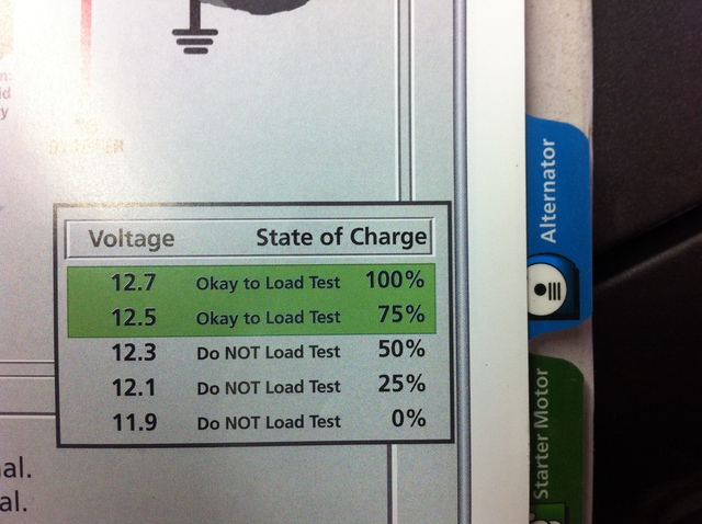

squonk 48,140 #15 Posted November 29, 2015 (edited) 12.49 is not fully charged yet. 12.7 is fully charged. What read 4V? The battery or the charger. 6 amp rate for 24 hrs. should have charged it fully. if not I'd say replace the battery. Edited November 29, 2015 by squonk 1 Share this post Link to post Share on other sites

jeff lary 173 #17 Posted November 29, 2015 Yes Squonk sorry, The charger when set to 6 amp 12 volt for 24 hours was still reading 4 on the charger dial ,..the same as when first connected 24 hours earlier 4 volts. To me that means the battery was in need of 4 volts to be fully charged,.. but after 24 hours it still read 4 so it took zero volts from the charger so battery is no good For the heck of it after I saw that reading I switched the charger to 2 amp 12 volt just for the hell of it and this morning at 8 am it was reading .5 as in it needed a 1/2 of a volt to be fully charged? So I just came in from a ranger ride a moment ago,.. Black Powder season starts tomorrow so I went to see how the guys were doing lining in their rifles. The ranger has been on the tender since this morning and it started right up. Now I will just try it every few days to see what happens next. Share this post Link to post Share on other sites
953 nut 69,419 #18 Posted November 29, 2015 Could be the six amp portion of you charger has a problem rather than the battery. Share this post Link to post Share on other sites
jeff lary 173 #19 Posted November 29, 2015 Yes I agree it is an ancient craftsman . I have a newer die hard automatic with micro processor boost and 2amp 12v and 6 amp 12 as well as 6 volt charging but it is crap I think. No matter what battery you connect to I says " yup yer all set fully charged !!" I need one good charger a new one that works flawlessly any favorites out there ? Share this post Link to post Share on other sites

tunahead72 2,662 #22 Posted November 29, 2015 4 hours ago, jeff lary said: Yes Squonk sorry, The charger when set to 6 amp 12 volt for 24 hours was still reading 4 on the charger dial ,..the same as when first connected 24 hours earlier 4 volts. To me that means the battery was in need of 4 volts to be fully charged,.. but after 24 hours it still read 4 so it took zero volts from the charger so battery is no good For the heck of it after I saw that reading I switched the charger to 2 amp 12 volt just for the hell of it and this morning at 8 am it was reading .5 as in it needed a 1/2 of a volt to be fully charged? So I just came in from a ranger ride a moment ago,.. Black Powder season starts tomorrow so I went to see how the guys were doing lining in their rifles. The ranger has been on the tender since this morning and it started right up. Now I will just try it every few days to see what happens next. Just making sure we're all on the same page here... The meter on my old Sears charger reads "D.C. Amperes"; i.e., amps, not volts. What are the units on your meter? Is it actually showing you volts, or amps? 1 Share this post Link to post Share on other sites

Save Old Iron 1,573 #24 Posted November 30, 2015 (edited) 13 hours ago, jeff lary said: The charger when set to 6 amp 12 volt for 24 hours was still reading 4 on the charger dial ,..the same as when first connected 24 hours earlier 4 volts. "old school" battery chargers are designed to have a voltage output of 15 volts or slightly above 15 volts. On 11/29/2015, 12:46:29, Save Old Iron said: <start battery rant> You guys are confusing the significance of cold cranking amps in relation to overall battery life. First up, ................. <end battery rant> I apologize. This is info is probably very confusing to those who just want to "gitter done" and use a BFH. You did say in your original post you wanted a high CCA battery and later stated the reason for that was you liked the way it grunts. Fair enough, and this should have been an early indication where we were going to end up. My amended advice would be to buy the biggest most expensive name brand battery that will fit in your battery tray. If you feel comfortable with a 300 CCA vs a 220 CCA - no argument. A 400- 900 CCA for a garden tractor - meh!. https://www.youtube.com/watch?v=iX3kxAA2L4Q Edited November 30, 2015 by Save Old Iron 2 Share this post Link to post Share on other sites
