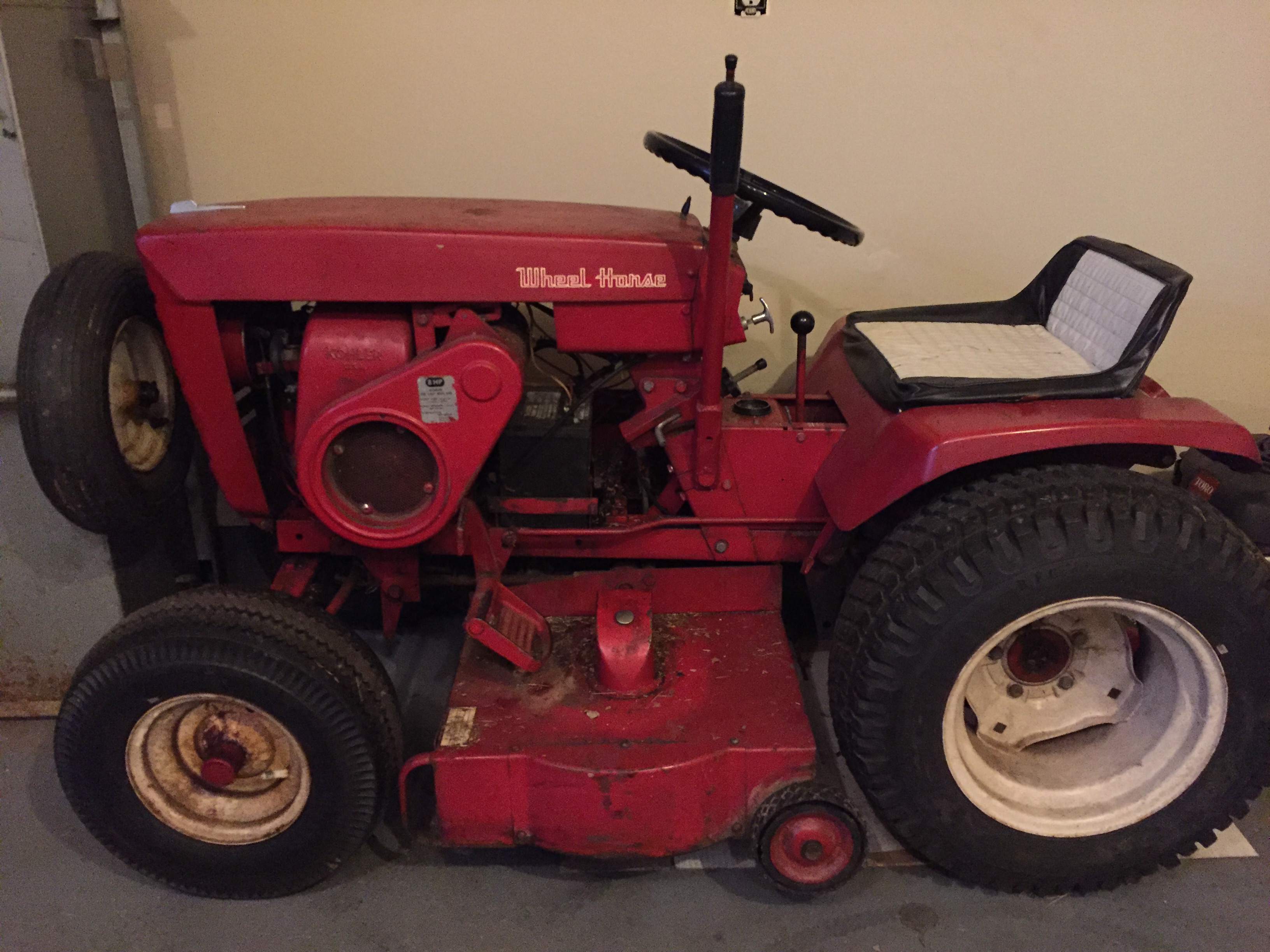

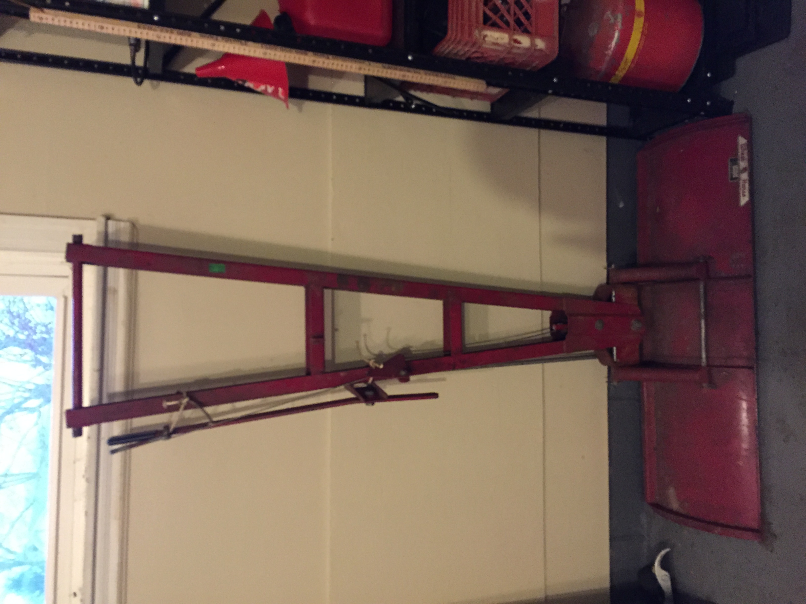

Tim Fleischer 7 #1 Posted November 28, 2015 Hi everyone, I joined the group this summer, and you were all VERY helpful in getting my handed down 855 up and running. I'd love to get this plow attached before Ohio State beats *ichigan today...does anyone have any helpful hints/diagrams or videos, as I am quite the novice. Thabk you in advance and GO BUCKEYES! Tim 1 Share this post Link to post Share on other sites
gwest_ca-(File Mod) 12,533 #2 Posted November 28, 2015 This manual should help You need the rear axle brackets and the lift link. Get the A-frame on the floor and push the tractor over it. When the lever on the right is past the front wheels bring the handle up so it ends up between the front and rear wheels. Keep going until the rear A-frame crossbar is at the rear axle hitch. Garry 1 Share this post Link to post Share on other sites

AMC RULES 37,260 #4 Posted November 28, 2015 I see your plow, do you have the rear axle bracket too? See post #77 here...lot's of info in here to help you get it mounted up. Share this post Link to post Share on other sites
Tim Fleischer 7 #5 Posted November 28, 2015 Thank goodness I do in fact have that bracket. It is attached to the 855. Again, thank you for the incredibly helpful info!!! Tim 1 Share this post Link to post Share on other sites
