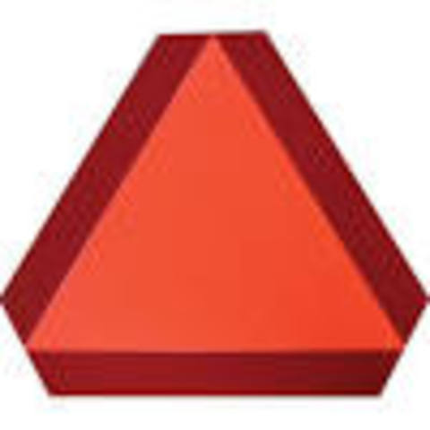

Sparky-(Admin) 26,688 #5 Posted November 26, 2015 I wish there was a registration process for us here in the states. It would be cool as heck to be able to "legally" drive the small local roads. Mike..... 1 Share this post Link to post Share on other sites
callum12 257 #6 Posted November 28, 2015 thanks nut, i knew about the the length i wasn't sure about width. is there really no registration process in the US? that's a bit annoying! i know in CA they've got orange triangles for un registered vehicles to drive a small distance on road under a certain speed. thanks again, callum Share this post Link to post Share on other sites

C-101plowerpower 1,606 #21 Posted December 1, 2015 wow, what a hassle to go on the road. i just have to put one of those orange triangle's on the back an i'm done 1 Share this post Link to post Share on other sites
callum12 257 #22 Posted December 1, 2015 I know! haha, i don't see why we can't have those orange triangles? callum I know! haha, i don't see why we can't have those orange triangles? callum Share this post Link to post Share on other sites
