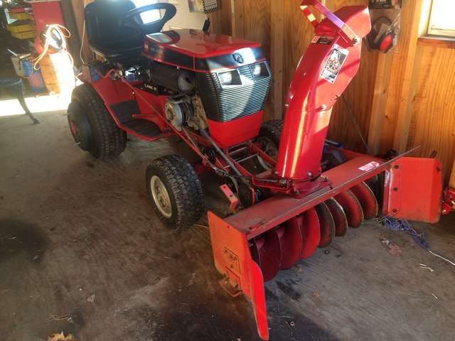

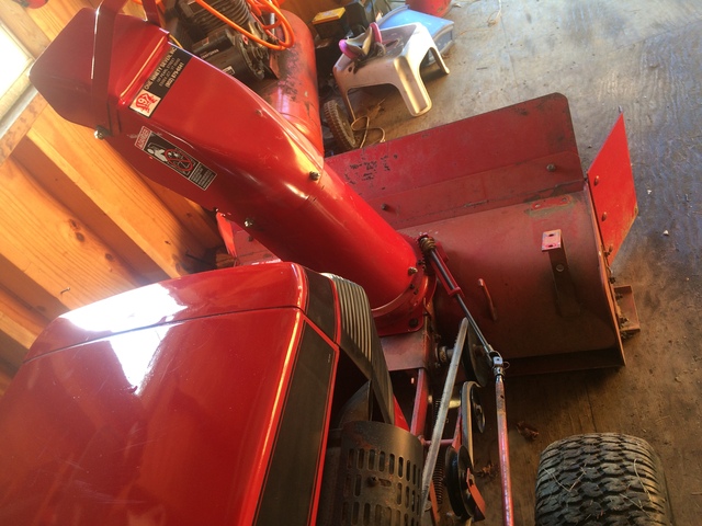

muz123 1,193 #1 Posted November 25, 2015 (edited) Well i converted my short chute blower to a tall chute. I love the gears rather than the wire to turn the chute. Turns real nice. Edited November 25, 2015 by muz123 9 Share this post Link to post Share on other sites

DennisThornton 4,773 #4 Posted November 25, 2015 Details please. That picture is just a teaser. How did you do it? 3 Share this post Link to post Share on other sites
DougC 2,644 #5 Posted November 25, 2015 I'd like a tutorial so I can do that to mine...... 2 Share this post Link to post Share on other sites

JERSEYHAWG / Glenn 4,590 #9 Posted November 26, 2015 Dave, nice job on the conversion, factory looking. Big differance. Glenn 1 Share this post Link to post Share on other sites
JAinVA 4,638 #10 Posted November 26, 2015 Nice job.I have both styles and if you have the parts its a bolt up swap.The basic blower housings are the same.The trick is getting the parts.Luck,JAinVA 1 Share this post Link to post Share on other sites
ericj 1,580 #11 Posted November 26, 2015 38 minutes ago, DougC said: I'd like a tutorial so I can do that to mine...... 9 minutes ago, DennisThornton said: Yeah! That! it real simple, the shoots bolt on to the blower housing with 4 bolts. you unbolt the short shoot base and the cable crank handle and bolt on the tall shoot base. but you need a donor blower or at least it helps to have a donor blower to get your parts from eric j 2 Share this post Link to post Share on other sites

DennisThornton 4,773 #14 Posted November 26, 2015 OK, so you need two blowers. Take the best of both, as long as one is a long chute! Good to know that chutes are interchangeable! 1 Share this post Link to post Share on other sites
muz123 1,193 #15 Posted November 26, 2015 First, have your wife find a tall chute on Craigslist. Then as your trying to avoid the bolts sticking out of the wheel weights, unbolt the four bolts holding on the original short chute. Bolt on the new one then take the original bar used to turn the chute and punch out the roll pin. Use a grinding wheel to grind down the end of the bar until it fits into the bar that turns the chute. Finally, find a right angle piece of steel/aluminum and bolt it to the tractor using one of the holes or bolts by the battery on the right side. That's it! Easy! 2 hours ago, Sparky said: Looks great Dave......now get back in the shed and cut off the all-thread stickin outa the rear wheel-weights. My shins are achin just thinking about what it'll feel like when you walk into one of em! Mike............ Well have you seen the movie "Ben Hur"? Well anytime I see a John Deere in the neighborhood.... 6 Share this post Link to post Share on other sites
WNYPCRepair 1,924 #16 Posted November 26, 2015 2 hours ago, muz123 said: First, have your wife find a tall chute on Craigslist. Then as your trying to avoid the bolts sticking out of the wheel weights, unbolt the four bolts holding on the original short chute. Bolt on the new one then take the original bar used to turn the chute and punch out the roll pin. Use a grinding wheel to grind down the end of the bar until it fits into the bar that turns the chute. Finally, find a right angle piece of steel/aluminum and bolt it to the tractor using one of the holes or bolts by the battery on the right side. I was lucky, I had the entire crank, etc, so all I had to do was bolt the chute assembly on. Some nice work there, Muz. I cut the old crank mount off mine, but I was just looking at yours thinking it would be a great place to mount a nice LED light. 1 Share this post Link to post Share on other sites
muz123 1,193 #17 Posted November 26, 2015 (edited) 54 minutes ago, WNYPCRepair said: I was lucky, I had the entire crank, etc, so all I had to do was bolt the chute assembly on. Some nice work there, Muz. I cut the old crank mount off mine, but I was just looking at yours thinking it would be a great place to mount a nice LED light. Yea i had the whole gear assembly also. Edited November 26, 2015 by muz123 Share this post Link to post Share on other sites
WNYPCRepair 1,924 #18 Posted November 26, 2015 I meant the bar to crank it. Luckily I had that piece from the tall chute too, it's on a bracket that hooks to the mid attach a matic. 1 Share this post Link to post Share on other sites
