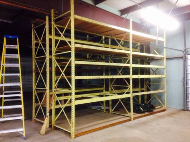

WNYPCRepair 1,924 #5 Posted November 29, 2015 My next project is to turn these pallet racks into scaffolding. Each upright is 21 feet tall, and the cross pieces are 10 feet long. I want to cut the 21 foot scections into 3 pieces, and make a quick connector to the tops and bottoms, so I can set it up like scaffolding. Share this post Link to post Share on other sites

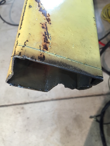

WNYPCRepair 1,924 #9 Posted December 13, 2015 Ran my 220 line this morning, hooked the plasma cutter up and tried it out. Cut a piece of 3/8" steel with no problem. Took a few passes as the slag kept cooling and welding it back together, but it did make a nice cut. Share this post Link to post Share on other sites
WNYPCRepair 1,924 #10 Posted December 21, 2015 On November 29, 2015 at 9:09 AM, WNYPCRepair said: Used the plasma cutter today, it performed flawlessly, and the pilot arc feature does indeed work. Cut right through the painted steel just like it does on clean steel. It has a consumable electrode that starts to melt and sprays out the tip, which burns the paint off and then you have plain steel to make the arc. Unfortunately, the electrode burns all the time, so if you are burning clean steel, disconnect the pilot electrode wire. I had to cut the horizontal shelf rails on those racks above down to 8 feet from 10 feet. 10 feet is too wide for my garage, though I may put the finished product in the HF tent garage instead. The cut was nice and clean, and quick. I decided to build a rack for mower decks, and other attachments/implements. If my idea works, you will be able to put a deck or implement on, lift it up, put on a deck, lift it up, and so on. The down side is you have to remove everything until you get to what you need, but if it works (and something else doesn't come up before I finish), it will be a cool storage system. 1 Share this post Link to post Share on other sites
JPWH 6,544 #11 Posted December 21, 2015 Nice cut! 1 Share this post Link to post Share on other sites
