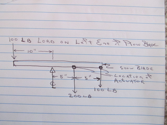

Ed Kennell 47,615 #53 Posted February 11, 2016 (edited) I'm not sure how the angle of the actuator affects the loading on it. But it is clear the location of the attachment point from the center of the blade is directly proportional to the force on the actuator as illustrated below. Edited February 11, 2016 by ekennell 1 Share this post Link to post Share on other sites
