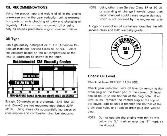

pfrederi 21,346 #4 Posted November 21, 2015 Kohler recommendations looks lie 10w-30 would be good for you 4 Share this post Link to post Share on other sites

Retired Sparky 526 #9 Posted February 15, 2016 I realize location is everything in this conversation. Lots of difference in winter temps. between Arkansas and Maine. But for thirty years I have used #30 above 32 deg. and #5w/30 below 32 deg. Cause we do get below 0 deg. That's my. It works in my backyard. 2 Share this post Link to post Share on other sites
bds1984 1,519 #10 Posted February 18, 2016 If you'd like a good read on oil, http://www.bobistheoilguy.com/ or http://www.pqiamerica.com/ are good sites. Any 10W30 would be fine in our engines in the winter as long as we're not is sub-zero consistently. I use 5W40 Rotella as pointed out above and it is great. The whole protect your cam lobes with zinc because the stuff isn't in modern oil is irrelevant, and outdated, unless one is running an engine with triple valve springs that have high compression. 1 Share this post Link to post Share on other sites
DennisThornton 4,773 #11 Posted February 19, 2016 Sub-zero is going to beg for a multi-weight but my concern is this strange weather we've been having would have me changing oil weekly! Near 70F Christmas eve! -20F a couple days ago and then pushing 50 shortly after! My luck is a cold front would come in, dump 2ft of snow and then warm up to 50 while I'm trying to cleanup the slush! Sometimes you have pick your poisons! If they won't start because the 30wt turns to molasses then 10w or 5w or added heat might be a must! I don't do it all the time but my current thoughts are 10w30 for the winters up here and 30w for the warm weather. 4 Share this post Link to post Share on other sites
