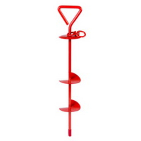

rmaynard 16,700 #6 Posted November 19, 2015 (edited) I ran spiral dog chain stakes into the ground at all four inside corners. Then I attached ratchet straps to the frame at the top of the walls and to the stakes. I haven't had any serious winds since then, but this will be the second winter that the tent garage has been in use. I worry more about the snow load on the top. Edited November 19, 2015 by rmaynard Share this post Link to post Share on other sites

WNYPCRepair 1,923 #9 Posted November 20, 2015 I have the screw in the ground anchors at the corners, and the middle posts are screwed directly into the concrete pad underneath. The tent is exactly the size of the pad. Share this post Link to post Share on other sites

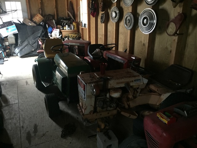

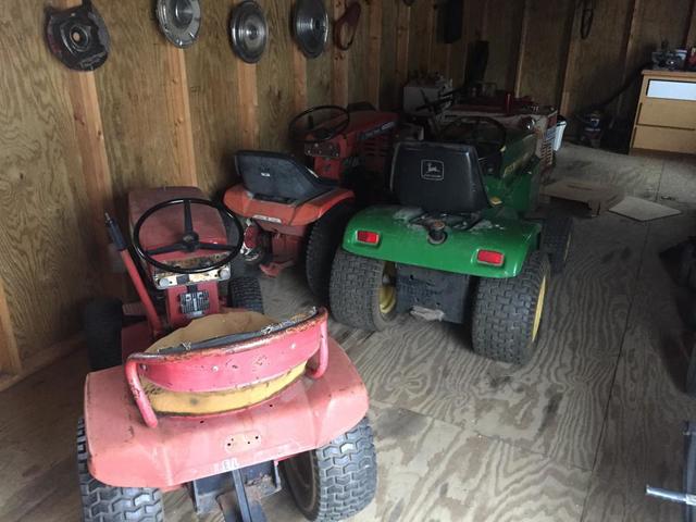

ClassicTractorProfessor 5,455 #10 Posted December 13, 2016 Sounds like everyone has had pretty good luck with these little garages...thinking about buying one in the near future. We have a shed here at our new house but I am finding it to be not big enough...it's still in the works to be bringing home another Horse with tiller and as you can see I am running out of room in our shed. So may try one of these and see how it holds up to the Oklahoma wind. Snow isn't much of a problem here but the wind may be 1 Share this post Link to post Share on other sites

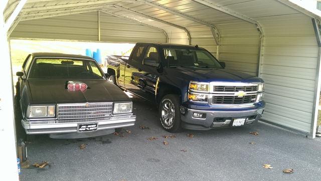

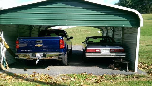

WVHillbilly520H 10,377 #12 Posted December 14, 2016 Go for an all steel carport 18'x21' installed starts $700 or with sides like mine $1200,Jeff. 1 Share this post Link to post Share on other sites
