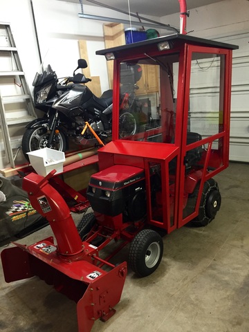

Bosco 32 #1 Posted November 19, 2015 let it snow. 12 Share this post Link to post Share on other sites
SylvanLakeWH 32,783 #2 Posted November 19, 2015 Love It!Looks like a London Phone Booth Knock-off...Manual or electric wiper? Share this post Link to post Share on other sites
stevebo-(Moderator) 8,742 #3 Posted November 19, 2015 Very nice!! I would any you are pippin' Share this post Link to post Share on other sites
Ed Kennell 47,754 #4 Posted November 19, 2015 Nice...now that has some visibility. Does the front panel lift to open the hood? Share this post Link to post Share on other sites
Wheel-N-It 2,978 #5 Posted November 19, 2015 Love It!Looks like a London Phone Booth Knock-off...Manual or electric wiper? I must admit thats exactly what I was thinking. Its a very nice piece! Well done! Share this post Link to post Share on other sites
Rollerman 291 #6 Posted November 19, 2015 Bosco are you a Dr. Who fan?It really does look good. 1 Share this post Link to post Share on other sites
DennisThornton 4,773 #7 Posted November 19, 2015 let it snow. That is simply extremely awesome! Blows my Original Cab with hardtop, windshield and wiper away!What joinery did you use?Thickness of the plexiglas?How do you check the oil?Need more pictures and details, please! Share this post Link to post Share on other sites
tractorhogg 667 #8 Posted November 19, 2015 That is one heck of a job, Kudos sir. 1 Share this post Link to post Share on other sites
WNYPCRepair 1,924 #9 Posted November 19, 2015 Nice carpentry. Share this post Link to post Share on other sites
slammer302 2,157 #10 Posted November 19, 2015 I would like to see more pics of how its attached Share this post Link to post Share on other sites
Mike_Eddleman 71 #11 Posted November 19, 2015 That looks great, living in the south I guess I'll never need one 2 Share this post Link to post Share on other sites
muz123 1,193 #12 Posted November 19, 2015 Looks really good!! Nice job. Share this post Link to post Share on other sites
shallowwatersailor 3,222 #13 Posted November 19, 2015 That looks really good, and functional. Share this post Link to post Share on other sites
DougC 2,644 #14 Posted November 19, 2015 Great job! I started out planning to build a cab but since my carpentry skills are sub-par and my patience is non existent these days I bought one instead. Yours looks like a cab company made it....... Share this post Link to post Share on other sites

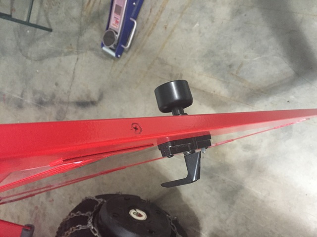

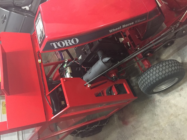

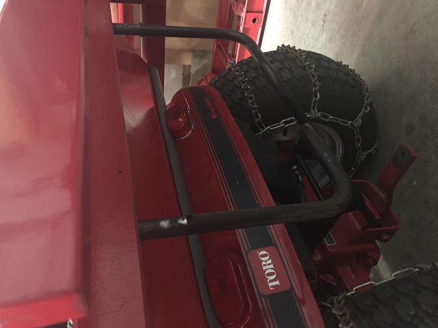

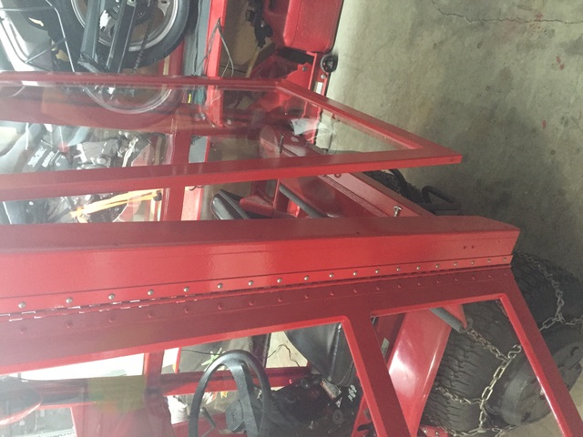

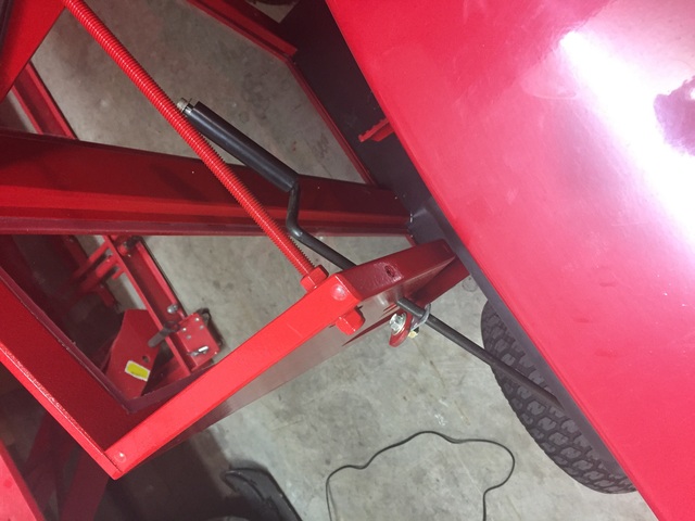

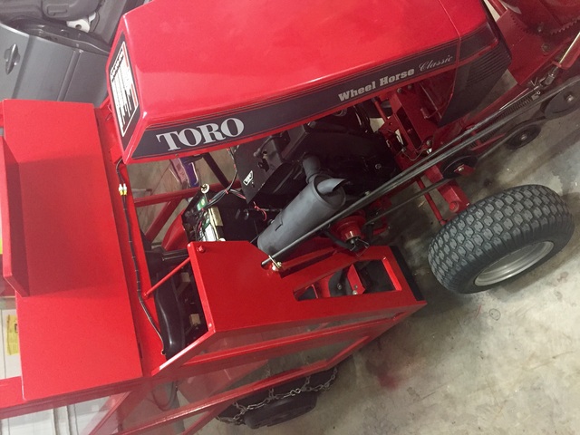

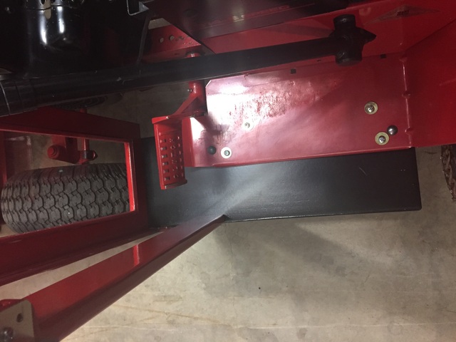

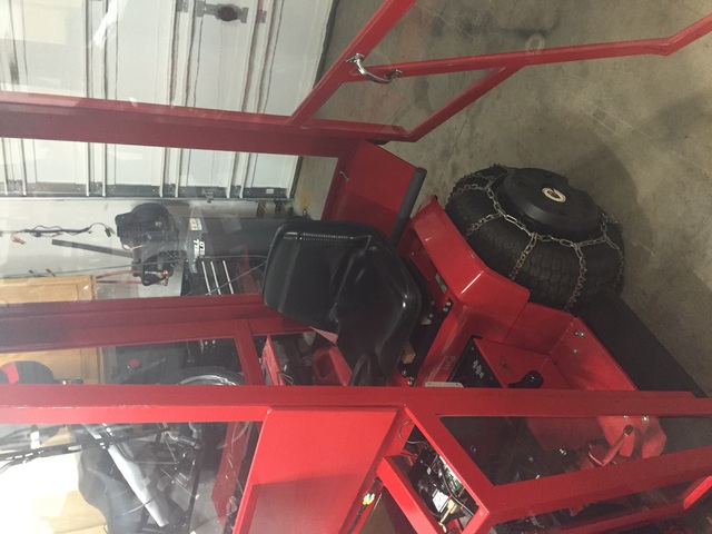

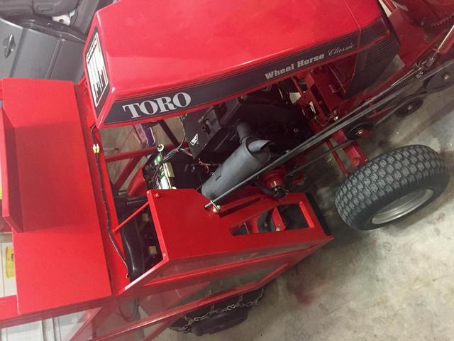

Bosco 32 #20 Posted November 20, 2015 Well here's the deal guys the cab is on the tall side because I am 6 foot 4 and the last thing I wanted to do was smash my head on the way in and out every time. I do agree it looks like a phone booth but that's what happens when you shoot off the hip when building. It may look a little funny but it fits me well. It mounts to the rear bagger bracket and with 4 screws down thru each floor board. I used a lot of glass over plywood to eliminate blind spots. The original plan was to use plexy glass but when I found out how expensive it was going to get I went to plan B. I bought safety glass for windshield and rear window for $40. All the other glass was free from local glass shops due to scratches and was dumpster bound. Brought it all home and grabbed a glass cutter. Used 1/2 ac plywood and pine to build cab that was left over from other jobs. Windshield wiper motor is off an old boat and wiper arm off old Chevy van. 3 quarts of sunrise red and I'm into to it for $150. Hope the pictures help. 11 Share this post Link to post Share on other sites
