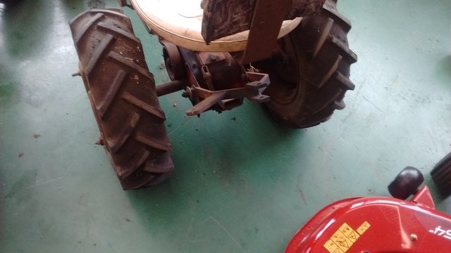

953 nut 69,056 #2 Posted November 19, 2015 Cant tell you much about the thingie welded to the left side of the hitch, but the rest of it is for pulling a cart or implement when you had a mower deck mounted. The sleeve hitch would have a bracket that raised the rear of the deck. By the way, they are a bit hard to come by, nice to have. Share this post Link to post Share on other sites

SPINJIM 1,997 #4 Posted November 19, 2015 Yep, that's a 'sleeve hitch'. It looks like an early version, or a make-it-yourself version. It might work with the Brinly-Hardy attachments for plowing or cultivating. The piece welded onto the left side is usually vertical and linked to the lift handle to raise and lower the plow. It's unusual to see a sleeve hitch on a Suburban. Maybe it was just used to pull a cart. Good find for $40. Now you have the decision I have been faced with a few times. Do you just use it for parts, or do you sink hundreds of dollars into it to make a working tractor. I'd evaluate the engine and the trans before deciding. Good luck with it.Jim Share this post Link to post Share on other sites
Jake Kuhn 1,600 #5 Posted November 19, 2015 Agreed with Richard on the hitch. They were just used so you had a drawbar hitch to tow a cart when you had the mower deck. The mower deck eliminated the use of the slot hitch. The piece to the left side is an add on and does not belong there. While it does sort of resemble a brinly sleeve hitch that is not what it is used for. 1 Share this post Link to post Share on other sites
