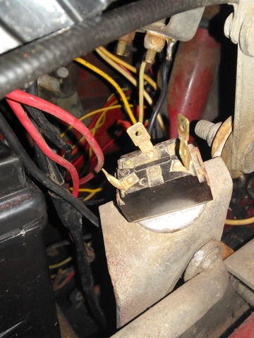

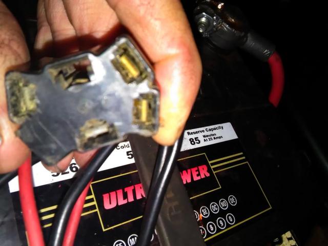

rexman72 210 #1 Posted November 19, 2015 (edited) does anyone else have any isses with the pto lever or switchs when trying to start there tractor.Seems like I have to play around with the pto lever to get it started and now it wont start at all..Any suggestions?these are the pics of whats there for a switch now.Do you have to adjust the lever some how? Edited November 19, 2015 by rexman72 Share this post Link to post Share on other sites

Shuboxlover 474 #3 Posted November 19, 2015 This is what I have...1 and 2 are normally open...3 and 4/5 are normally open.I don't know if this is what you need, but if it is, PM me. Share this post Link to post Share on other sites
Bubblehead 0 #4 Posted March 4, 2016 I have a D-200. I attempted to use the tiller last fall, and when I engaged the PTO the engine died. I assume this is due to a bad switch. If parts are not available, is it possible to bypass the switch? Share this post Link to post Share on other sites
rexman72 210 #5 Posted March 12, 2016 welcome to RS.Parts are available as I found them on ebay. Share this post Link to post Share on other sites
