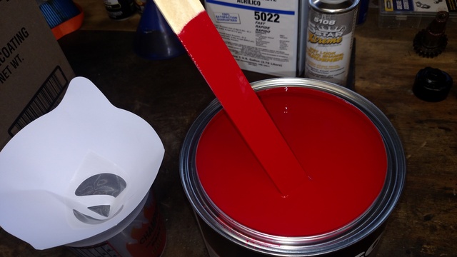

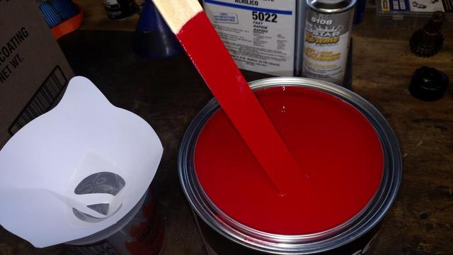

RedRanger 1,470 #1 Posted November 17, 2015 For those of you have gone down this road before....I'm trying to estimate how much color I need. Totally stripping, epoxy priming, and spraying automotive single stage Urethane with a gun. Dupont Nason 8:1:2 mix.2-3 layers of color will be applied.How much color do I need for say a suburban and 32" mower deck? Is a quart enough?I've got a Lawn Ranger and a 401 that both are getting sprayed along with 3 different mower decks.Not sure if I should buy 2 quarts or break down and get a gallon?At $270 a gallon for the color, I hate to buy too much product but I also don't want to run short.Decisions Decisions. Share this post Link to post Share on other sites
squonk 48,288 #2 Posted November 17, 2015 (edited) Are you using HVLP or standard gun? Edited November 17, 2015 by squonk Share this post Link to post Share on other sites
953 nut 70,077 #4 Posted November 17, 2015 Considering the fact that you will be painting both sides of the majority of parts and will have numerous small parts I would go for the Gallon, probably a gallon will cost about the same as two and a half quarts and with a gallon you are assured that there won't be any color variation like you could have with multiple quarts. 3 Share this post Link to post Share on other sites
WHX?? 58,330 #5 Posted November 17, 2015 Go with the gallon Red you will not like it if you run out, sides... you can always sneek out and shoot a couple of yellow & green things with leftovers, well maybe that would be a waste at that price but maybe the wife's car?!?! 3 Share this post Link to post Share on other sites
RedRanger 1,470 #6 Posted November 17, 2015 Go with the gallon Red you will not like it if you run out, sides... you can always sneek out and shoot a couple of yellow & green things with leftovers, well maybe that would be a waste at that price but maybe the wife's car?!?! I don't think she'd appreciate me covering her pearl white Lexus in IH-50 Red. Go with the gallon Red you will not like it if you run out, sides... you can always sneek out and shoot a couple of yellow & green things with leftovers, well maybe that would be a waste at that price but maybe the wife's car?!?! Thanks, that's what I'm figuring. If I don't buy a gallon I'll need it. If I do buy it, I'll have extra.Guess I'll just have to find another horse to restore If I have extra? Right!?? Maybe some attachments????The cost for Red paint is just nuts though. 1 Share this post Link to post Share on other sites

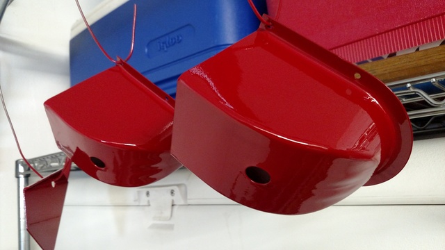

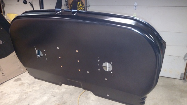

RedRanger 1,470 #9 Posted November 19, 2015 International Harvester IH-50Dupont/Nason code 7410This is the darker/original IH color. Almost perfect match to Regal Red.$266 in that can. Sprays beautiful though.Laid over black Epoxy primer. 5 Share this post Link to post Share on other sites
953 nut 70,077 #10 Posted November 20, 2015 Nice work, Your primer looks better than a lot of finished paint jobs, Then comes the magic, oops, couldn't find a spray gun emoticon. Looks great. 2 Share this post Link to post Share on other sites

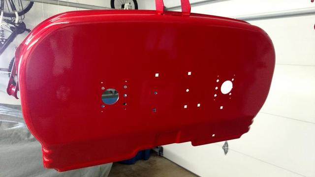

DennisThornton 4,773 #11 Posted November 20, 2015 (edited) Looks real good. 15 yrs of owning an autobody paint shop but I never go to spray epoxy primer. But, that was a long time ago! So I'm curious Edited November 20, 2015 by DennisThornton but I never go to Share this post Link to post Share on other sites
RedRanger 1,470 #12 Posted November 20, 2015 (edited) Looks real good. 15 yrs of owning an autobody paint shop and I never spray epoxy primer. Why is that?First time for me, and I'm impressed. Lays down like paint and sticks real good.72 hour window to topcoat before you have to scuff or seal.Other than some dust in the primer, it laid out smoother than the paint. I used their standard formula that was "thinner" than their high build formula which the supplier said was very thick and used on heavy equipment. Is epoxy not popular in auto shops? That Nason paint sprays nice too. I laid 3 coats... a light tack coat, a medium coat, and a wet coat about 20 minutes apart at 65 degrees. The wet coat burned in and flowed like glass. No real heat in my shop, just a torpedo. After the parts dried to the touch, about 45 minutes, I moved them to our attached garage where we have a wall gas fired furnace to bake for a day or two. Drying at 75 degrees right now.Looking at the coming weather, I think I'm done shooting red until spring. That gives us the winter to strip down and prime the Lawn Ranger. Edited November 20, 2015 by RedRanger 1 Share this post Link to post Share on other sites
DennisThornton 4,773 #13 Posted November 20, 2015 Looks real good. 15 yrs of owning an autobody paint shop and I never spray epoxy primer. Why is that?First time for me, and I'm impressed. Lays down like paint and sticks real good.72 hour window to topcoat before you have to scuff or seal.Other than some dust in the primer, it laid out smoother than the paint. I used their standard formula that was "thinner" than their high build formula which the supplier said was very thick and used on heavy equipment. Is epoxy not popular in auto shops? That Nason paint sprays nice too. I laid 3 coats... a light tack coat, a medium coat, and a wet coat about 20 minutes apart at 65 degrees. The wet coat burned in and flowed like glass. No real heat in my shop, just a torpedo. After the parts dried to the touch, about 45 minutes, I moved them to our attached garage where we have a wall gas fired furnace to bake for a day or two. Drying at 75 degrees right now.Looking at the coming weather, I think I'm done shooting red until spring. That gives us the winter to strip down and prime the Lawn Ranger. Boy! I sure didn't type what I meant to say! I edited that comment somewhat! My point was that epoxy primer wasn't common, or perhaps just wasn't back in the 80s and I've never needed or bothered to try it since. Not that I'm against it at ALL! Just that I basically know nothing about it at ALL! Looks shiny like a primer and rather than a sandable primer/filler intended to be sanded and to fill scratches, and while I didn't use epoxy primers, I did always prime first and then use a primer/filler to build and fill grinder marks and sand scratches, then a sealer before painting. As far as I can tell you did just fine! Share this post Link to post Share on other sites
RedRanger 1,470 #14 Posted November 20, 2015 Looks real good. 15 yrs of owning an autobody paint shop and I never spray epoxy primer. Why is that?First time for me, and I'm impressed. Lays down like paint and sticks real good.72 hour window to topcoat before you have to scuff or seal.Other than some dust in the primer, it laid out smoother than the paint. I used their standard formula that was "thinner" than their high build formula which the supplier said was very thick and used on heavy equipment. Is epoxy not popular in auto shops? That Nason paint sprays nice too. I laid 3 coats... a light tack coat, a medium coat, and a wet coat about 20 minutes apart at 65 degrees. The wet coat burned in and flowed like glass. No real heat in my shop, just a torpedo. After the parts dried to the touch, about 45 minutes, I moved them to our attached garage where we have a wall gas fired furnace to bake for a day or two. Drying at 75 degrees right now.Looking at the coming weather, I think I'm done shooting red until spring. That gives us the winter to strip down and prime the Lawn Ranger. Boy! I sure didn't type what I meant to say! I edited that comment somewhat! My point was that epoxy primer wasn't common, or perhaps just wasn't back in the 80s and I've never needed or bothered to try it since. Not that I'm against it at ALL! Just that I basically know nothing about it at ALL! Looks shiny like a primer and rather than a sandable primer/filler intended to be sanded and to fill scratches, and while I didn't use epoxy primers, I did always prime first and then use a primer/filler to build and fill grinder marks and sand scratches, then a sealer before painting. As far as I can tell you did just fine! Ah. I thought you meant you wouldn't use it.Not a professional, but I've done a couple cars for myself. First time using Epoxy primer though.Sprays nice and dries fast. Sticks to bare metal great. Very little over spray.Supposedly good for preventing rust.It's ready to topcoat with no scuffing within 2 hours up to 72 hours. After that you have to scuff it and possibly seal again before topcoat.Unless I was at bare metal, not sure I'd use it or even need it though.It's also available in high build for filling imperfections. Share this post Link to post Share on other sites
DennisThornton 4,773 #15 Posted November 20, 2015 Looks real good. 15 yrs of owning an autobody paint shop and I never spray epoxy primer. Why is that?First time for me, and I'm impressed. Lays down like paint and sticks real good.72 hour window to topcoat before you have to scuff or seal.Other than some dust in the primer, it laid out smoother than the paint. I used their standard formula that was "thinner" than their high build formula which the supplier said was very thick and used on heavy equipment. Is epoxy not popular in auto shops? That Nason paint sprays nice too. I laid 3 coats... a light tack coat, a medium coat, and a wet coat about 20 minutes apart at 65 degrees. The wet coat burned in and flowed like glass. No real heat in my shop, just a torpedo. After the parts dried to the touch, about 45 minutes, I moved them to our attached garage where we have a wall gas fired furnace to bake for a day or two. Drying at 75 degrees right now.Looking at the coming weather, I think I'm done shooting red until spring. That gives us the winter to strip down and prime the Lawn Ranger. Boy! I sure didn't type what I meant to say! I edited that comment somewhat! My point was that epoxy primer wasn't common, or perhaps just wasn't back in the 80s and I've never needed or bothered to try it since. Not that I'm against it at ALL! Just that I basically know nothing about it at ALL! Looks shiny like a primer and rather than a sandable primer/filler intended to be sanded and to fill scratches, and while I didn't use epoxy primers, I did always prime first and then use a primer/filler to build and fill grinder marks and sand scratches, then a sealer before painting. As far as I can tell you did just fine! Ah. I thought you meant you wouldn't use it.Not a professional, but I've done a couple cars for myself. First time using Epoxy primer though.Sprays nice and dries fast. Sticks to bare metal great. Very little over spray.Supposedly good for preventing rust.It's ready to topcoat with no scuffing within 2 hours up to 72 hours. After that you have to scuff it and possibly seal again before topcoat.Unless I was at bare metal, not sure I'd use it or even need it though.It's also available in high build for filling imperfections. I'm sorry... I wrote that so poorly! What I really meant to say was I've got lots of experience and while none with epoxy primer I'm still all ears, or eyes in this case. Grasshopper thing perhaps. Please share your new experiences with an old painter! Share this post Link to post Share on other sites

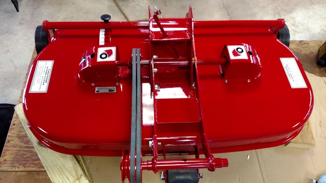

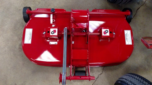

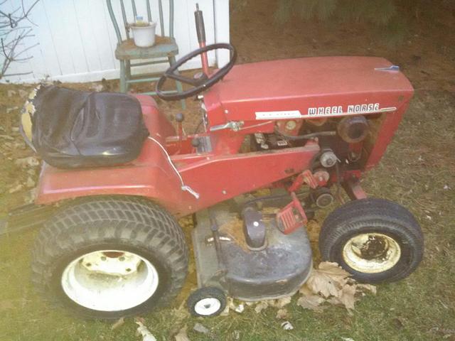

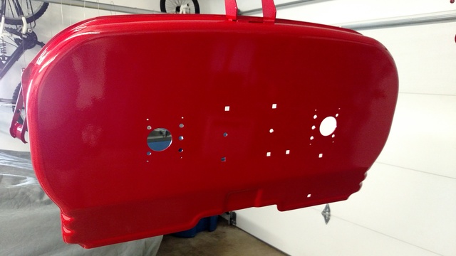

RedRanger 1,470 #16 Posted December 11, 2015 Got the deck assembled. Now I have to wait for grass. After all it's only December. NOS deck shell, NOS pulleys, NOS gears, new bearings, new seals, new belts, NOS blades, new wheels, some brass bushings, Terry's decals, and stainless hardware. Can't wait to mow with it in the spring. Here's what I started with. 3 Share this post Link to post Share on other sites
