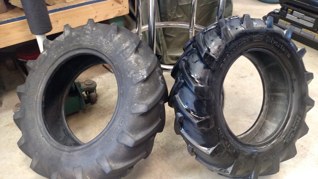

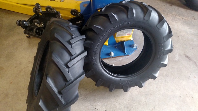

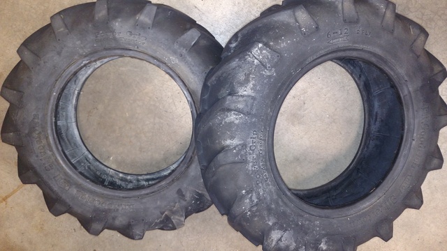

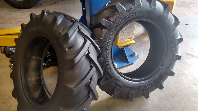

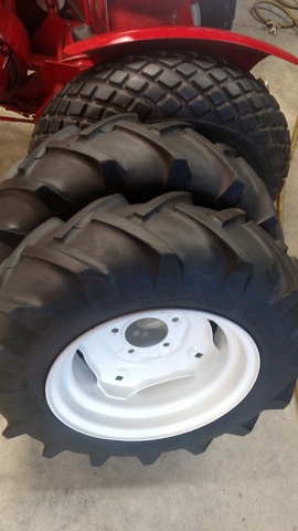

RedRanger 1,470 #27 Posted December 7, 2015 Well....They're done. Almost. I pinched a tube while mounting the first one, so I I'll have to get a tube and remount one of them. Might paint the letters on the tires too. Here's what I started with. Wet Paint. Drying. Dried. Mounted. Close up. Amazing stuff. Soft satin finish. Matches the tires on my other tractors in color and sheen. Can't tell that these are 50+ years old. Does not look or act like paint. More like a dye. It seems to penetrate. Can't scratch or scrape it. I mixed 4 oz of color with 4 oz of water. Used about 2 oz total. Only 1 oz per tire. This stuff goes forever. It covered the old stains with ease. Nothing bleeds through. Dries fast too. 45 degree day and I was able to mount them less than an hour after painting. I used a foam brush. Worked good. No brush marks. 6 Share this post Link to post Share on other sites
