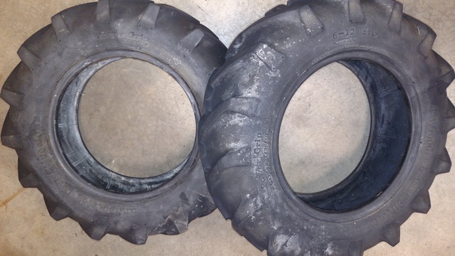

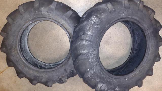

RedRanger 1,470 #1 Posted November 17, 2015 I've got a set of rims and original BFG luggers from the early 60's that I'm restoring.Rims are getting blasted and powder coated.The tires are pretty dry, faded, and have white stains from somebody splattering house paint on them decades ago.I plan to use Millers Tire Paint on them.Should I put the paint directly on the cleaned dry rubber or should/could I soak them in RuGlyde first.The RuGlyde will soften them up some, but will it have detrimental effect to the tire paint???? Share this post Link to post Share on other sites
shallowwatersailor 3,222 #2 Posted November 17, 2015 The RuGlyde shouldn't interfere with the Miller Tire Paint. But I'm not sure if it will be worth the effort as the paint will seal the tire. 1 Share this post Link to post Share on other sites

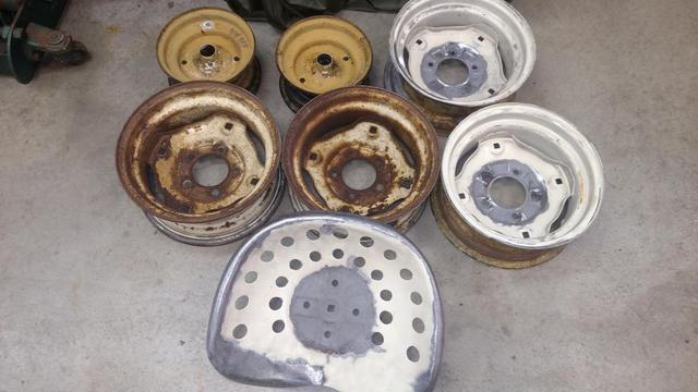

RedRanger 1,470 #12 Posted November 19, 2015 (edited) Ordered the paint and waiting. Here's a teaser for you.Rims are off at the powdercoater. Edited November 19, 2015 by RedRanger 4 Share this post Link to post Share on other sites

RedRanger 1,470 #16 Posted November 23, 2015 10 hours ago, Don1977 said: I agree with Richard that they don't look bad. I would try giving them a good cleaning first. I've used the Bleach-White it's good stuff. A couple of steel wool soap should remove the white paint. If they clean up then give them a good coat of Armor All. I tried steel wool as well as a wire brush and sandpaper. Tried all of these with lacquer thinner as well as paint thinner. That white stain is not coming off. Share this post Link to post Share on other sites
shallowwatersailor 3,222 #17 Posted November 23, 2015 The tire paint should cover the stain. You will be surprised at how well it covers following the directions on diluting it with water. 1 Share this post Link to post Share on other sites

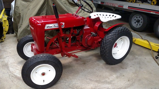

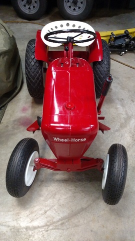

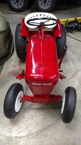

RedRanger 1,470 #19 Posted November 30, 2015 On 11/19/2015, 4:51:02, RedRanger said: Ordered the paint and waiting. Here's a teaser for you. Rims are off at the powdercoater. Well.....The parts are back from powder coat and my 401 has new shoes. Still waiting on the tire paint though. Seems they took my order and somebody forgot to ship it. Should be here this week. Love the way the front tires fit these suburbans. These wheels are actually the yellow and rusty ones above. 6 Share this post Link to post Share on other sites
AMC RULES 37,260 #20 Posted December 1, 2015 Tractor looks really great... what red paint did you end up using? 1 Share this post Link to post Share on other sites

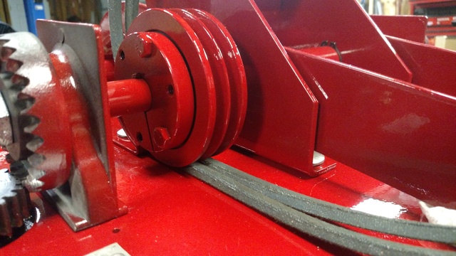

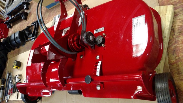

RedRanger 1,470 #21 Posted December 1, 2015 (edited) 14 minutes ago, AMC RULES said: Tractor looks really great... what red paint did you end up using? The 401 was painted by a previous owner about 7 or 8 years ago from what I know. I've traced it back that far. It's a rattle can job. Looks pretty good for what it is, except gas stains around the filler and a spot under the carb where the paint lifted from a carb bowl leak. Down the road I may strip it down and re-do it. The white bits are Antique White powder coat. The pictures make it look brighter than it really is. On my other project I'm using Dupont Nason urethane. Color is IH-50 International Harvester. As well as the deck for this tractor and the deck for my 867. That's another story... LOL Reassembly is a xxxxx. The deck double pulley was damaged and I didn't want to spend the money for the "correct" one so I found an aftermarket two piece pulley and assembled it. Didn't realize until this point in assembly that the pulley is 1/4" too tall. Double belts are pinched and won't turn. I'm currently waiting for UPS with a NOS double pulley so I can finish the deck and move on to the 401 deck. Please excuse the greasy finger prints, not quite photo-shoot ready. This is my 867 deck. It's a RM367 model. Edited December 1, 2015 by RedRanger 5 Share this post Link to post Share on other sites

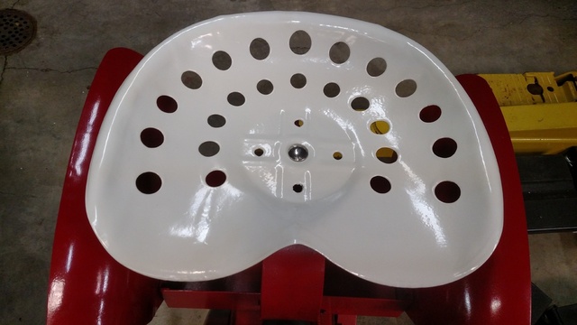

JPWH 6,544 #23 Posted December 1, 2015 Tractor and deck looks real nice. Did you powder coat the seat as well? Share this post Link to post Share on other sites
RedRanger 1,470 #24 Posted December 1, 2015 3 minutes ago, AMC RULES said: So nice... like candy. Thank you. It's fun. I've got the deck for the 401 half done as well as a deck for our Lawn Ranger on the bench. Once those are done, I can move on to the Lawn Ranger disassembly. Hope to make it show quality. 6 minutes ago, Hank01 said: Tractor and deck looks real nice. Did you powder coat the seat as well? Yes. Matches the wheels. Everything was blasted to bare metal. For some reason the seat kept bleeding through red, even though there was no paint or pigment on the metal anymore. Very strange. The coater had to redo the seat 3 times. Eventually they put a gray powdercoat primer on the seat and then the white so it would not bleed. Weird thing is the seat had no red paint on it??? Share this post Link to post Share on other sites
