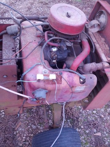

Mike_Eddleman 71 #1 Posted November 16, 2015 Started rewiring the tractor today and have a couple of questions, first what is the black thing in the picture? it sets beside the carb and looks like a vacuum hose going to the carb. Second their is a resister on the tractor that you can see in the picture. The coil that I got today looks like one off a car but it has two plug wires coming out of it does it need that resister? none of my others has one on them so I just don't know Share this post Link to post Share on other sites

520HC 208 #3 Posted November 17, 2015 It is not a Onan. It is a Kohler Share this post Link to post Share on other sites
ol550 864 #5 Posted November 17, 2015 (edited) That black thing is the governer housing. The hose is the crankcase vent. The resister need not be there, but may have been put there to get more life out of the points. Edited November 17, 2015 by ol550 1 Share this post Link to post Share on other sites
