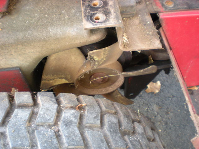

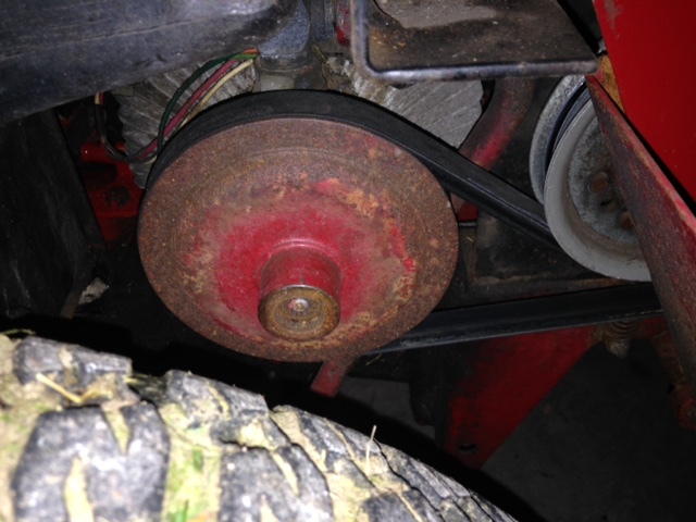

BigR 3 #11 Posted November 17, 2015 Thanks everyone for your helpful ideas. Last night I checked again and yep...the fan is gone. Unfortunately the bolt sheared off too. Time to get out the drill and easy outs!!I did notice that the input shaft for the hydro motor is recessed into the pulley about 3/4". Is that common or should I do some adjusting. The belt that is on the tractor is brand new so I can't tell if it is wearing unevenly. I did not pull off the side cover yet to expose the full drive belt. If the pulley needs to stay at that location on the shaft, should I consider "shimming" out to the edge of the pulley with a spacer or bushing? Or will the space behind the plastic fan be okay??Also, while I'm at it I'm going to change the fluids in the trans since I already have the filter. What is the capacity for this unit and is 10W-30 what most are using? (Sorry I'm being lazy, I'm sure I can dig it up online some where, but I figured someone on here would know right away)Thanks again for all the help!! Share this post Link to post Share on other sites

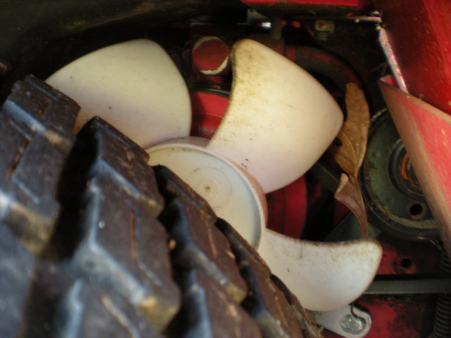

shallowwatersailor 3,222 #12 Posted November 17, 2015 Is the belt running true? The fan hub does have a recess, if nthat is what you are asking.Here are two pictures of what it should look like. The part number is #108393. The one is a clear view but on my 417-A that I have not done any work on since getting it earlier this year.. The other is the new fan on the C-145. Notice the direction of the blades on the C-145. Leaves get everywhere this time of season! Share this post Link to post Share on other sites
BigR 3 #13 Posted November 17, 2015 Thanks John!!The pictures really help. I now see the washer is like a fender washer that puts the pressure on the pulley OD not he ID of the pulley. From what I can tell the belt is running true. I just ordered the fan from my local Toro dealer and he said it should be in tomorrow. Hopefully this will take care of the overheating issue, but I hope the previous owner didn't do to much damage already. 1 Share this post Link to post Share on other sites
