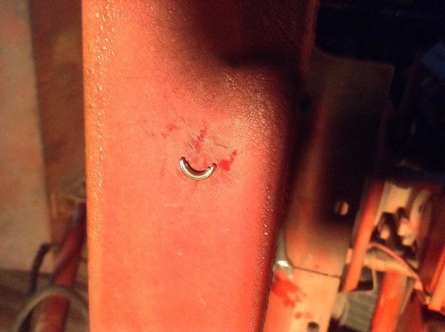

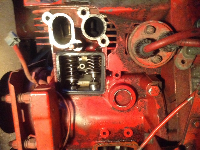

Sea-Duck51 55 #1 Posted November 15, 2015 I just got done putting the motor in after replacing Hydro seal,before the tear down it started bogging,black smoke,having fooled with the carb,it was sitting for some time thought it was probably bad float so rebuilt,new brass floats and when I fired it up had tremendous back pressure out of carb,long story short pulled plugs and no compression on one cylinder,after pulling intake/exhaust determined Intake Valve stuck open,pulled inspection covers and found this little piece of metal and appears valve keeper is bad,question is can I fix this without pulling the head,motor was a reman that PO had installed,supposedly low hours,what's the verdict?. Share this post Link to post Share on other sites
953 nut 66,608 #2 Posted November 15, 2015 Several years ago I made a little device that allowed me to change valve seals on an OHV engine without pulling the head. I took an old spark plug and knocked out the porcelain leaving only a metal sleeve and welded a male air fitting to it. Screwed it into the head and hooked up the air hose while compressing the spring tool. The air pressure holds the valve closed while you are working on it. This should allow you to insert a new keeper with the head in place.Hope this helps. 1 Share this post Link to post Share on other sites
Sea-Duck51 55 #3 Posted November 15, 2015 Great idea..after some research thinking it's the vale spring retainer washer and not the keepers,looks like the shoulder broke of allowing it to ride up on the valve stem,what really blows is going to be the SNOW,expecting 6-12" tomorrow and worked all day getting the horse back together,going to have to break out the shovel...ugh. Share this post Link to post Share on other sites
gwest_ca-(File Mod) 12,277 #4 Posted November 15, 2015 If you have a compression tester with a hose on it you may have everything in it you need. You would need to remove the valve core.Remove the valve keepers with air on the valve.Release the air and lift the valve to replace the retainer.Put the air back on, compress the spring and install the keepers.Hardest part is likely coming up with a retainer real quick.Garry 2 Share this post Link to post Share on other sites

Sea-Duck51 55 #7 Posted November 16, 2015 The mystery is solved i hope,was able to use a small rod to hold the vale shut through the spark plug hole and with a large screwdriver compress the spring,to my surprise there was only one keeper not two which explains why the retainer washer was damaged,this was a reman engine the PO found at a local small engine shop that was "rebuilt" ,well the valve must have been done on a Monday or Friday or possibly just before closing time,how does one forget one of the keepers?,looks like I'm going to pull the head if the valve stem is boogered up,ordered a spring compressor so we'll see. Share this post Link to post Share on other sites

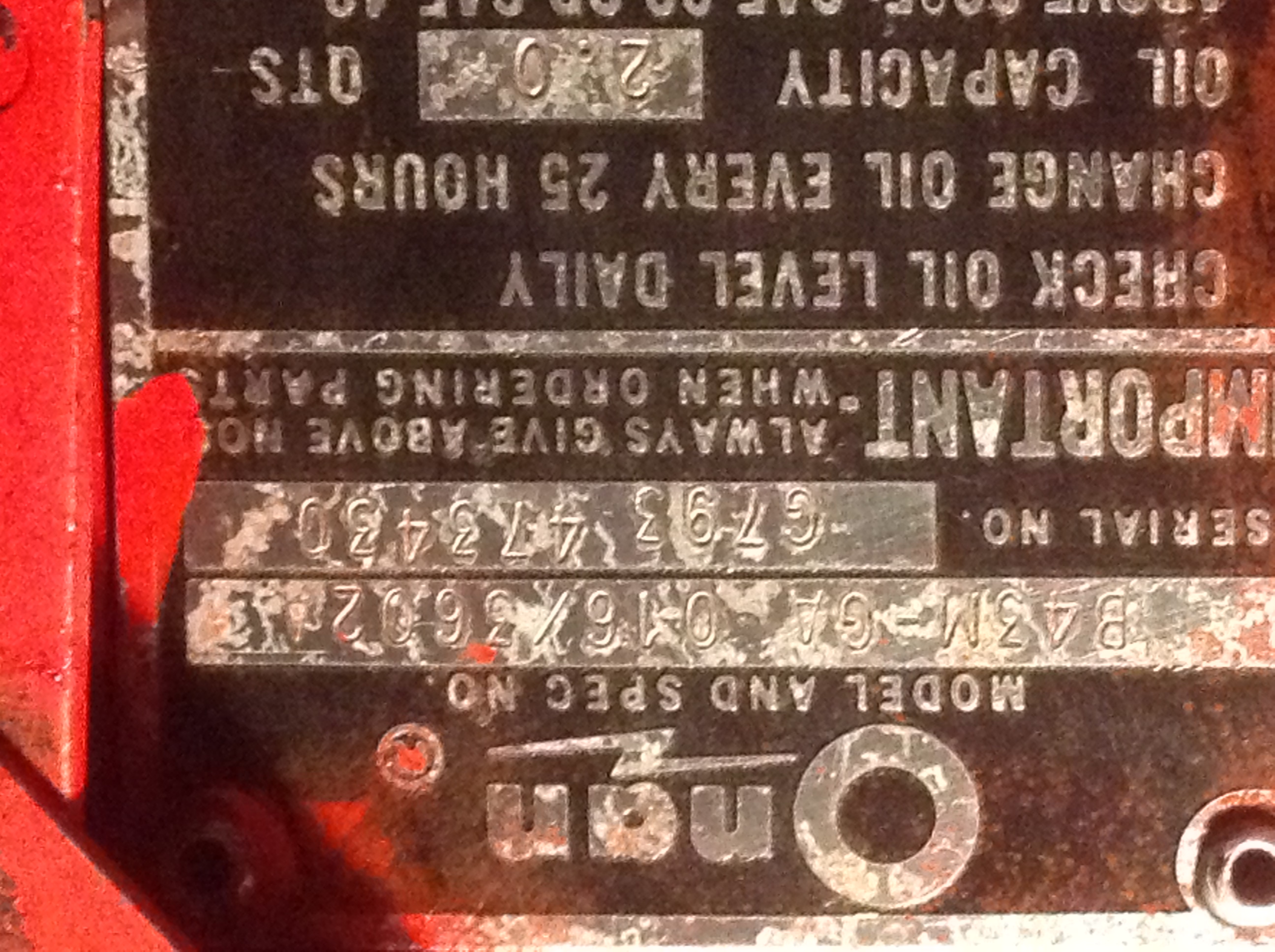

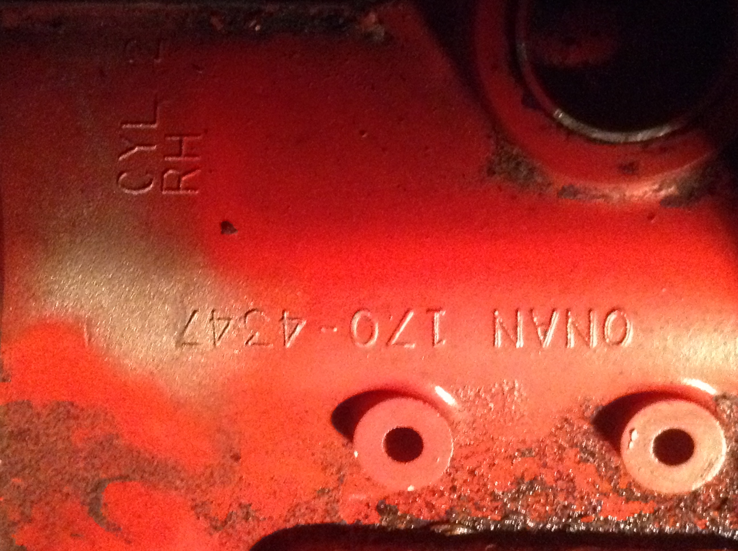

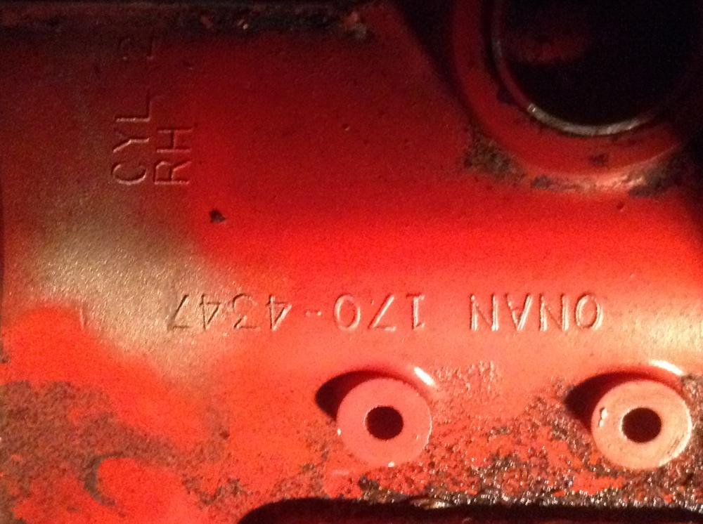

Sea-Duck51 55 #10 Posted November 17, 2015 This is what I know,only had the D160 W/FEL for several months,PO had it for over 20 years and when the original Onan went bad he was able to find this one at a local shop that had been sitting on the shelf for years,supposedly rebuilt?,judging by the condition of the LH Cylinder valves,springs only the RH was worked on or remaned.The exhaust valve has Two Keepers on it,thx for the offer but ordered new keepers,retaining washer,should be here by weeks end,attached a pic of I.D tag and block casting #. Share this post Link to post Share on other sites
boomers_influence 106 #11 Posted November 18, 2015 sea-duckthe cast # 170-4347 on the block, ( i have one in stock )confirmed that you have a P block,with B sheet metal and other parts.the valve parts are not inter changeable,UNLESS the valve guides were replacedwith B guides and related parts.B valve stems are 11/32. ( .343 )P valve stems are close to 9/32 ( act .280 )ALL onan twins use 2 keepers per valve.thank you. boomer 1 Share this post Link to post Share on other sites
Sea-Duck51 55 #12 Posted November 19, 2015 It sounds like I have a Heinz 57 motor,well the keepers and retainer are on the way,should be here next day or so,valves springs,keepers and all look different from LH Cylinder so I'm hoping your right and they changed it,thanks so much for the info and if the parts don't work I will defiantly get back with. Share this post Link to post Share on other sites
Sea-Duck51 55 #13 Posted November 19, 2015 sea-duckthe cast # 170-4347 on the block, ( i have one in stock )confirmed that you have a P block,with B sheet metal and other parts.the valve parts are not inter changeable,UNLESS the valve guides were replacedwith B guides and related parts.B valve stems are 11/32. ( .343 )P valve stems are close to 9/32 ( act .280 )ALL onan twins use 2 keepers per valve.thank you. boomer So if the ones I ordered for a B43 don't fit are these the ones I need for a P series block?110-3487 Retainer Washer110-3511 KeepersThx. Share this post Link to post Share on other sites
boomers_influence 106 #14 Posted November 20, 2015 sea-duckyes those part # are correctfor a P engine. ( small block )thank you. boomer 1 Share this post Link to post Share on other sites
Sea-Duck51 55 #15 Posted November 21, 2015 sea-duckyes those part # are correctfor a P engine. ( small block )thank you. boomer you are correct,received the parts today and they are much bigger so ordered the correct ones,also the mystery is solved,piece of metal I found is the top ring of keeper,rest is fused to the retainer washer,valve looks to be o.k so will sit back and wait for new parts,if anyone needs 2 keepers and retainer washer for B43 PM me and there yours,don't have any use for them. Share this post Link to post Share on other sites
