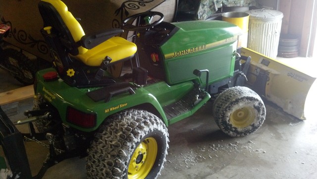

RedRanger 1,470 #9 Posted November 17, 2015 (edited) I run the Carlisle version on my Deere. Love them. Great traction without tearing up the lawn. Stick like suction cups in the snow. For an all around tire, they're perfect. 26x12-12Please excuse the Green boys. Edited November 17, 2015 by RedRanger Share this post Link to post Share on other sites
