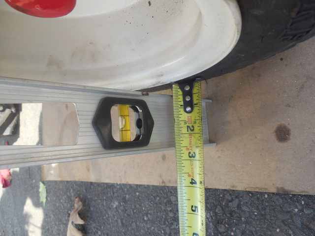

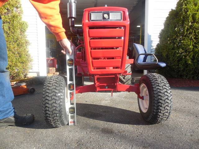

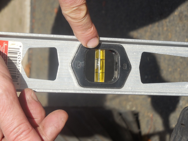

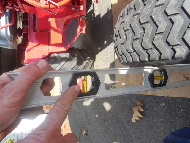

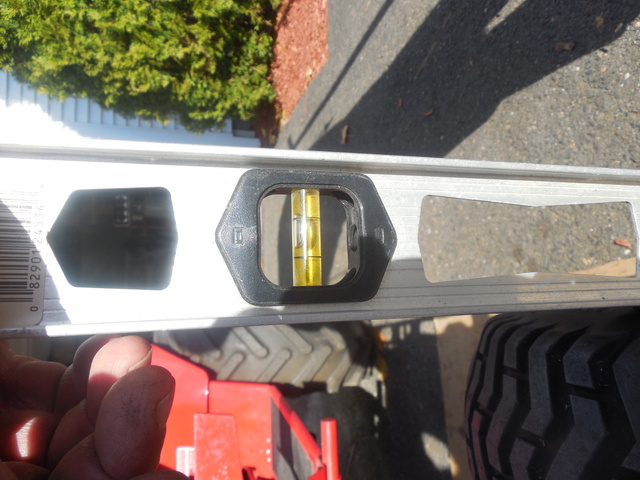

mrc 1,122 #11 Posted November 15, 2015 o.k. guys here is the pics. pic #1 and 2 are the left front wheel (as you sit on tractor) my finger is pointing to the bubble in the level. pics #3,4 and 5 are the right front wheel. the right front as you can see is about 1/2 inch out of plumb. Whats up with that? any help is greatly appreciated thank you mike in mass. Share this post Link to post Share on other sites

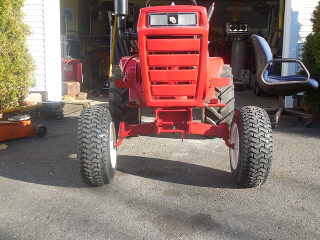

Racinbob 13,286 #12 Posted November 15, 2015 Can you post a picture from the front taking in both wheels. If it was excessive wear It should be tipped the other way. But nothing really makes sense since you've swapped everything. Share this post Link to post Share on other sites
stevasaurus 23,884 #13 Posted November 15, 2015 (edited) Can you put up a few picks looking at the front end from different angles. All those pictures show is that one wheel is out 1/2". We need to see if we can spot the issue. Bob and I posted at the same time...Great Minds Think Alike. Edited November 15, 2015 by stevasaurus Share this post Link to post Share on other sites

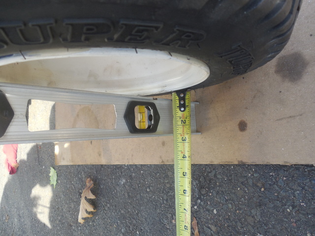

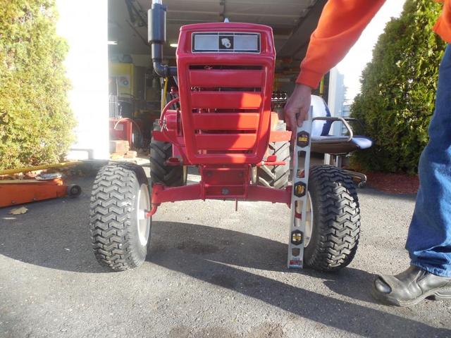

mrc 1,122 #15 Posted November 17, 2015 hi guys here are more pics. hopefully first pic you can see right wheel (as you sit on tractor) the lower edge is canted inwards. second pic if you look closely the top of the wheel to get the level bubble in the middle of the scale, there is a 1/2 inch gap. third pic is the left front wheel, the level bubble is in the middle of the scale and the level is tight both top and bottom to the wheel. any thoughts or help is greatly appreciated. thank you mike in mass. 1 Share this post Link to post Share on other sites
C-101plowerpower 1,606 #16 Posted November 17, 2015 it almost looks like the axle is bend Share this post Link to post Share on other sites
Racinbob 13,286 #17 Posted November 17, 2015 Koen, I've been looking at that myself thinking maybe....maybe not..... but it may be an optical illusion. Besides, he swapped the axle out per the first post. 1 Share this post Link to post Share on other sites
rmaynard 17,644 #18 Posted November 17, 2015 Considering the fact that it is extremely difficult to bend the cast front axle, and if the bore in the axle is not worn, then the only answer is bent spindles. Sent from my MotoG3 using Tapatalk 2 Share this post Link to post Share on other sites
Racinbob 13,286 #19 Posted November 17, 2015 I agree Bob. What I was seeing was the front axle pivoted a bit but I think the shadows are making it look that was. What's goofy is that everything has been swapped out. Share this post Link to post Share on other sites
PaulC 342 #20 Posted November 17, 2015 Mike I have a 417-a that has the same issue and its even on the same wheel . I don't think its quite as bad as yours but I haven't done any measuring like you have so maybe it is. The only thing I thought it could be was the spindle but I know you have changed all parts to rule that and many other things out.Going with my and Bob's thinking on the spindle have you tried just temporarily to switch the left spindle with the right? Obviously the tie rod connection would be sticking out the front of the tractor but that would be the for sure way to tell if it is the spindle or not. The chances of you swapping another bent spindle onto the machine sounds highly unlikely but I guess it is possible?If all else fails you could just bend that spindle to the position of your liking and move onto the next project 1 Share this post Link to post Share on other sites
TDF5G 2,074 #21 Posted November 17, 2015 (edited) That is really strange. I've been following this thread, thinking someone would come up with a reason for it. I'm no expert, for sure, but everything looks really square and straight to me in the pics taken from the front, but I notice that you can see the right tie rod but not the left. It may just be the angle in which the pictures were taken.I'd have to go with the bent spindle theory. I realize you've swapped spindles and axles and i'ts still out of align. I reckon if you hit something hard enough it would bend a spindle, but after replacing it and the camber still being way off like that, I don't have a clue. It's just weird.I'm gonna have to look at my tractors now. P.S. I just keep studying the pics. In the first pic (the recent ones taken of the front) you can see the difference in the distance from the top of the wheel to the spindle portion of the axle. The pic appears to be taken from the exact center of the tractor if you compare the pedals, wheels, etc. I'm stumped.P.S.S. Compare the top of the axle on each side with the lower portion of the rear wheels. It's exactly the same on each side, I just noticed. I don't believe the axle is bent. It appears exactly symmetrical to me. It must be the spindle/s messed up. I don't know, I give up! Edited November 17, 2015 by TDF5G 1 Share this post Link to post Share on other sites
Don1977 606 #22 Posted November 17, 2015 It's not off enough to worry about. If you look at large farm tractor most have positive camber. So it's the other side that off.Have you replaced the wheel bearings that could be the problem. Share this post Link to post Share on other sites
Tankman 3,528 #23 Posted November 17, 2015 (edited) it almost looks like the axle is bend Doubt a bent axle, cast iron.Still hard to visualize but, if you must, remove spindle and adjust the bend with a 5-lb'er. Slowly match the pair while they're out of the cast axle; tap tap, tap tap.A steel worker for many years. "We're not making watches." Edited November 17, 2015 by Tankman 2 Share this post Link to post Share on other sites
squonk 48,326 #24 Posted November 17, 2015 It will steer better with a little camber in it. I wouldn't worry about it unless you're planning on hot rodding it so it will go 50 and then driving it across the country! 3 Share this post Link to post Share on other sites
953 nut 70,330 #25 Posted November 17, 2015 NASCAR cars always run a lot of right side camber for better high speed cornering. 7 Share this post Link to post Share on other sites
