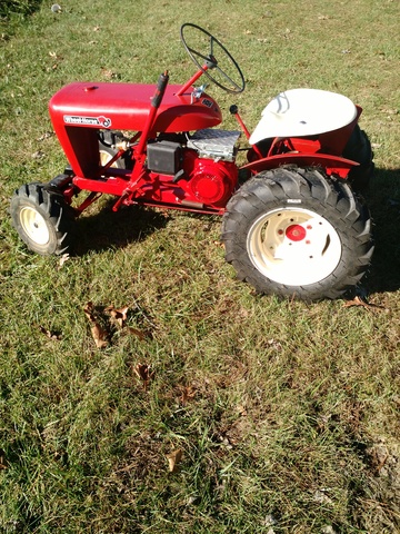

gtofani 36 #1 Posted November 13, 2015 Hi all,My wheels were white in the front and red in the back, probably painted at some point in their travels.I have a 1967 Lawn Ranger, I am guessing they were supposed to be white but I like the Almond color I have seen on some tractors.I have been told that both colors were used.I went with an all black seat cover so I am guessing the almond wheels would look better than white on it.Does anyone have a product number for the almond paint or should I just ask for Almond?I bought a gallon of IH Red at tractor supply for the rest.thanks Share this post Link to post Share on other sites

gtofani 36 #3 Posted November 13, 2015 So your saying IH cream is a good color to use, and I did buy the hardener also.I am worried that the paint on the wheels will get messed up putting on the new tires.Should I put the new tires on first then mask them off to paint the wheels. Share this post Link to post Share on other sites

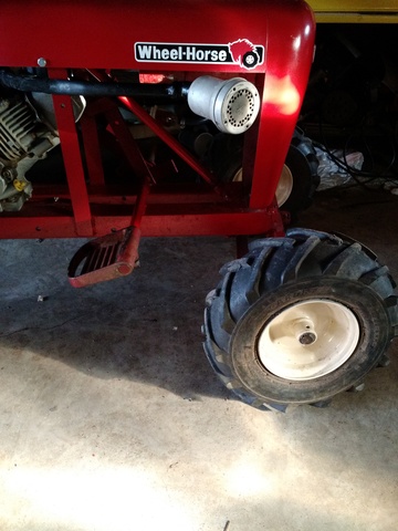

quahog 14 #4 Posted November 13, 2015 I just redid my wheels and used Chrysler Cool Vanilla Its a current offering so mix is avaiable single stage from paint suppliers. I broke down the tires and the Orig color was a cream very similar. I added dust covers to the front hub / spindles .They are rubber boots for table legs, a big $ 1.50 investment.. The body will be sprayed w/ single stage red / Volvo . I plan to add some flattening agent to tone down the in your face red. Quahog 1 Share this post Link to post Share on other sites
tractorhogg 656 #5 Posted November 13, 2015 So your saying IH cream is a good color to use, and I did buy the hardener also.I am worried that the paint on the wheels will get messed up putting on the new tires.Should I put the new tires on first then mask them off to paint the wheels. I think the Rustoleum is a closer match to the Wheel Horse almond, The IH is quite a bit darker. If you use the right amount of thinner and hardener most good tire shops will not mess up the paint. 1 Share this post Link to post Share on other sites
quahog 14 #6 Posted November 13, 2015 Prep rims and add tires but do NOT inflate keeping them below the bead. I cut some manilla folders into half circles and slid under the trim. Keeps overspray off your new treads . Clean rims well as new rubber will contaminate them and create paint issues. 1 Share this post Link to post Share on other sites

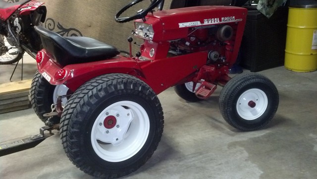

Brian01 481 #7 Posted November 13, 2015 I used Antique White by Plasti - Kote on my RJ58.....I'll let you be the judge... 3 Share this post Link to post Share on other sites
gtofani 36 #8 Posted November 13, 2015 Nice, The off white looks cool also.Makes my decision a little tougher, white, off white and almond. Share this post Link to post Share on other sites

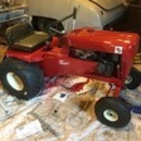

RedRanger 1,470 #10 Posted November 13, 2015 (edited) Antique White or Linen White is the best match. Almond is a bit dark/creamy.The attached picture is Antique White powder coat. It matched the factory paint on the inside of the rim almost perfectly.If you install your tires from the backside of the rims, you'll have no scratches on the front of the rims, and if careful, nothing on the backside either. Any little knick on the backside can then be touched up.Lube the beads and rims before you mount them.If mounting by hand, lay a towel or old blanket down to keep from scratching the wheels too.If you use a good paint hardner, you should also have no issue with nicks.If you have a professional tire shop mount them, there should also be no scratches.I don't like painting wheels with tires on because the inside doesn't get sealed up, unless you're going to dismount, paint inside of rim, remount, tape off and then paint the front and back. Too much work. Edited November 13, 2015 by RedRanger 2 Share this post Link to post Share on other sites
