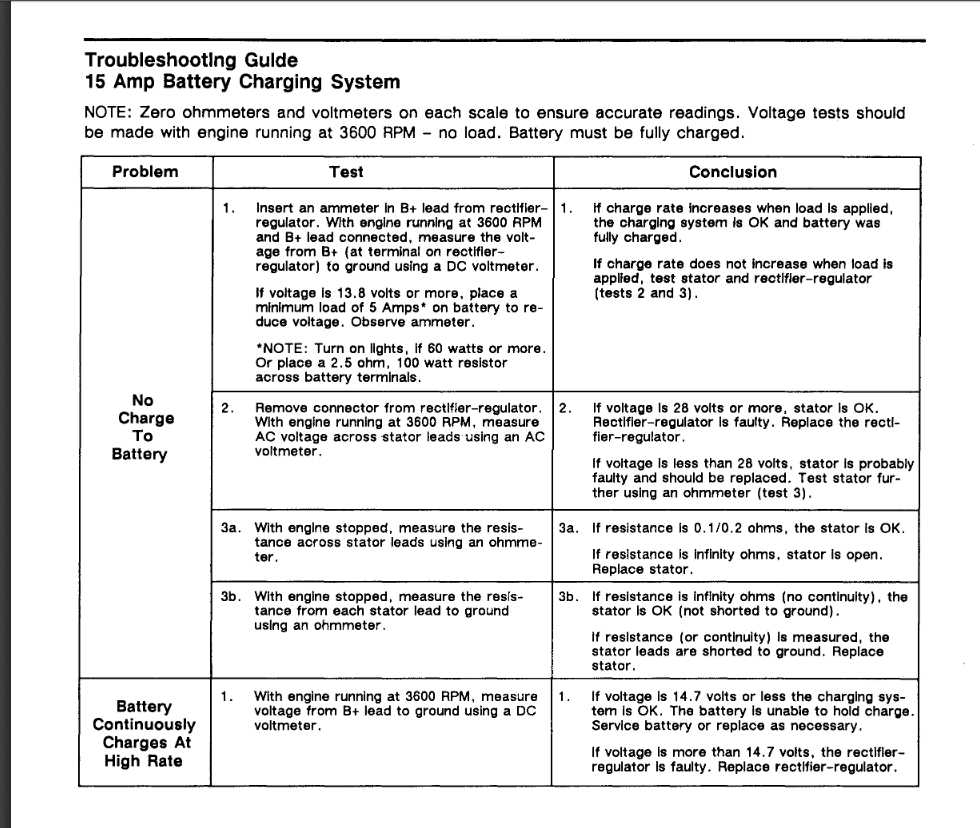

Wishin4a416 2,597 #1 Posted November 13, 2015 What should the Multimeter reading be on a good Kohler stator? I am electrically challenged so be easy on me now. 1 Share this post Link to post Share on other sites
rmaynard 17,409 #2 Posted November 13, 2015 (edited) Here is the page from the Kohler manual on how to test a stator. Edited November 13, 2015 by rmaynard Share this post Link to post Share on other sites
Wishin4a416 2,597 #3 Posted November 13, 2015 Oops. Thanks Bob but my mistake already. I dont have Stator in hand. I am going to buy one, probably on ebay, a 15 amper. To upgrade the 14 horse I am rebuilding and I see some folks show a resistance reading and was wondering what a good reading is. Share this post Link to post Share on other sites
rmaynard 17,409 #4 Posted November 13, 2015 0.1 to 0.2 ohms. It's very low. As long as it's not open or a direct short, it should be okay. What kind of readings are they claiming? Share this post Link to post Share on other sites
