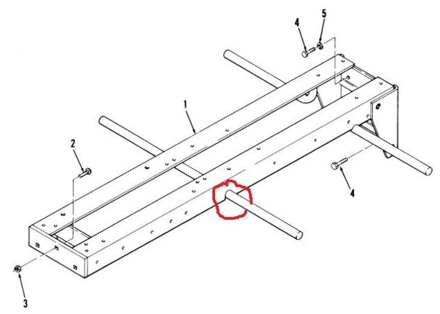

stevasaurus 23,861 #4 Posted November 12, 2015 (edited) Here is what the 310-8 frame looks like..here is the 77 B-60...can't seem to copy the B-60 frame. Anyway, it looks exactly the same except for the 2 back bars for the running boards. I think they are going to be the same length and everything. Like was said, it is an easy fix. Here is the link to the B-80...frame is on like page 5. http://www.wheelhorseforum.com/files/file/1030-tractor-1977-b-60-b-80-b-100-8-speed-iplpdf/ Edited November 12, 2015 by stevasaurus Share this post Link to post Share on other sites

fast88pu 3,402 #9 Posted November 13, 2015 The b series frame is missing the rear bar to go under the 300 series and you would also have to remove the belt guard tabs on the b series frame too. I put a 414 frame under a B100 because of frame rot on the b100. It was pretty simple. I also have a bent 300 series frame if your interested and local. Pm me Share this post Link to post Share on other sites

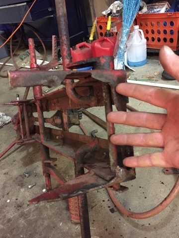

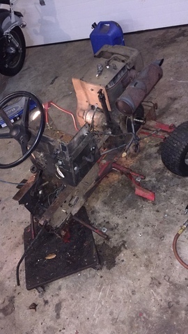

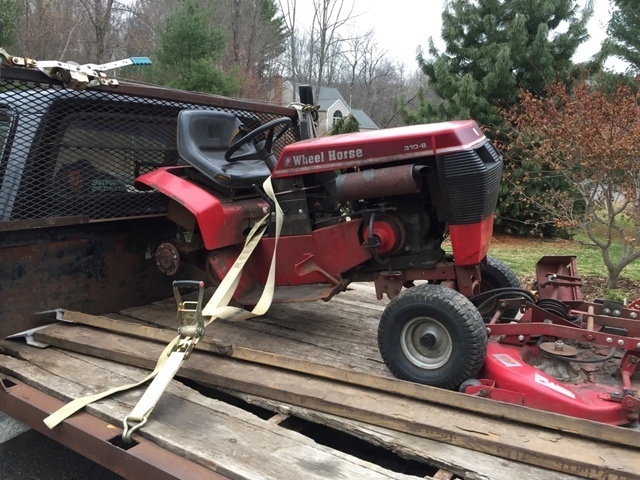

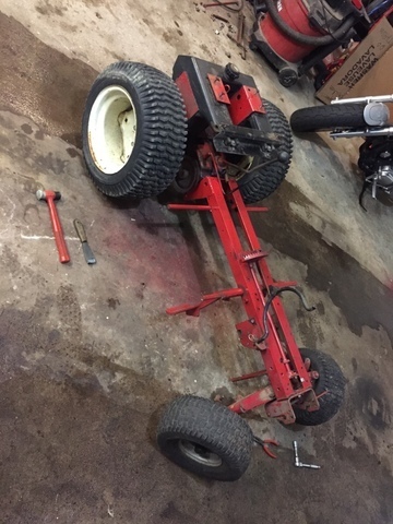

mikeeyre74 290 #15 Posted January 1, 2016 (edited) I can't. I have no room to upload them! how's that? That's her.. broken in half on the trip home. Some broken bits.. Here we're tearing it down... Edited January 1, 2016 by mikeeyre74 1 Share this post Link to post Share on other sites

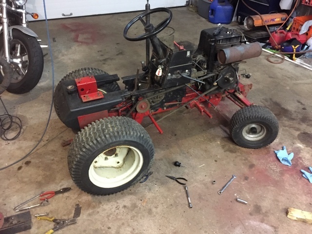

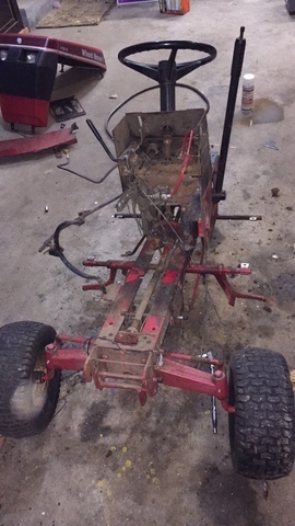

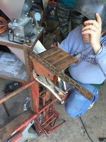

mikeeyre74 290 #16 Posted January 1, 2016 Here's the broken frame, where the transaxle tore it off.. Here's some welding action! Starting to go back together now... Getting closer... 2 Share this post Link to post Share on other sites
DennisThornton 4,773 #17 Posted January 1, 2016 16 minutes ago, mikeeyre74 said: I can't. I have no room to upload them! how's that? That's her.. broken in half on the trip home. Some broken bits.. Here we're tearing it down... Mike, you did a great job of documenting this project. I'd like to save all these photos and the rest to follow myself for future reference. There will be many others that will now or later appreciate them. You saved a broken Wheel Horse and gave it a new life! This will solve your upload issues: http://www.wheelhorseforum.com/store/category/1-redsquare-support/ BTW, what's the gear driven hopper in the "Here's some welding action! " photo? That must have been a lot of snowbank pushing (pounding!) to have done that to the frame! Any signs of a seat belt or harness? Bent steering wheel? 1 Share this post Link to post Share on other sites
