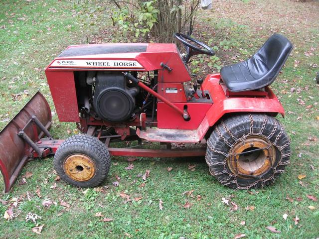

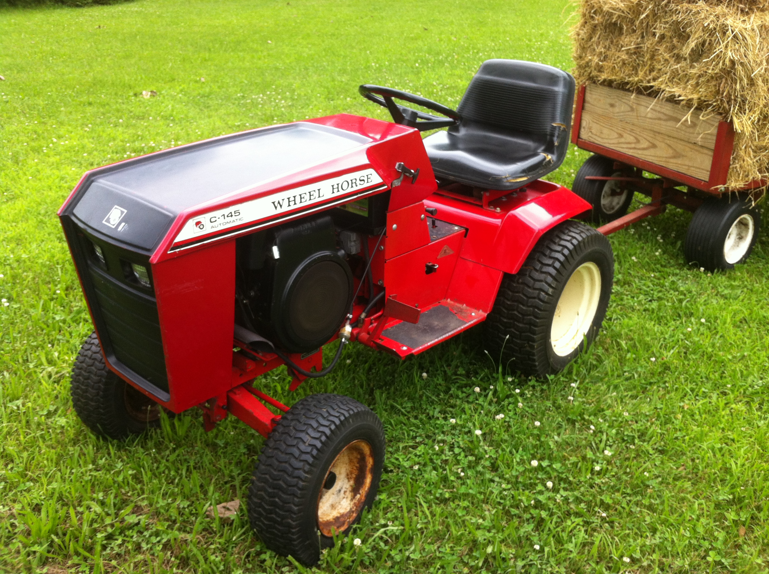

arrkerr 54 #1 Posted November 11, 2015 I picked up a C-145 auto that has a very badly broken fender. It obviously doesn't affect the performance, but I want it to look right. I've never been a big fan of the huge lip around the back that makes filling the tank a lot more difficult than it should be. I'm thinking about picking up either a fender from something like a 3xx, or maybe even a metal one from the x-xx1 series (vs the 5). Does anyone have any experience doing this, and which might fit? Suggestions welcome! Share this post Link to post Share on other sites
AMC RULES 37,260 #2 Posted November 11, 2015 Swapped mine here... the 3, 4, 5 series pans will fit perfectly in place of the plastic version you have now. 5 Share this post Link to post Share on other sites
Bert 805 #3 Posted November 11, 2015 I believe both that you mention will bolt right on. If you want a metal one from a 520 Ive got one you can have, just cover shipping.PM me if interested 4 Share this post Link to post Share on other sites
can whlvr 994 #4 Posted November 12, 2015 the 3,4,5 hundred series,and I do believe the c-xx1 will fit and look WAY better than the plastic one,imo Share this post Link to post Share on other sites

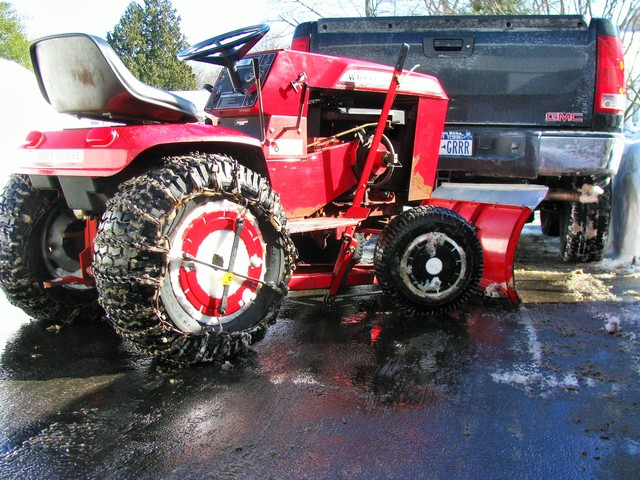

N3PUY 1,031 #6 Posted November 12, 2015 I bumped too many trees with mine. This metal one is off a 310-8. Share this post Link to post Share on other sites
MalMac 1,337 #7 Posted November 12, 2015 (edited) Not 100% sure on this, but I think even Wheel Horse changed them to metal in the last months of the Blackhoods production. Here's mine with a pan off a 520. Edited November 12, 2015 by MalMac 3 Share this post Link to post Share on other sites
shallowwatersailor 3,222 #8 Posted November 13, 2015 (edited) Somewhere in 1982-1983 Wheel Horse started building with the metal seat pan that was used on the Work Horse. You can tell an original metal pan because it does not have the bottom lip as on the 1985 and later 300/400/500 series. This is my '83 C-105. Edited November 13, 2015 by shallowwatersailor 2 Share this post Link to post Share on other sites

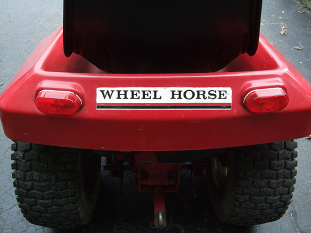

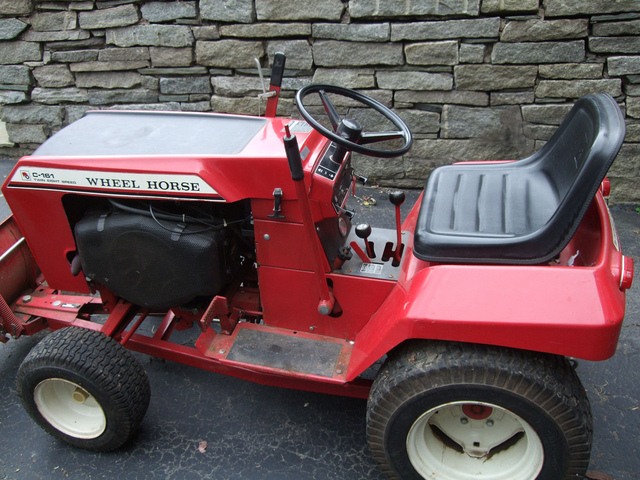

JackC 619 #12 Posted November 13, 2015 Plastic hood and plastic fender on my 1979 C-161 Black Hood.The initial production plastic fenders were much thicker and stronger than the later ones. 3 Share this post Link to post Share on other sites
