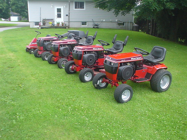

Tankman 3,528 #13 Posted November 18, 2015 (edited) Few years ago picked up a '90 520-8 (very cheap!)Was apprehensive "Onan", I like the older Kohlers. Now, changed my mind, love this Onan. Did a lot of easy stuff; carb clean, fuel lines, oil, filters, cleaned fins, painted shields, more, all normal routine PM (preventative maintenance).New decals from Terry, Horse logo for the air screen and steering wheel. I'm a bit allergic to TORO. Edited November 18, 2015 by Tankman 2 Share this post Link to post Share on other sites
cleat 9,405 #14 Posted November 18, 2015 I have also come to like the Onan's and sold my Ford with the Kohler.Like Tankman, when I refurbished my 520's I got rid of all Toro names.The 416 in the background still says Toro because it is original still.Cleat 2 Share this post Link to post Share on other sites
cleat 9,405 #15 Posted November 18, 2015 (edited) I have also come to like the Onan's and sold my Ford with the Kohler.Like Tankman, when I refurbished my 520's I got rid of all Toro names.The 416 in the background says Toro because it is original still.Cleat Edited November 18, 2015 by cleat 1 Share this post Link to post Share on other sites

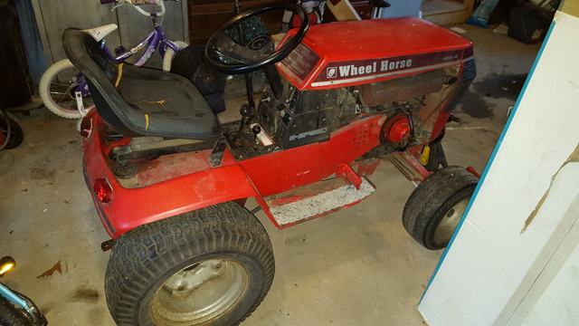

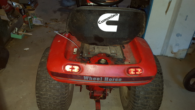

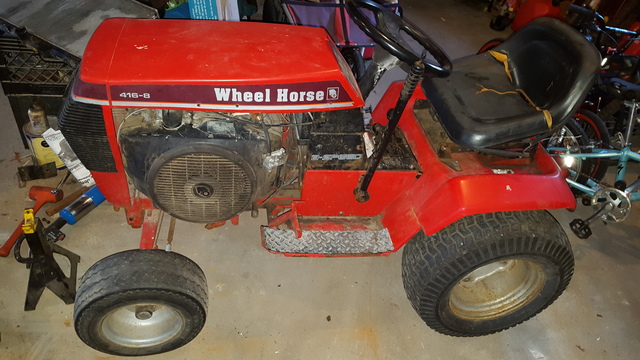

MotorsargeT 22 #16 Posted November 18, 2015 Pics as requested! It has spark, compression and fuel in the fuel filter so I'm pretty sure its carb related. The fuel looks horrible so I'm going to collect up some fuel lines, filter and a carb rebuild kit. If I can get it to fire I plan on pulling the tins and painting them, adjusting the valves, and doing the head gaskets as insurance. I have a nice set of deestone ags I acquired so they'll probably end up on it. Hopefully I can get it running and move forward! I ended up paying $200 for it and it came with a 42 inch side discharge deck, mule drive and plow brackets. The deck has a hole but I'm pretty handy with a welder and metal fab so I think I may have a nice garden tractor for the spring. I'll keep my 312 for mowing grass. 5 Share this post Link to post Share on other sites

953 nut 70,330 #19 Posted November 19, 2015 The goodies that came with it were worth $200, well done. 1 Share this post Link to post Share on other sites
cleat 9,405 #20 Posted November 19, 2015 (edited) Don't worry about a carb kit. Just take the top off, you can then clean the main jet and unscrew and clean the brass tube and clean out all the little holes in it.I have also found that pulling out the idle mixture screw (after seating it and counting the turns to put it back in correctly) and cleaning it then spray carb cleaner into the hole where you removed it then putting it back really helped mine.Whole job takes under an hour. Edited November 19, 2015 by cleat 1 Share this post Link to post Share on other sites

MotorsargeT 22 #24 Posted November 22, 2015 I pulled the top of the carb off as suggested and cleaned everything as best possible. It is varnished really bad and the needle on the floats is pretty bad. After draining the gas and adding a fresh gallon and putting it all back together it is running. Poorly, but running and not knocking. I pulled the carb and muffler today and will pull all the tins off the engine and clean everything up. I may have saved this one. 3 Share this post Link to post Share on other sites
