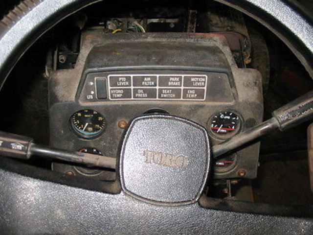

HokieAg07 129 #1 Posted November 9, 2015 Terry, would it be possible to reproduce the overlay for the idiot lights on the top of the dash on the 520 tractors? 2 Share this post Link to post Share on other sites

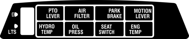

Kurt-NEPA 756 #4 Posted April 3, 2016 I tried the red one from Toro, but the location for each light was wrong for my 88 520H.. So I cheated. I scanned in the red one. Opened it in Photoshop and changed the red to black, then moved the text to where it should be. Then printed it with an Ink Jet printer on transparency paper and cut it out.. I put white PVC tape on the back and glued it the dash. Its not a perfect solution, but its better than nothing and has been working well for 2 years now. I hope Terry responds and is able to make them. 3 Share this post Link to post Share on other sites

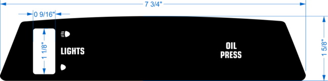

cleat 9,284 #8 Posted May 22, 2016 I will scan one for the 520-HC (or 516) and send it to you as well to have on file. Share this post Link to post Share on other sites

cleat 9,284 #10 Posted May 23, 2016 Hi Terry; I sent you the pictures and dimensions. Share this post Link to post Share on other sites

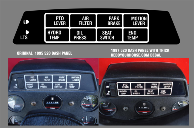

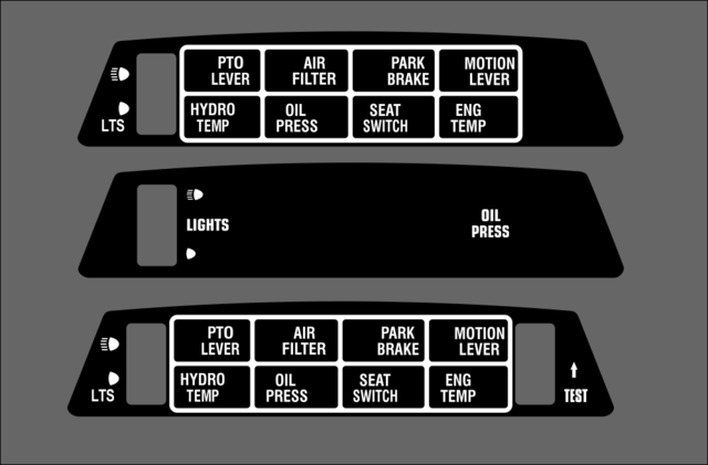

Vinylguy 4,796 #11 Posted July 30, 2016 I finally got back to this project and have a test decal for the panels shown below. I have made a thick test decal with 2 layers of laminate to make them thicker. 3 Share this post Link to post Share on other sites

Vinylguy 4,796 #13 Posted July 30, 2016 4 hours ago, cleat said: They look great, I may get one of each added to my next order just to have here as spares. Not sure how they will work as the originals are applied over a thin clear adhesive backed plastic film for rigidity over the bulb area? 3 Share this post Link to post Share on other sites
cleat 9,284 #14 Posted July 30, 2016 They seem to be a very dark burgundy plastic film that red light shines through. Cleat Share this post Link to post Share on other sites

Vinylguy 4,796 #16 Posted August 16, 2016 http://www.redoyourhorse.com/520-warning-light-panel-decal-design-1/ Here is a picture of the test decal on. He said the light shows up just not quite as bright as the original. Will be finishing up a couple other layouts soon and listing 5 1 Share this post Link to post Share on other sites

JERSEYHAWG / Glenn 4,589 #19 Posted October 1, 2016 Hey Terry, do you think you can do one for a 520-8? They are different. Glenn Share this post Link to post Share on other sites
